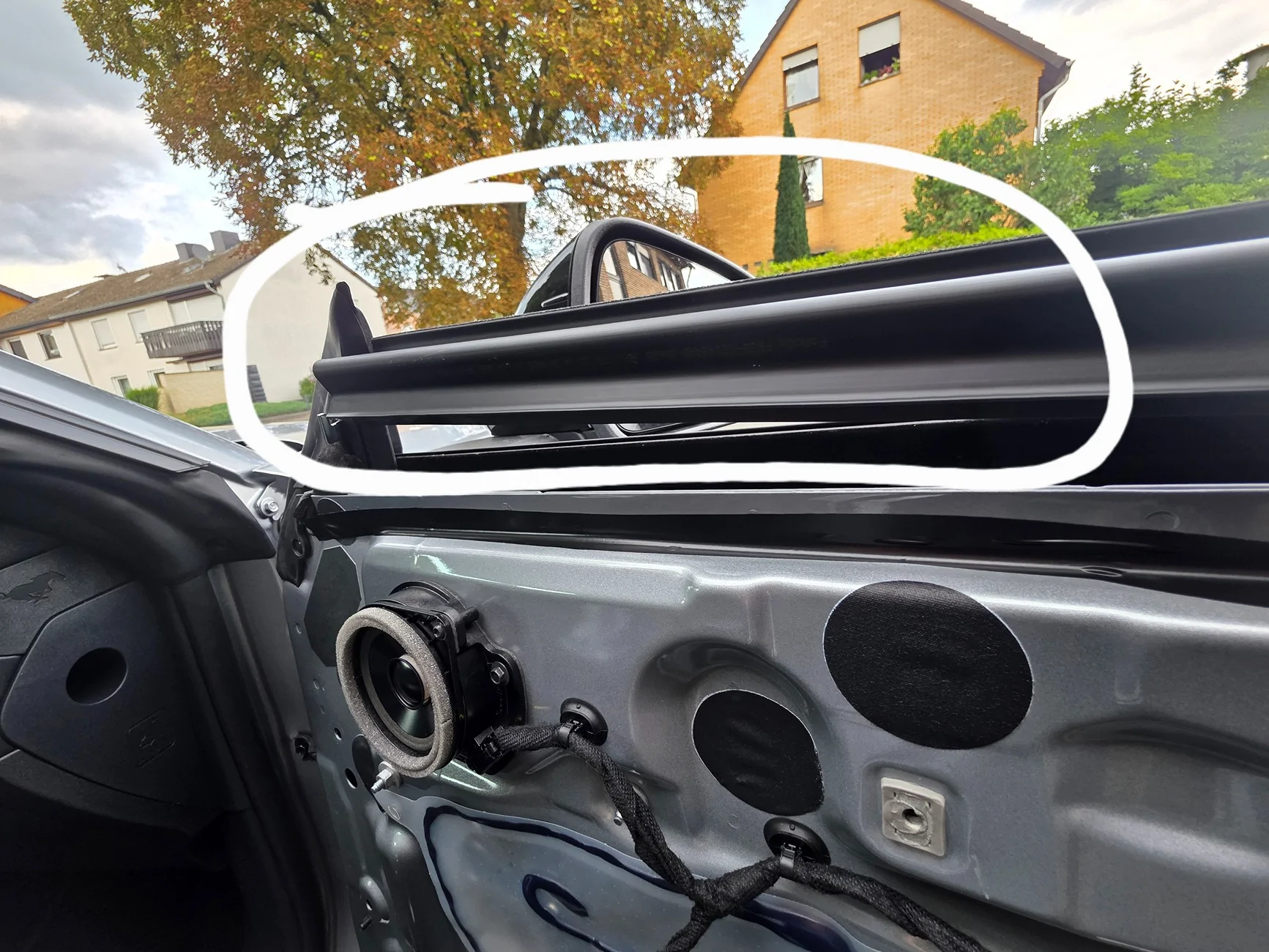

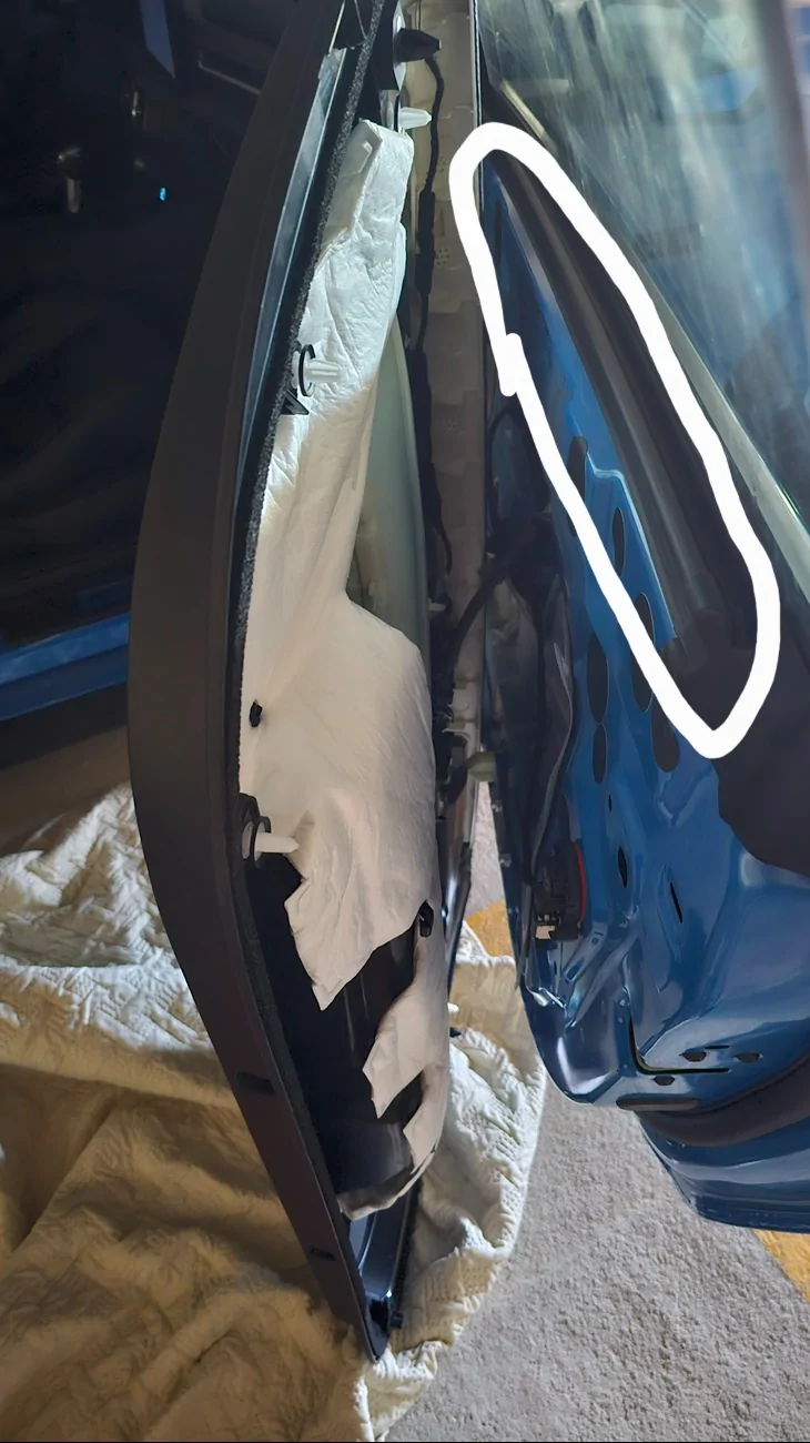

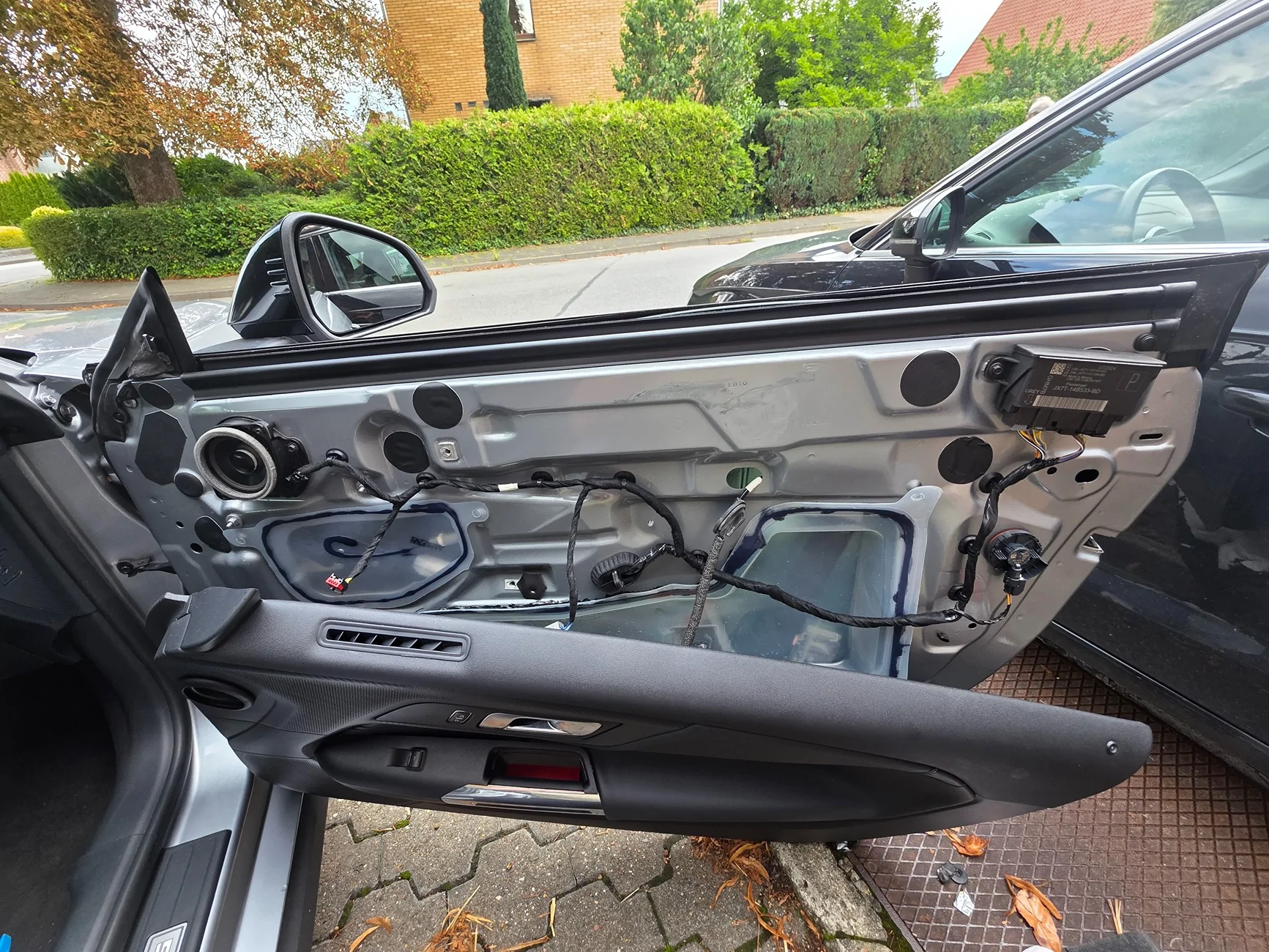

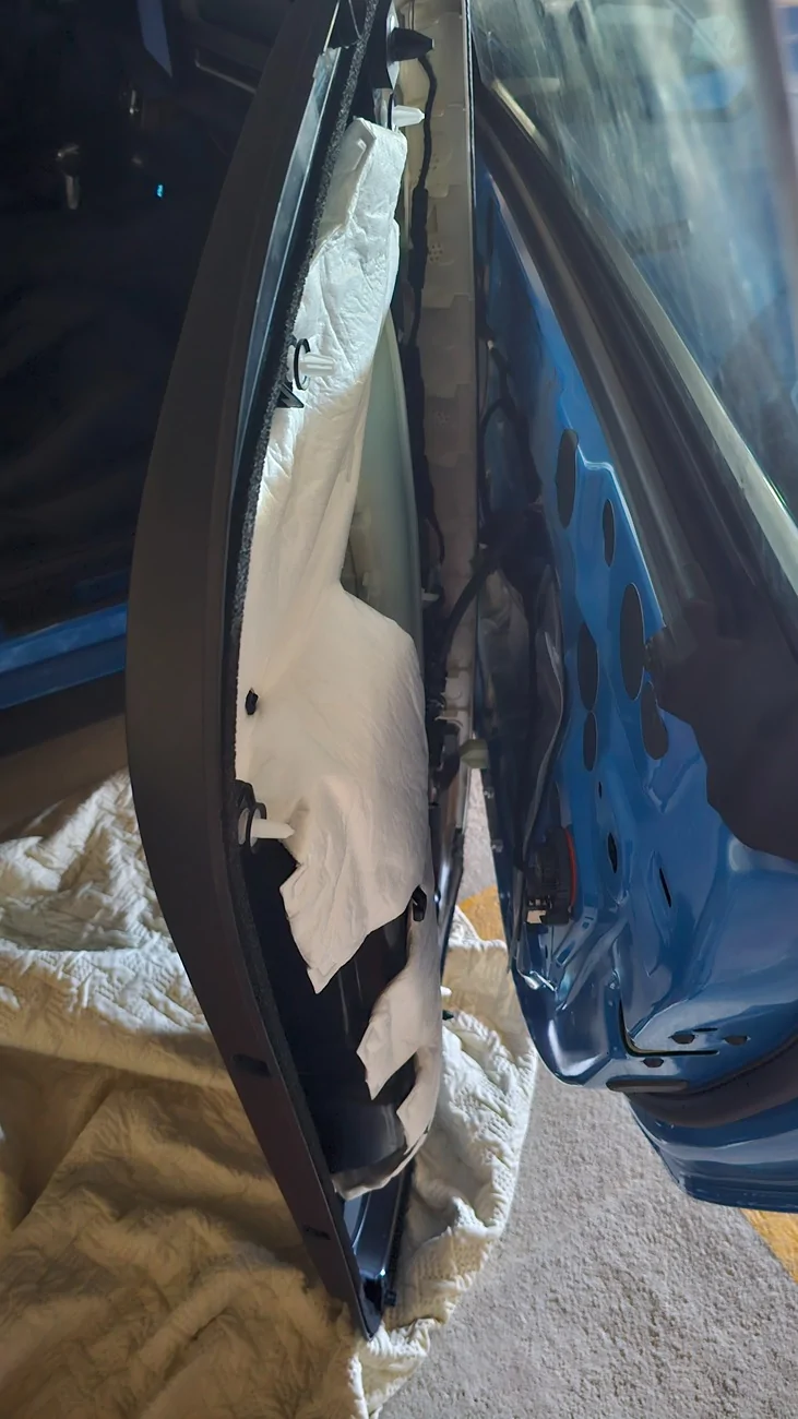

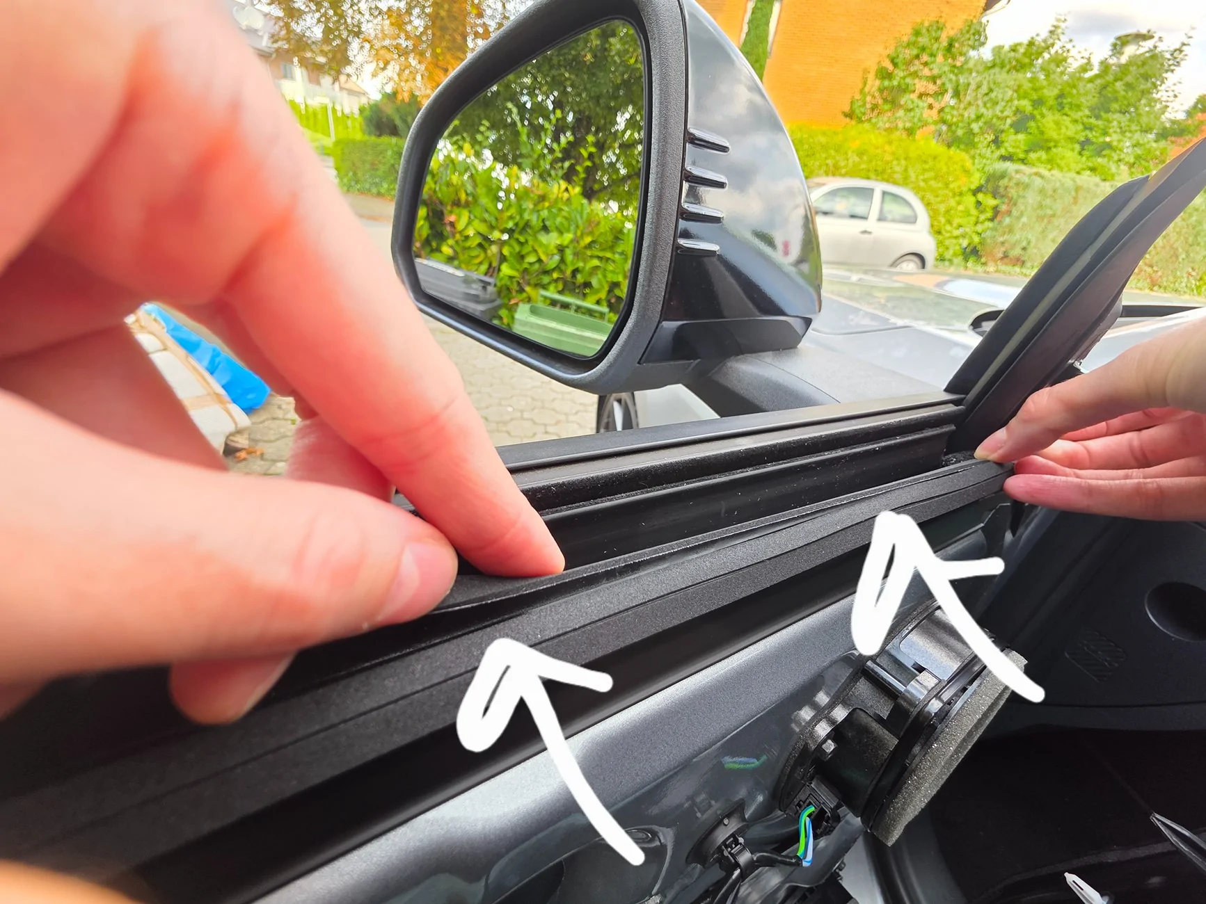

rustling was heard in both doors. I did not put up with it and conducted an analysis to find the source of the sound. The source was found - it is a plastic insert on which the door card hangs. It is put on the metal frame of the door itself and dangles. The frame was covered with a thin rubber band and the plastic no longer dangles. Plus, my wife and I also glued rubber strips on top of the insert itself, on which the door card itself lies. Now both doors do not make a sound.

Nice to see the inside of your door. Always wondered how it looked like since I don't have the door modules.
I guess it's the large black box on the top corner of the door. Mine doesn't have that thing.
S650 Mustang Door card rattle - FIXED 20250328_125240
this black thing

Does the window in the 3rd picture go down any further? On one of my doors, the window stops at that position, but the other window goes down further, such that you cannot see even a sliver of glass when the window is fully down. I was wondering if it was normal to see some of the glass when the window is fully down.

yes on this car its normal
