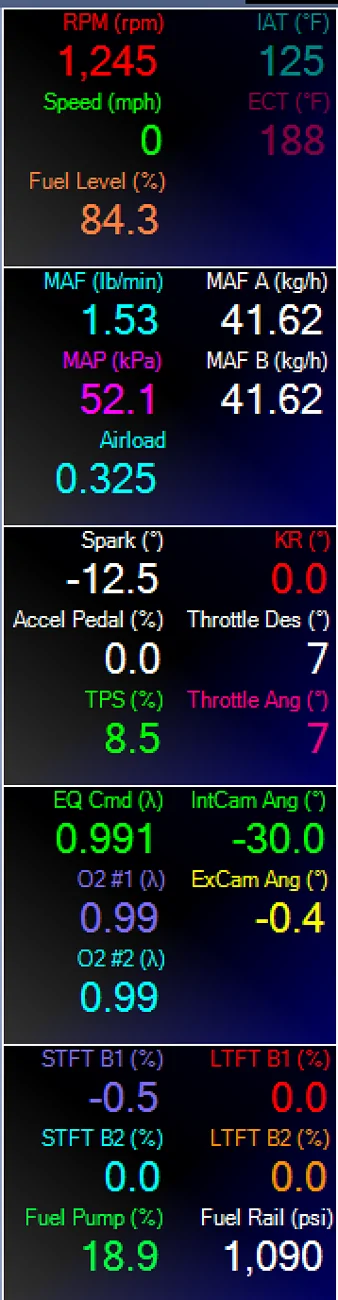

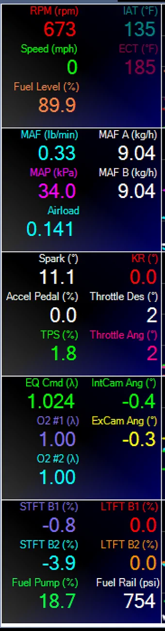

This has nothing to do with oil temp or pressure. Its strictly and only to heat up the cats as quickly as possible. Spark is retarded to get the cats hot quick and the intake cam is also -30 degrees to increase EGR to speed up cat heating. This has not nor ever been about anything but heating the cats up as quickly as possible to lower emissions. This is called ""cat light-off". There is no benefit for waiting this out whatsoever - except to the atmosphere. Here is what you would see for both start up spark and intake cam. Once light off completes around 30 seconds (depending on starting ECT), the spark will come up and the intake and exhaust cams will be 0/0. Various other things happen as well like fuel pressure drops and airload as well.
