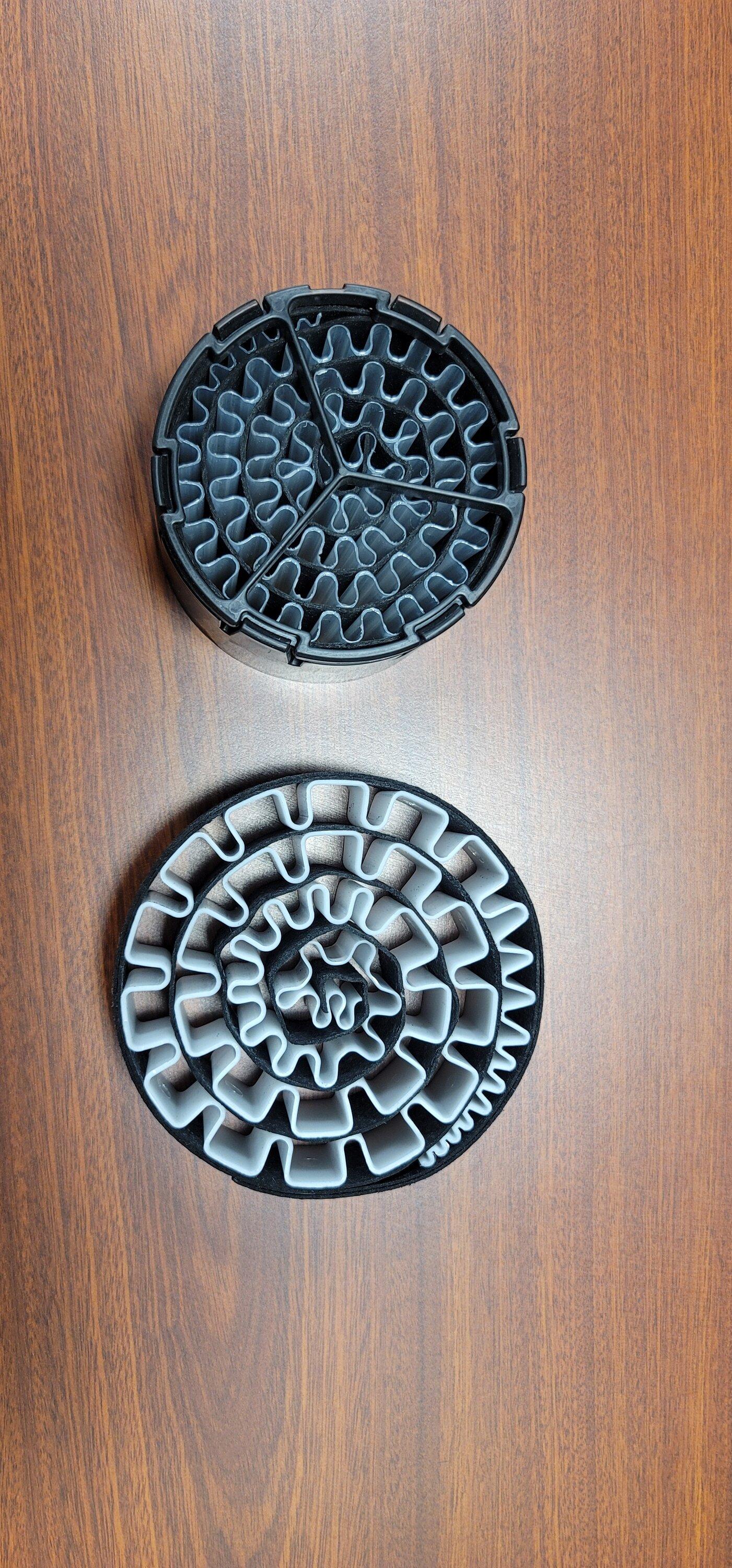

Mach 1 vs Dark Horse hydrocarbon filter
S650 Mustang DIY: how to remove hydrocarbon filters from 2024 Mustang GT / Dark Horse 20230908_054725
top is Mach 1, bottom is Dark Horse
I think they removed the clips to try and deter people from removing them. If there is an inspection, in the M1 you can pop it back in. In the DH, it is harder to return to normal.
