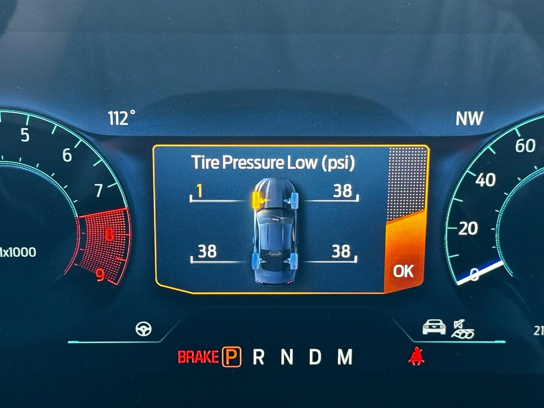

I just got a new set of wheels & tires installed on my 2024 Mustang GT. The plan was to re-use all four original TPMS sensors from my 20" Ford wheels.
One of the techs pulled me aside and claimed that when he unseated the tire, inside was merely a valve stem and no sensor at all.
I explained this must have been some sort of human error, as my car only has 1,800 miles on it and the stock wheels/tires had never been 'messed with' or taken apart. I HAVE had readouts for all four tire pressures since I took delivery of the car.
S650 Mustang Discount Tire tech claims I had no TPMS Sensor inside stock Ford wheels imag
Now of course, I've got no sensor in my front left and my car is constantly giving me errors and warnings every 5-10mi of driving.
It appears Discount is going to honor what I believe is their mistake, and will be ordering and installing a new TPMS sensor for me when they can. My question is, is it possible my car actually came with no sensor from the factory? If so, how would I have had readouts since purchase?

there is absolutely no way your vehicle came without a TPMS sensor. the guy probably broke it, those things are rather fragile. if you were missing a TPMS sensor, you would've known the second you took delivery. in my over a year of checking in new vehicles (probably totaling close to the 3000-4000 vehicle range), i have not once seen one come in without a TPMS sensor

Thanks very much for the insight, this was certainly my first thought! To DT's credit, the manager working the floor this afternoon took down my car's VIN and said they'd call me this upcoming week to schedule an appointment to install a new one. He didn't make any supporting claims that my car came with 3 of 4 - that was only the story the tech initially told me. I'm thinking it must be human error, maybe it broke and went flying out of the wheel without him noticing.

I do not think your car was missing a sensor. They broke it and didn't want to fix it. Very shady practice. I'm glad you're getting another one, but I wouldn't let them install it.

Tire tech broke it.
