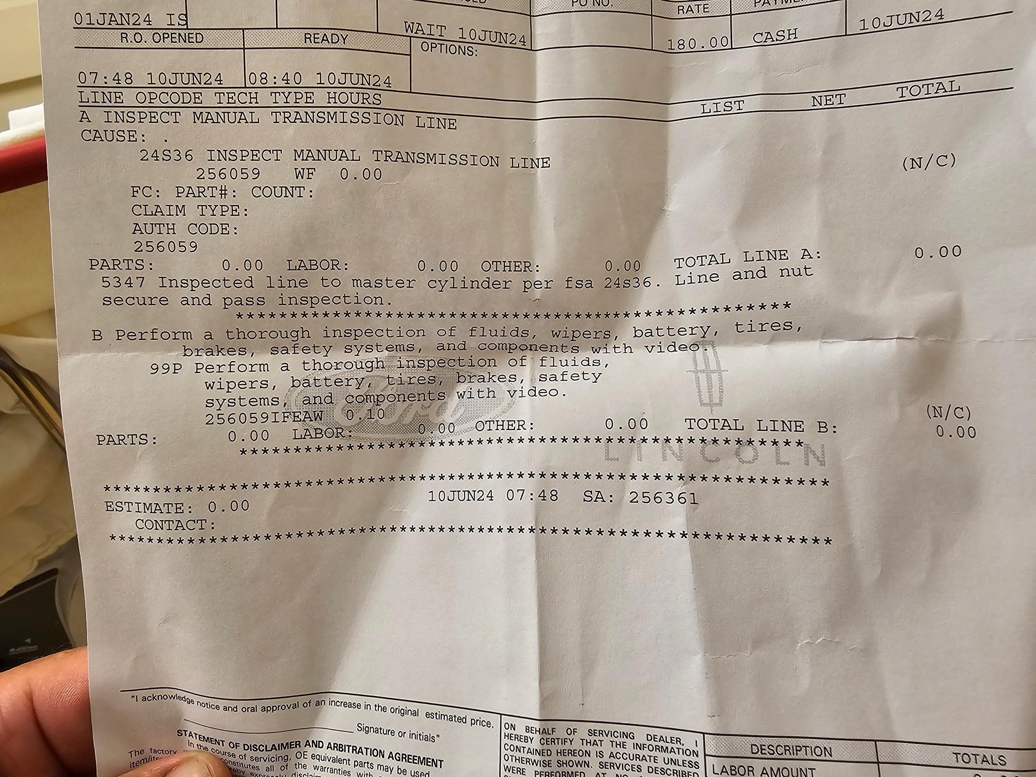

I received this recall notice on my Ford Pass app and instantly thought of this thread.
2024 Mustang Inspect manual transmission lineRecall Incomplete
On your vehicle, the hydraulic clutch pressure line may not be properly retained to a locating stud on the dash panel. A line with improper retention may contact hot exhaust components and melt, leaking hydraulic fluid.
Safety Risk
A leaking clutch pressure line will not impact the volume of brake fluid in the brake system, so you will not observe an impact to brake function. However, this condition can impact the brake fluid supply in the clutch and can result in an inability to change gears. If leaked hydraulic fluid accumulates near a sufficiently hot surface, you may observe smoke and experience an under-hood fire. An under-hood fire increases the risk of injury.
I just got back from the dealership and my DH M6 is apparently OK.
