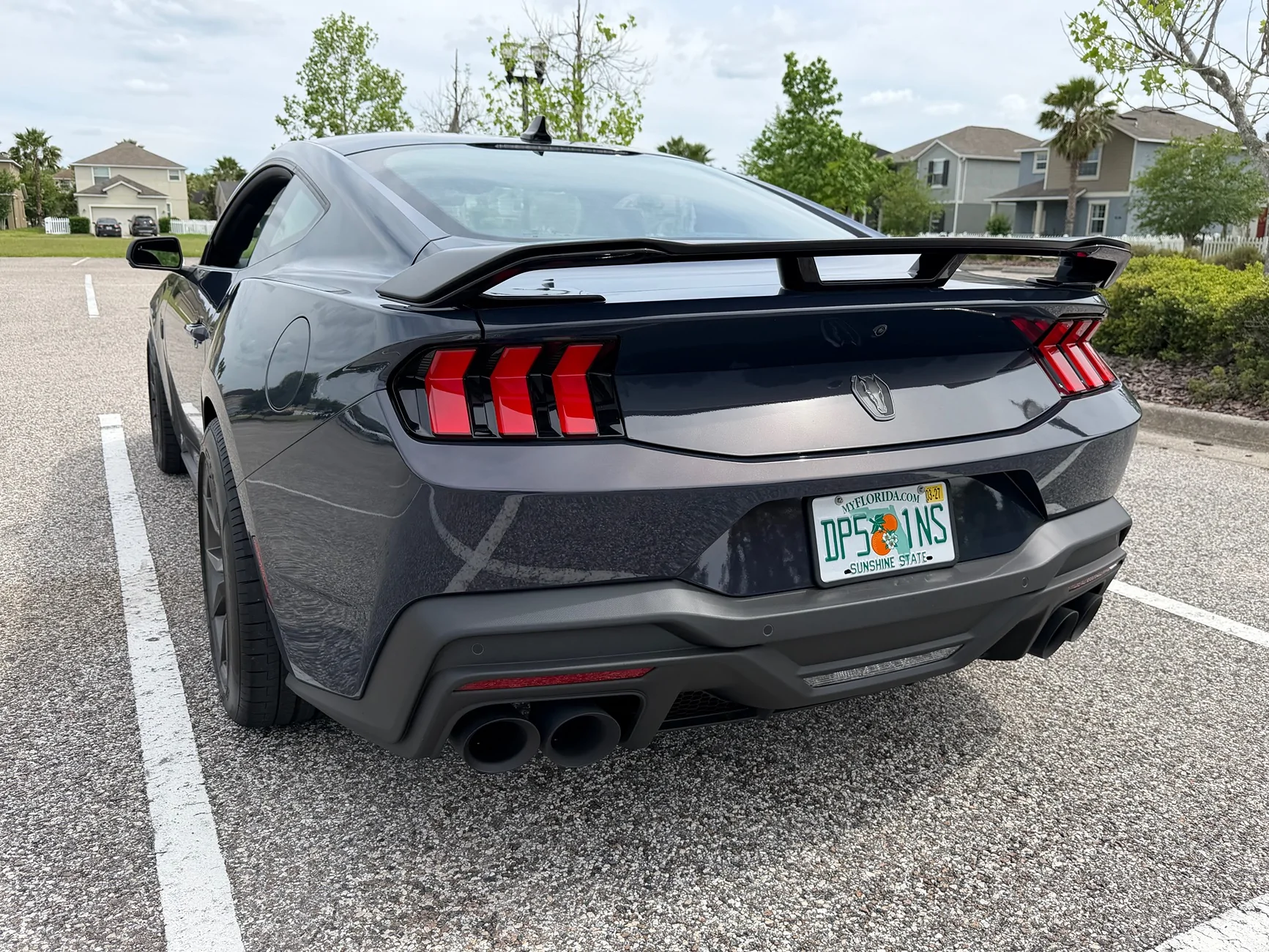

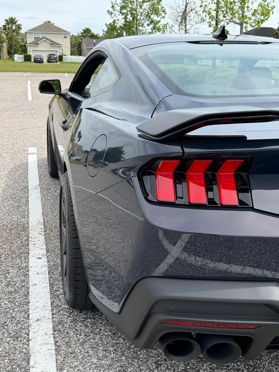

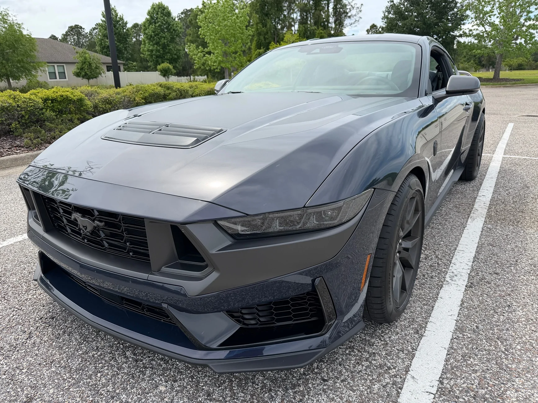

This is mine.
Thanks for the photos. How much does the outermost part of the tire pokes from the fender front and rear? It seems that the rear’s poke a tad more?
