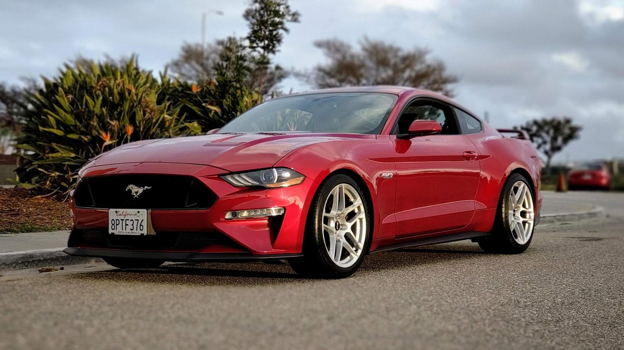

That is a perfect Mustang fitment. I ran Mich PS4S up front and the Mich PSS out back (no PS4S in 305/35/19). My S550 with this setup..I will be running the same setup when my S650 arrives.
S650 Mustang Dark Horse-Non Handling-Wheel Setup-Opinion IMG_20220319_183508116_HDR_PORTRAIT~2
