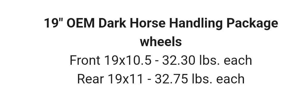

Project 6GR weighed the DH HP wheels and published it in the 6th gen forum:
S650 Mustang Are Dark Horse HP wheels forged? Screenshot_20240121_204715_Samsung Internet

There is a lot of weight to be saved from aftermarket wheels.

Nice flow-formed wheels at reasonable prices can be had in the 22 lb / 10 kg range. I saved 40+ pounds of unsprung weight from my '22 by immediately swapping the rims. If primarily driving on the street, they're a nice sweet spot between cast and forged. If tracking often, I'd gravitate to the latter.
