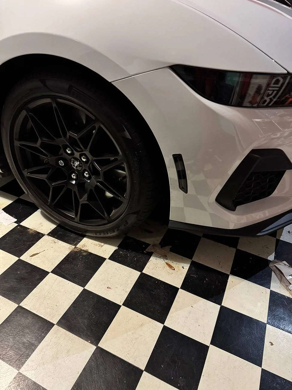

All Form Lighting for Side Markers, Rear Reflectors, Rear Break Light

I did the rear reflectors from diode dynamics. Are the side ones worth it?
