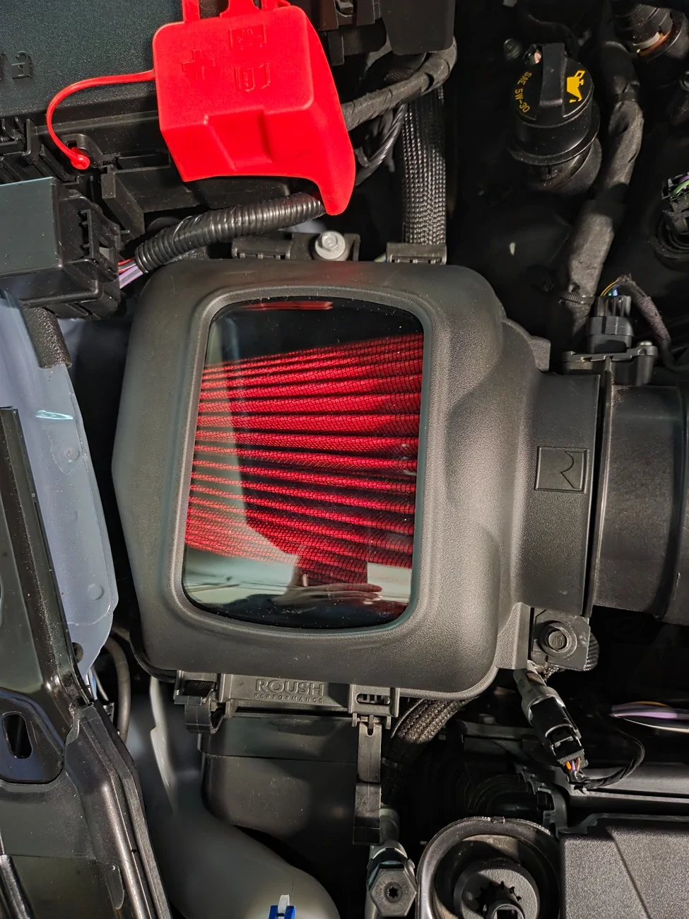

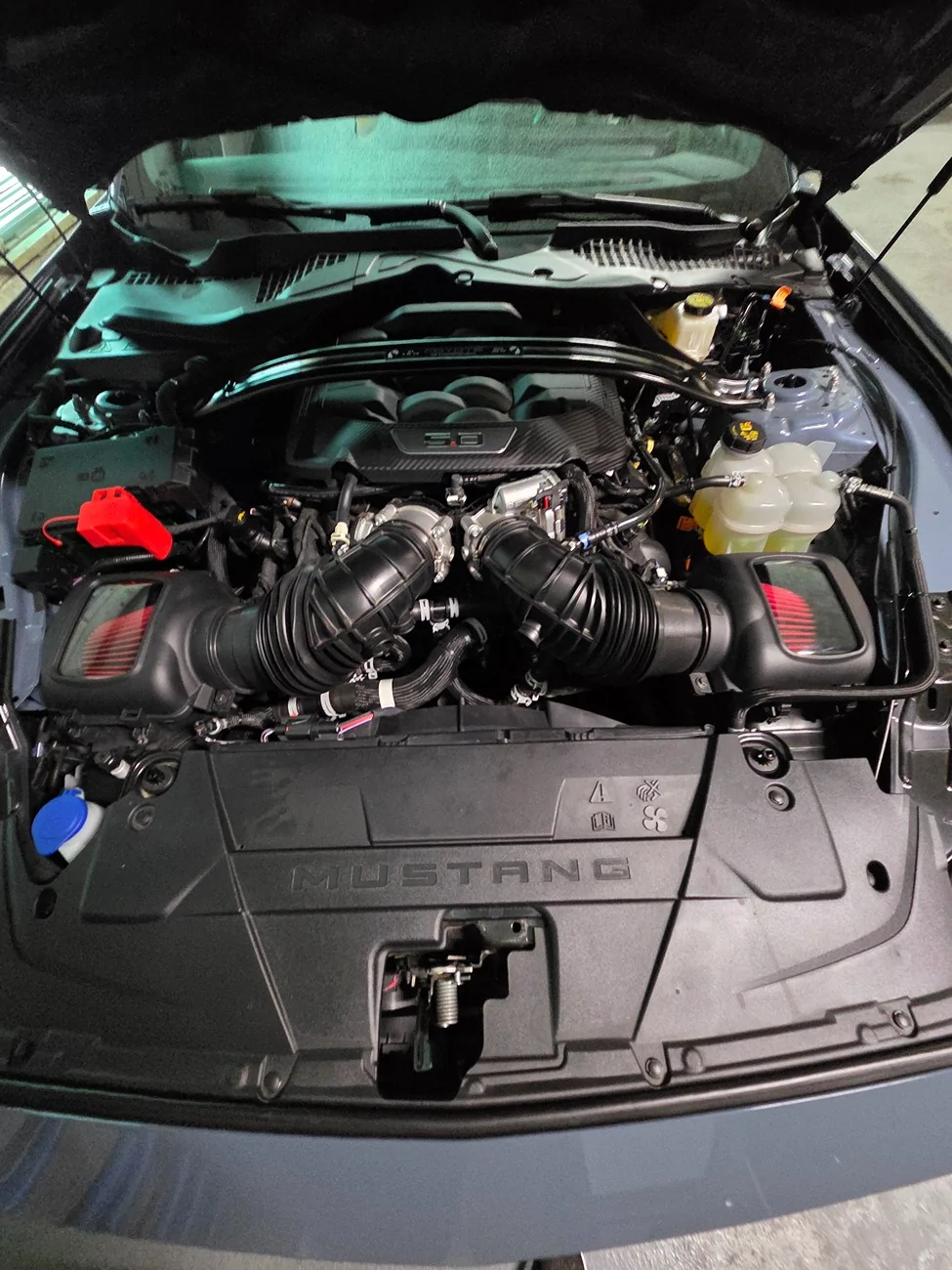

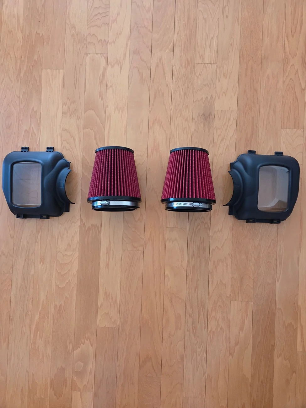

@Byote4 ...... for your peace of mind and my interest I went to my friends son's shop tonight. He is head of HVAC at a local hospital. We rigged sensors to the underside and top cover of OEM Ford air box covers for a 2026 Mustang GT as well as the Roush clear plastic covers I had on my 2024 Mustamg GT. We set a heat gun to 80 degrees F. There was absolutely no difference in heat gain between the two. In about a week when my Corsa clear top air box covers arrive I will perform the same test but expect no difference so do not worry about any performance loss or any measurable heat gain from using Roush or Corsa clear air box covers. ZERO heat gain. As for filters I chose the AFE non-oiled as we found through testing that oiled filters (unless very carefully maintained) lost power and let dirt by pass them. The AFEs are easily cleaned many, many times by rinsing in a mild solution of Simple Green then rinsed with warm water and let to dry. When we were building racing engines (auto and marine) we found dry material air filters superior to most OEM filters and all oiled filters we tested. It is my belief (not flow tested) that the AFE filters I have installed sound like the engine is breathing easier at least the engine sounds better IMO. Does that translate into a measurable HP gain - I would say no. Easier breathing I would say yes but not measurable HP gains. It is more for looks. Thruth be known there is a 5% difference in HP from engines leaving most engine ssembly lines that are mass produced as compared to hand built. I have attached a picture of the Roush clear top air boxes on my 2024 GT and will post a picture of the Corsa clear tops on my 2026 GT as soon as I have them installed. I love the look and get many compliments at coffee and cars. Someone suggested I light the engine bay with leds. I like that. Good luck with your decision.

You didn’t have to do any of this brother thanks for the help 🫡
