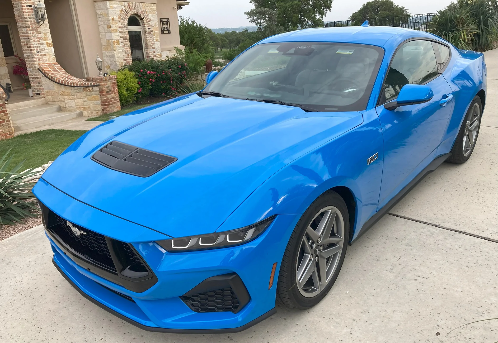

Sorry. I am not going to do redline shifts from 1st to 2nd ever again. Does it every time. Probably on 3 different occasions. Only 3500 miles on the garage queen.
S650 Mustang Clutch Protection - Do our GT's have it? IMG_3930
Too risky - Love my car to much to potentially hurt it. If you have not heard it in yours you are doing it right. It is LOUD and unmistakable.
