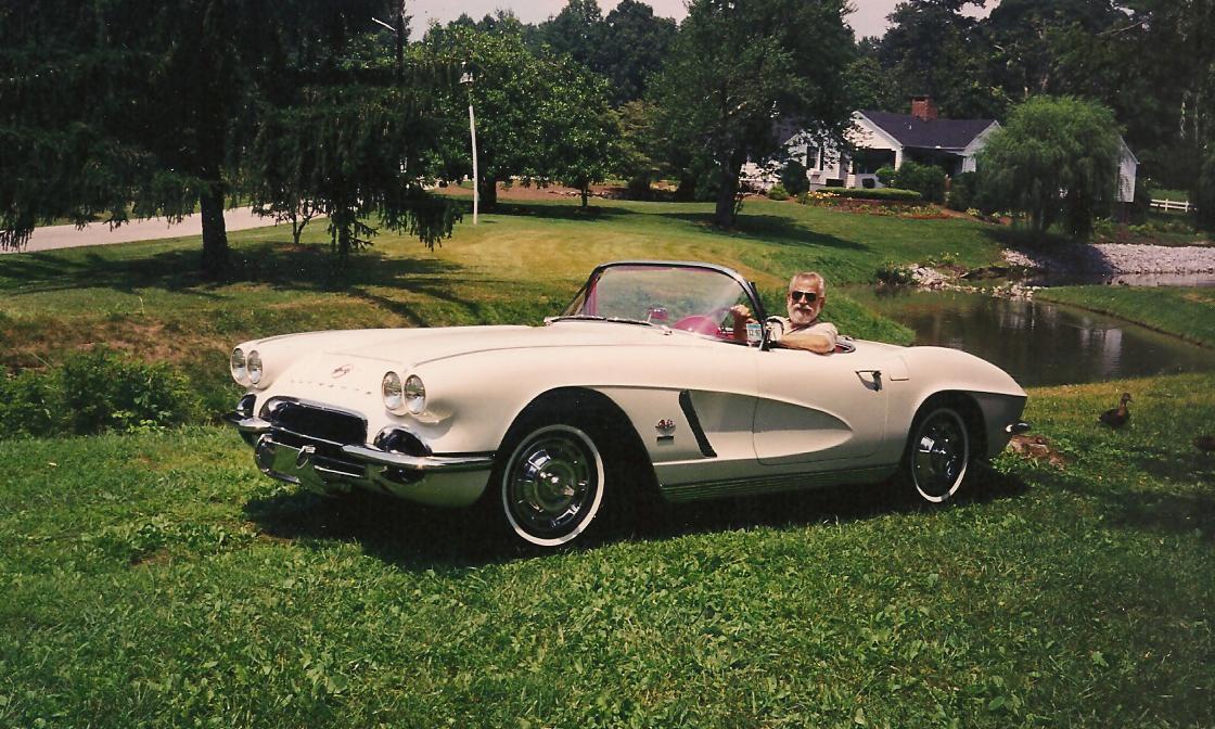

Other than my Mustang, my other fun car is a '62 Corvette fuelie. It's a 4-speed, of course, with a 4:11 rear end. Fun car around town and loafing on country roads but that 327 is screaming on an interstate at 70 mph.
