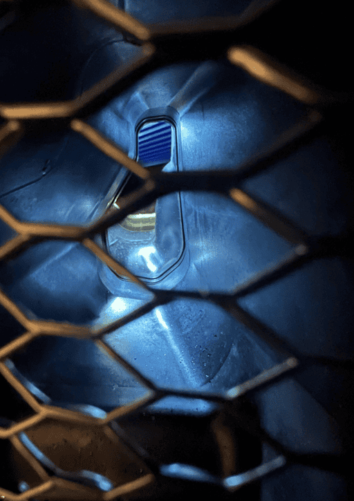

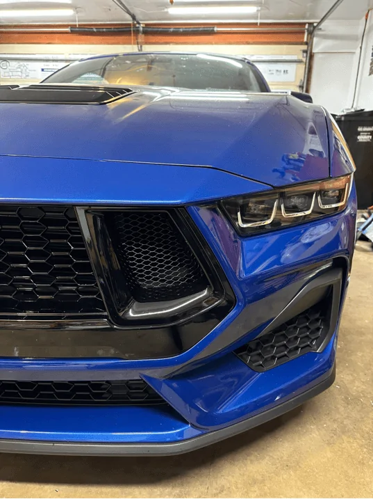

I know this is controversial but I'm just running this until / if the aftermarket offers something better. I spoke to Anderson Composites and they are making something with mesh in that area. Until then, I used a hexagon grill mesh to try to match the design of the hexagon grill covering the radiator. I didn't want to dremel out the existing hexagon fill plates because I wanted mine to look a little different than what I saw everyone else doing so I dremeled out the whole section from the backside and used my own mesh. I actually tested Ford's setup against mine in a sense by using an air canon pointed in the general area before and after. My setup was flowing exponentially more air. I know it's not extremely scientific. Just my observation with a little cowboy science. Say what you want but no CELs and she runs like a mad dog. The Steeda ProFlows I added today are going to get a direct shot of air now. I'm ready to be "grilled" now...

it would personally bug me to no end that the pattern and scale are different, but it's still really cool! honestly not sure why Ford blocked some of the holes on the stock grill

It was the closest I could find. They are just smaller hexagons but they were the biggest hexagons I could find in a pliable black mesh. I actually thought about leaving it completely open like the Dark Horse but wanted something a little different than what I have seen around the interwebz. I was also worried the dremel wouldn't make clean cuts and muck up the exterior side but it worked extremely well. If I told someone I spent 3 days cutting it with an exacto knife they might actually believe me.

I measured the distance from the ground to the middle of the air intake on the grill and set my air canon in a fixed position blowing air in that area from the same distance at the same air speed before the mod and after the mod. All I had to do after the air canon was turned on was put my hand in the air filter box without the air filter in place to feel the difference in airflow. What I can't measure is with the lid closed so that is why I said it's kind of a crude cowboy science.

To each their own, but for me the pattern is too small.
I will say I wanted to use something about twice the size I did but I couldn't find it. This was the biggest I could find with a similar hexagon pattern in black. If I could have found something bigger it probably would have been easier to mold into the shape I needed as well. The smaller hexagons also made the mesh somewhat difficult to mold to the curvature of the backside of the front fascia in that area. Molding it around the little lamps in that area was a PIA as well.

I had it just open for a little bit while I still had the front fascia off and it looked good like that as well. I probably would have been happy with that look too. It was kind of like the Dark Horse but just looked like a black void compared to the Dark Horse's grey outlined hole. No pictures of that unfortunately. We have so much stuff falling out of the trees here all the time combined with big bugs and I wanted some mesh just to keep some of the debris out of the air filter box.
