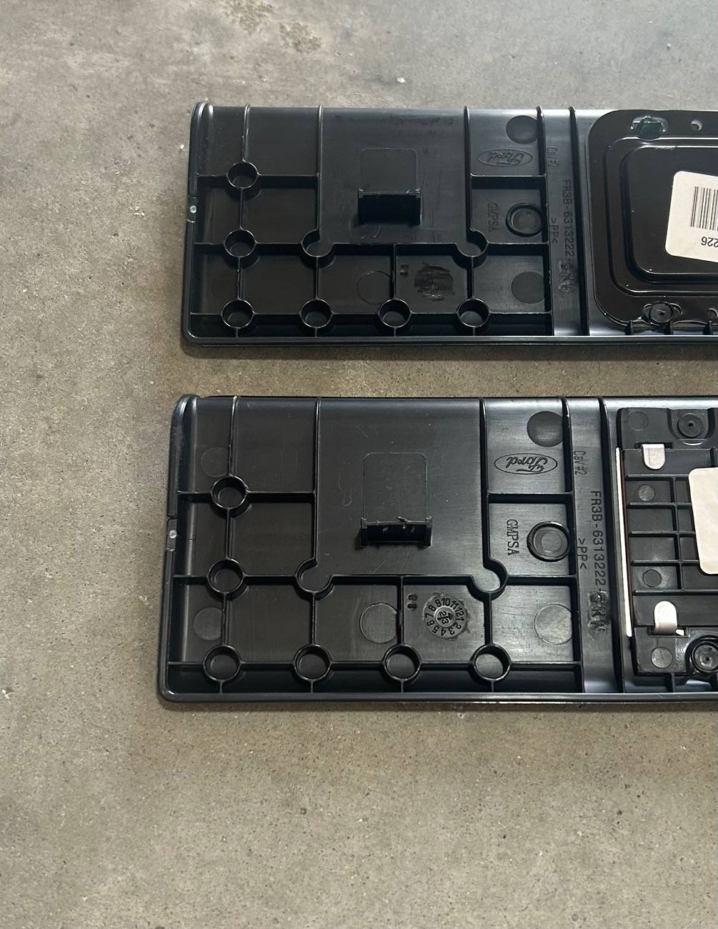

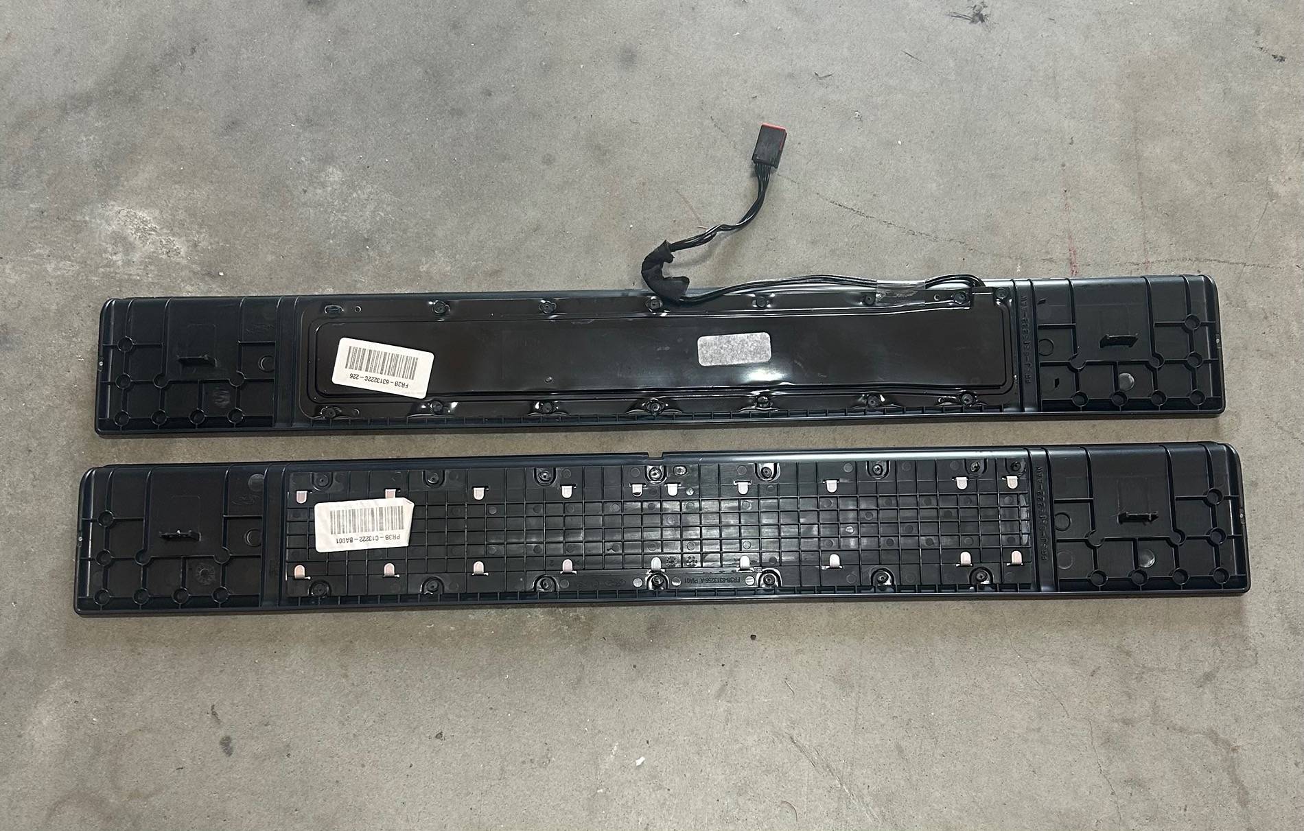

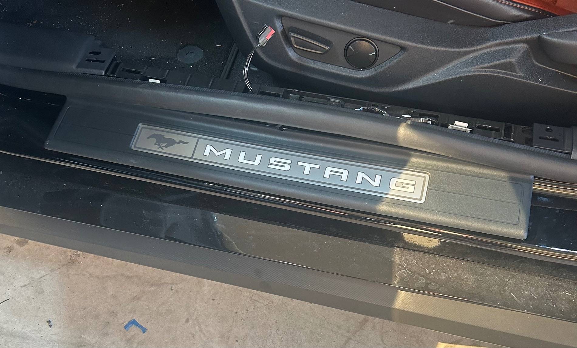

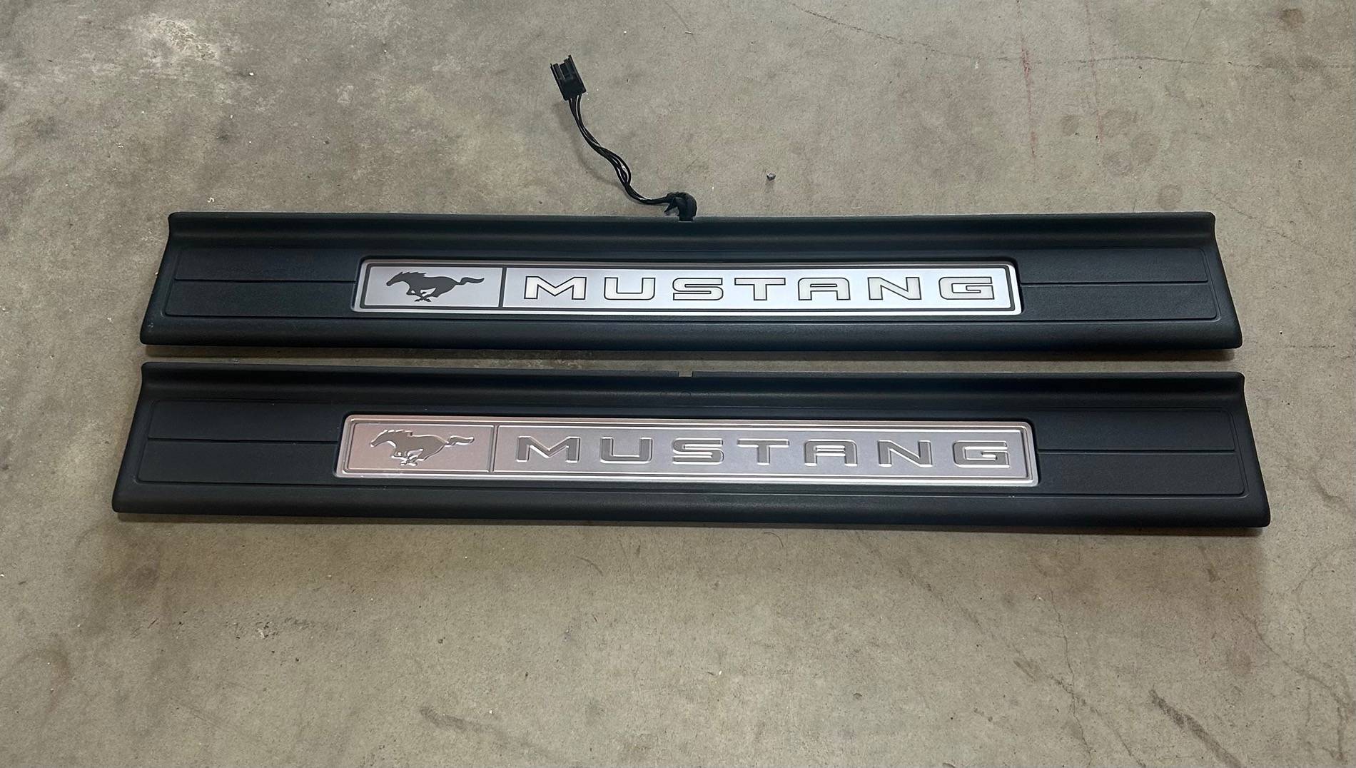

So these will fit the '24 S650's even though it says 2015-2023?
The dimensions are exactly the same, including where the tabs are. Also, here's a pic of one sitting in place (I don't want to push it down because I still need to get new double-sided tape to put in the center, first).
S650 Mustang Brand New Take Off Parts on eBay IMG_7386
S650 Mustang Brand New Take Off Parts on eBay IMG_7387
S650 Mustang Brand New Take Off Parts on eBay IMG_7388
S650 Mustang Brand New Take Off Parts on eBay IMG_7390

Thanks for the info and the pics. Now I just need to see if this will work on the Base GT:)

Pop off the covers. Only takes a minute. See if the connector is there. If so, you’re halfway there.
@roket helped me with what we'd need to do with FORScan... I haven't tried anything it, yet. Here's what he told me.
you are gonna want to go into the FORScan spreadsheet, into the "BCMB" tab, and look at "ALM Zone 1" and "ALM Zone 3". if one of those is not enabled, enable it. dont worry about the lack of a zone 2, Ford seems to have never used that one
I've been seeing things lately about changes to the BCM, or BdyCM?, don't work. I hope this isn't one of those!

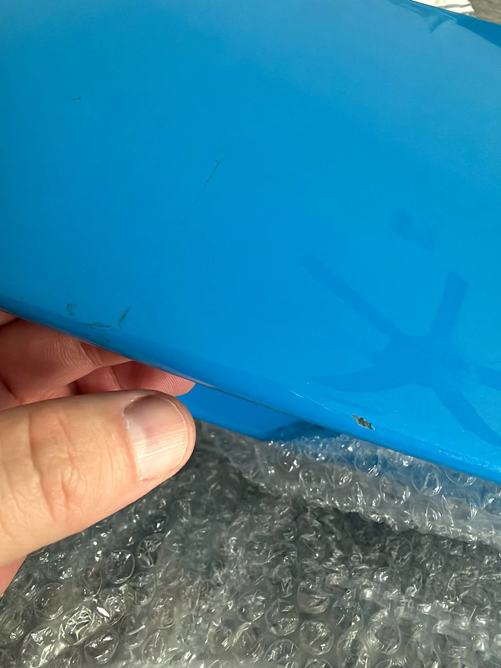

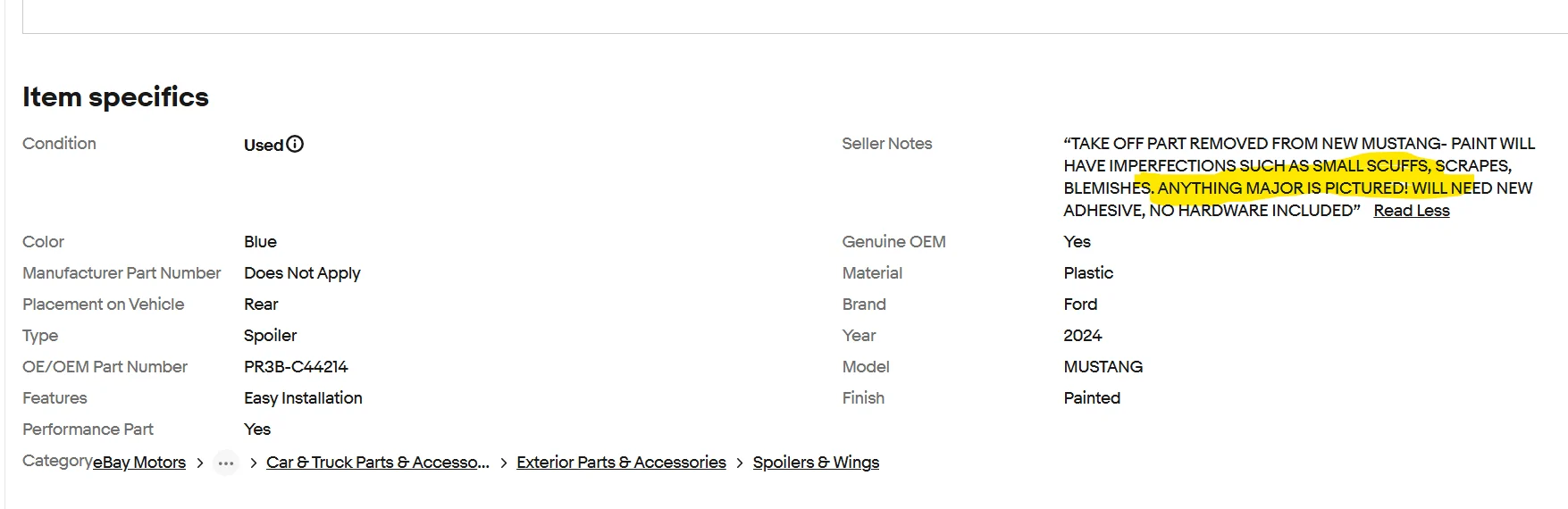

Please let us know how the return/exchange goes. Everything I’ve seen has been perfect, so this will be good information to have.
Refund was issued from eBay this morning. No communication from seller but got my money back so all good.
