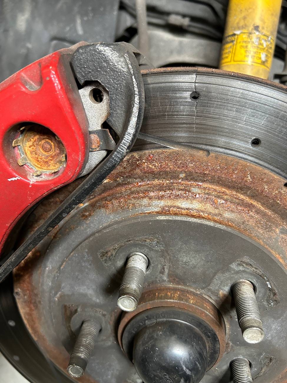

3,011
2,994
Drilled Powerstops will crack for sure
I mean what are the conditions you were in to cause this? Many vehicles have drilled and slotted and work well. I’ve had them and no issues. There are variable that can cause this for sure but also these rotors can last a good while too
3,011
2,994
Car wasn't being auto crossed or anything
just a couple years old

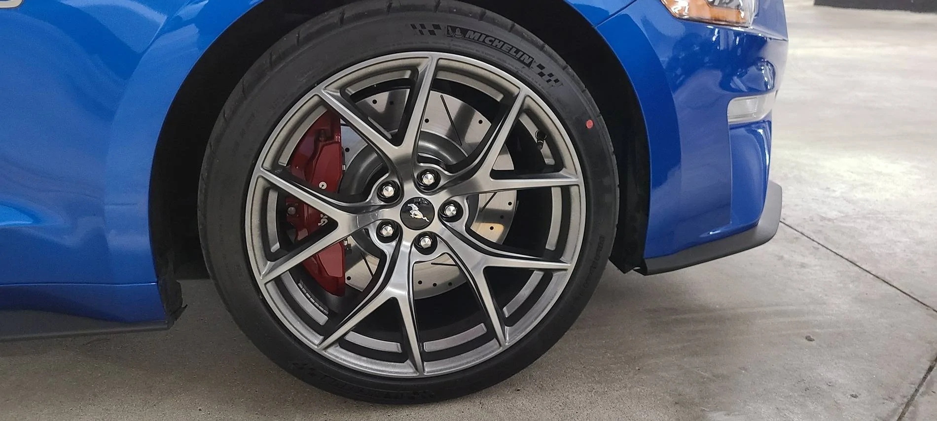

R3tro GT
Mar 14, 2024
155
223
Toronto
2024 Mustang GT Premium - 2023 F150 XLT Powerboost
I put Powerstop Rotors, and pads, on the 2019 Mustang GT I had. They looked and performed great. Can't speak to the longevity of them as I did not keep the car for long.
S650 Mustang Brake rotors (drilled and slotted rotors) - recommendations? 20201120_132643
