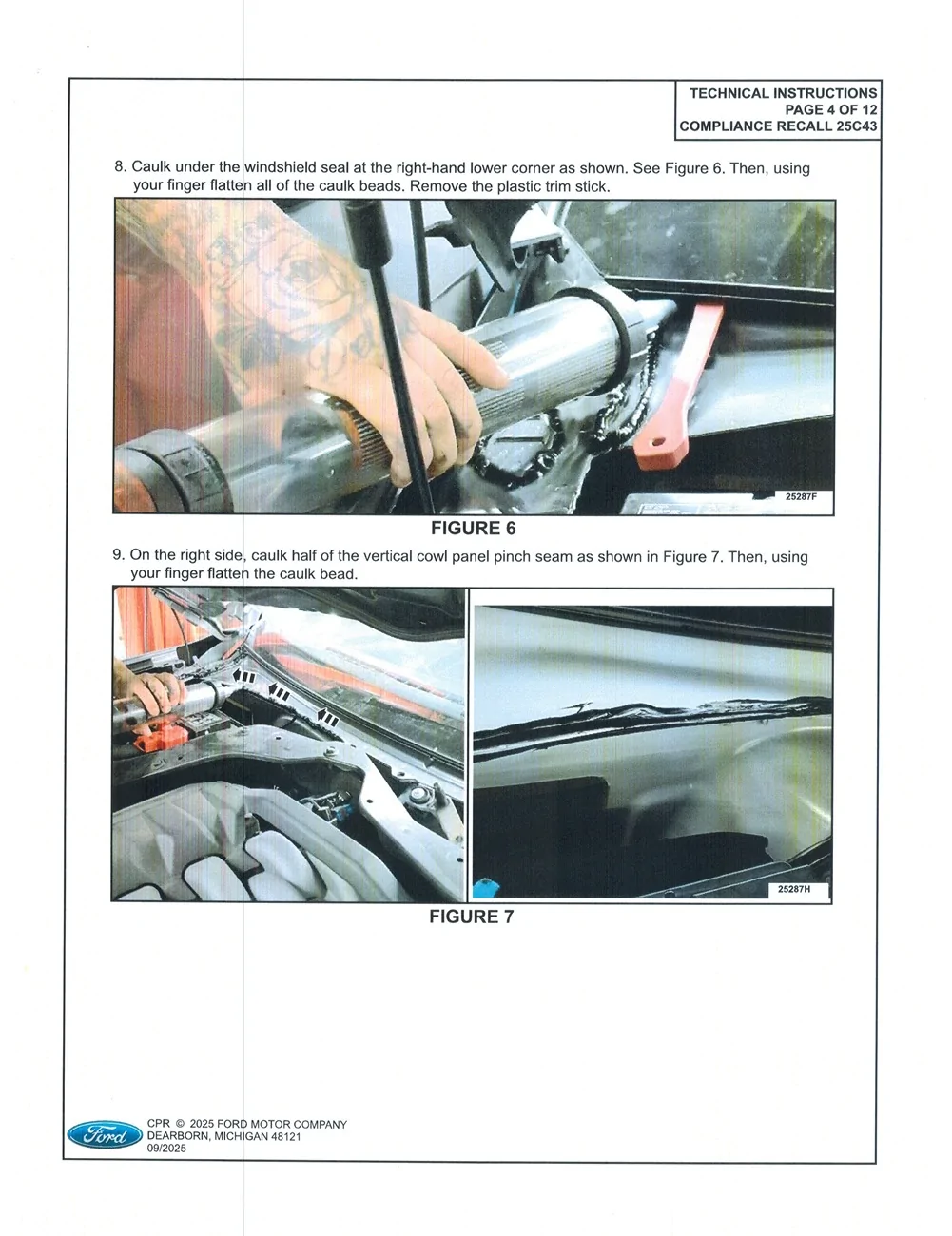

Here is what the dealer printed out for me. The body shop has to do the work. I hope they paint over the mess this sealant leaves. There were another 7 pages of instructions for testing the fix.

This is really interesting! I've seen the NHTSA recall bulletins before, but not recall instructions from the dealership's side of things.
Often times they can also be found on the NHTSA website...
