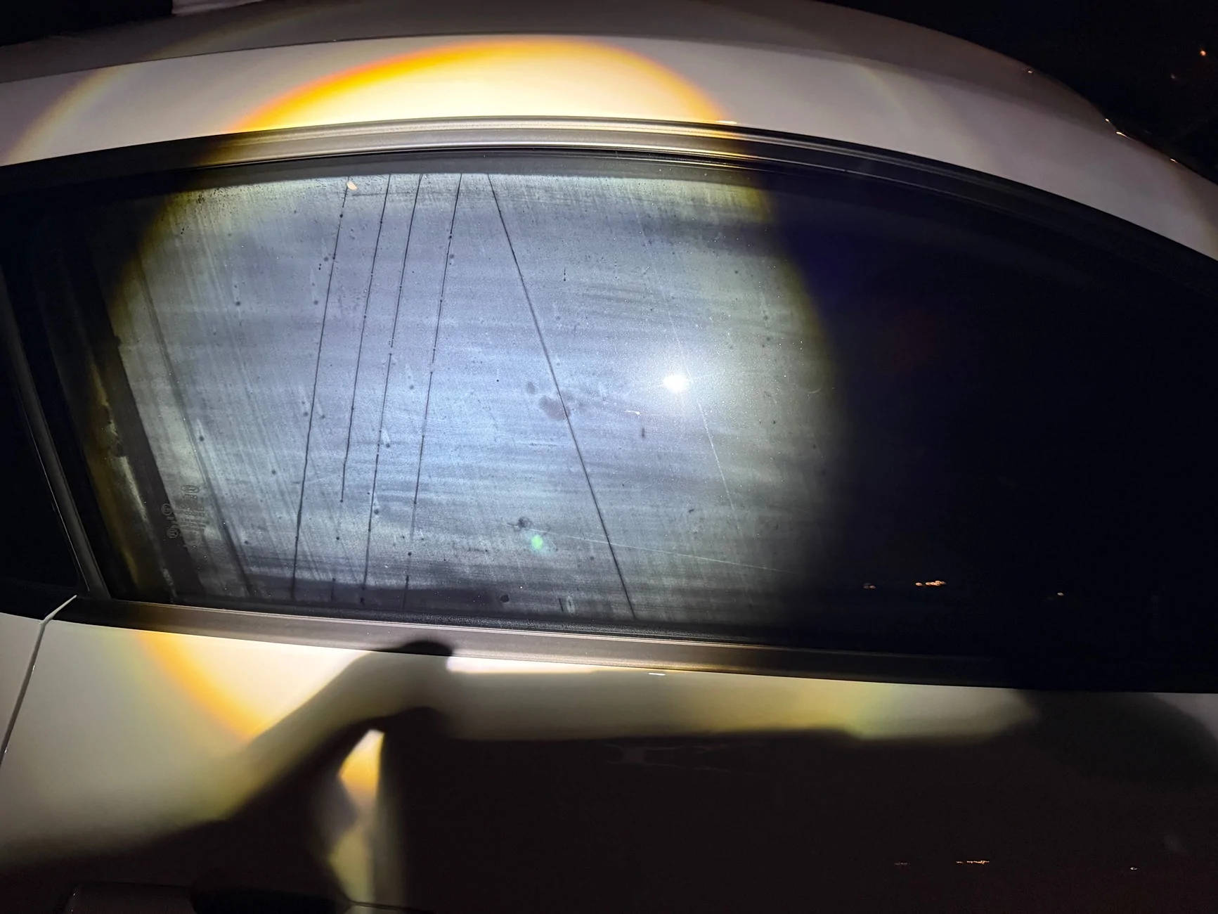

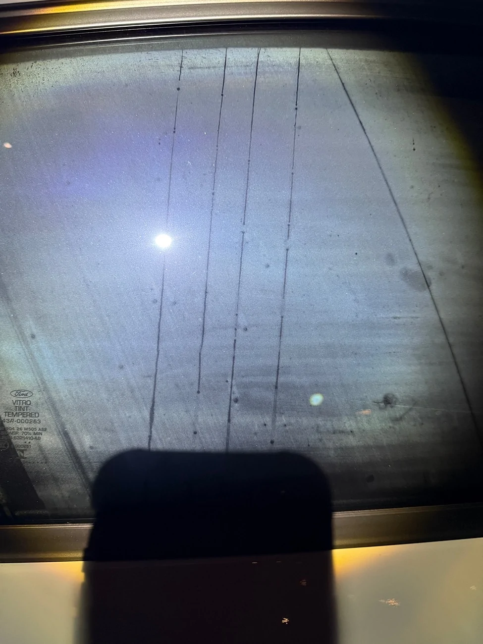

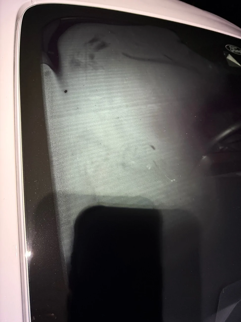

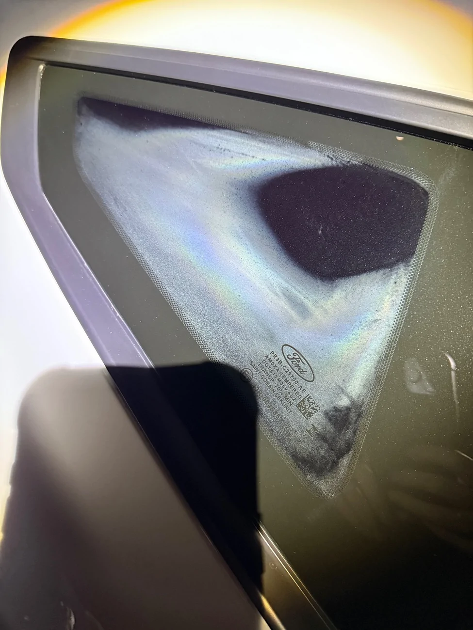

After two days of heavy rain, my Dark Horse triggered a StarGuard “power disconnected” alert. The key fob was inoperative and the vehicle had no electrical power. Battery voltage measured approximately 3.0 V.
I jump-started the vehicle and allowed it to idle for approximately 30 minutes to recharge the battery. Initially, no obvious wet carpet was detected. As the vehicle warmed up, heat from the passenger-side exhaust caused moisture trapped in the carpet padding to evaporate, fogging the interior windows. At that point, the passenger-side carpet was confirmed damp, indicating hidden water intrusion absorbed by the underlayment.
The vehicle was towed to the dealership and is scheduled for the water intrusion recall repair on Wednesday.
Question: Has anyone else experienced water intrusion that led to a severe battery drain or complete electrical shutdown?
Has anyone else experienced water intrusion where the carpet surface initially felt dry, but moisture was present underneath the padding or in the padding and only became noticeable after exhaust heat caused evaporation?
