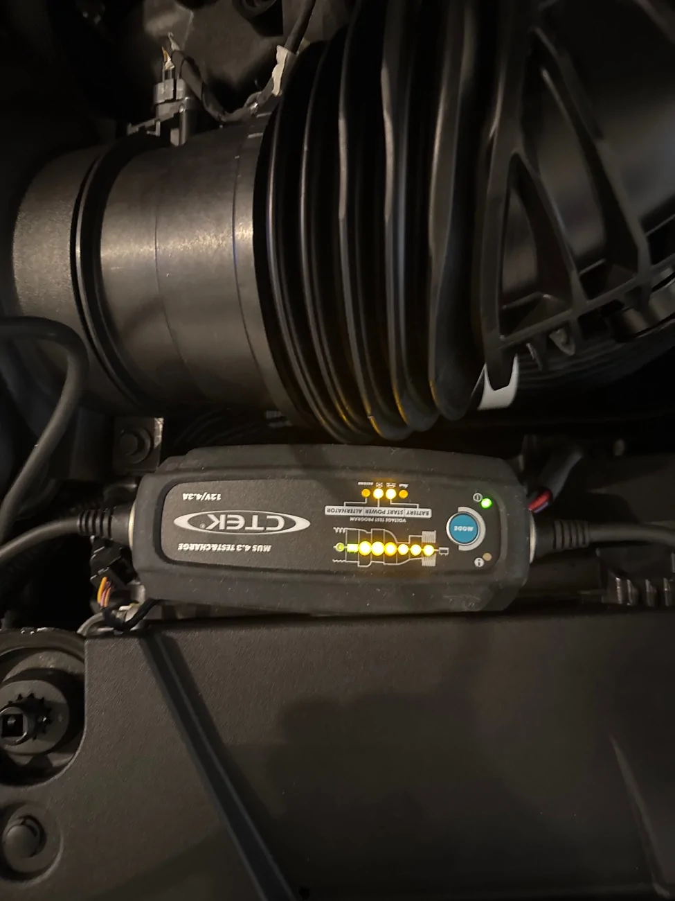

I use the Ford Performance charger. It's made by CTEK. $40 cheaper on Amazon.
