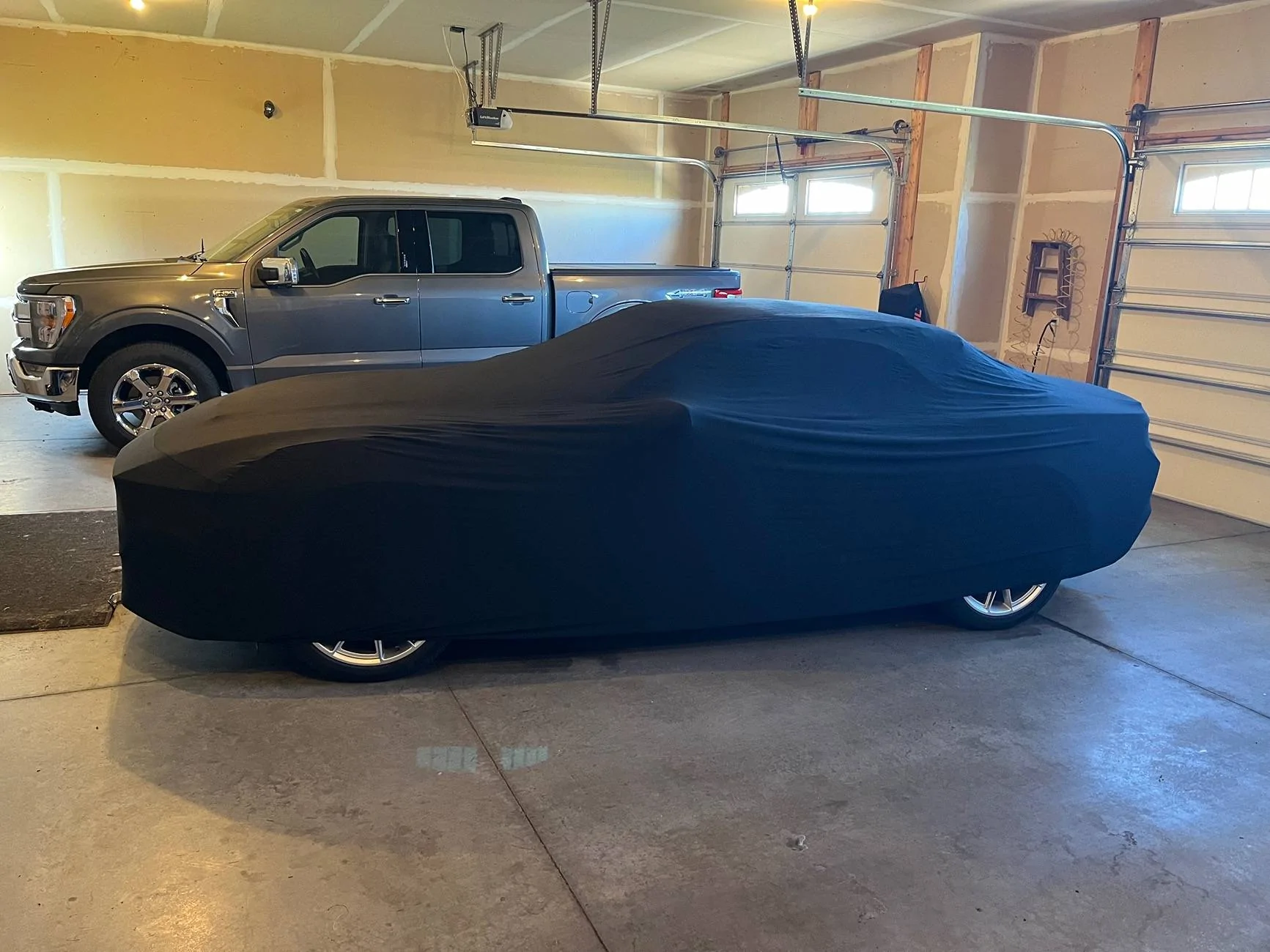

Luckily I have a heated garage. Wash the car, clean the interior, pump the tires to 50psi, hook up the trickle charger, stabil in the gas tank, cover, pray for spring.
S650 Mustang Getting Prepared for Winter "Storage". IMG_1980
