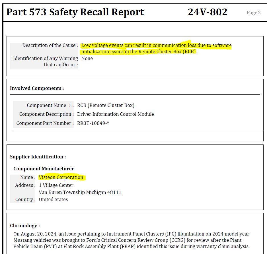

Some more detailed information about the issue and timeline can be read here:
https://static.nhtsa.gov/odi/rcl/2024/RCLRPT-24V802-9220.PDF
Definitely sounds like a software fix. I just wish we knew when they'll have it ready. Not this generic Q1 2025 non-sense.

I worked in electronics manufacturing in a previous life.
You'd expect these cluster screens would have firmware pre-loaded from the supplier before being integrated into the vehicle's dash assembly. They would have been tested in isolation before leaving Visteon.
I'm surprised how a low volts condition could even exist on a regulated 5V or 3V3 rail.
Which is probably resulting in a microcontroller not resetting gracefully.

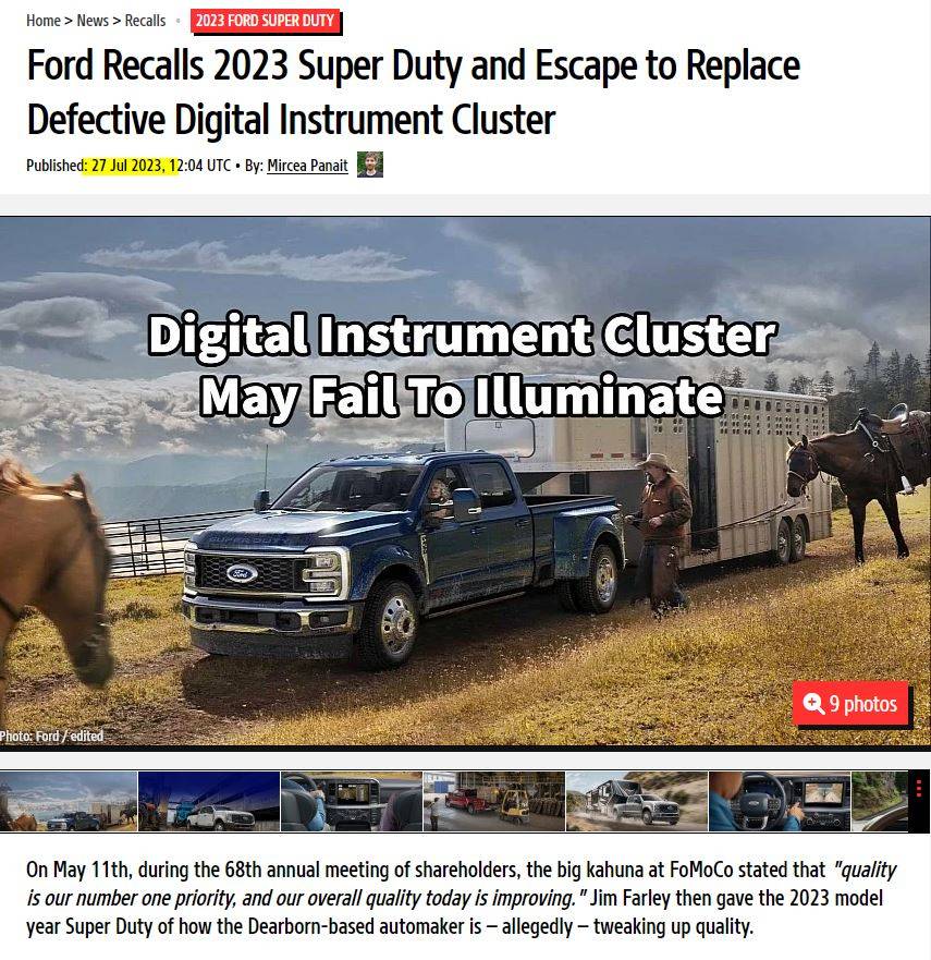

This is not the first time Visteon have had issues with their cluster screens.
https://www.autoevolution.com/news/...ective-digital-instrument-cluster-218652.html
S650 Mustang Australia - 24C35 S650 Recall and Service Action Lookup IPC2.JPG
Ford's engineering department identified hardware failure caused by poor solder joints in the remote cluster box, with said engineers understanding that the solder joint failures occur early in the vehicle's life. Visteon Corporation's Mexican plant was required to, and duly implemented, solder quality detection processes.
The supplier, however, didn't improve its detection processes enough. Increasingly more field reports and warranty claims were filed with the second-largest automaker of the Big Three in Detroit, namely 36 and 84, for a grand total of 83 Super Duty and Escape vehicles. The numbers don't add up because certain vehicles experienced said issue more than once.
Engineers determined the solder stencil used by the supplier for the digital instrument cluster didn't have the correct thickness. Worse still for the Visteon Corporation, said clusters didn't feature proper coating. It's easy to blame the supplier only for this blunder, but remember that Ford – and every volume-oriented automaker out there – cut costs wherever and however possible. Is Farley aware that contracting a questionable supplier just because it's the most affordable of all options available is a one-way ticket to Recallville?

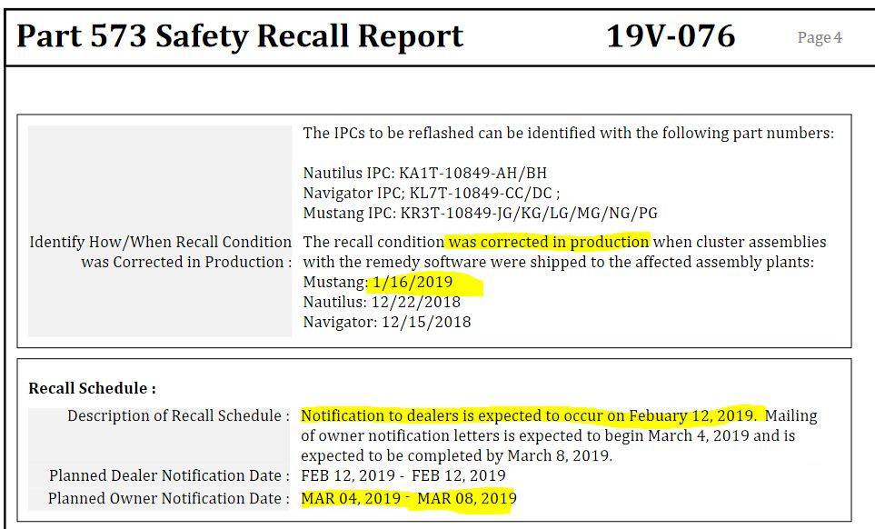

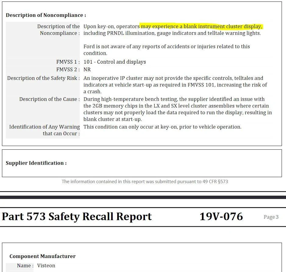

Found another previous issue with IPC screens that affected 2019 Mustangs (and other models).
Unfortunately, this is history repeating. :crying:
I certainly don't wish to upset anyone waiting on a car, but it does provide some insight on the painfully long wait until "Q1" 2025.
https://static.nhtsa.gov/odi/rcl/2019/RCLRPT-19V076-8698.PDF

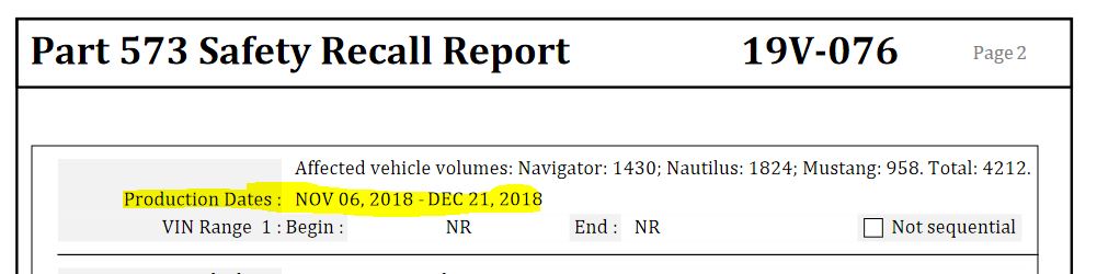

Some dates to provide a time line.
Affected vehicles produced:
S650 Mustang Australia - 24C35 S650 Recall and Service Action Lookup IPC4.JPG
It took about two months to implement the fix on the production line:
S650 Mustang Australia - 24C35 S650 Recall and Service Action Lookup IPC5.JPG
Three months later, and dealers officially notified.
