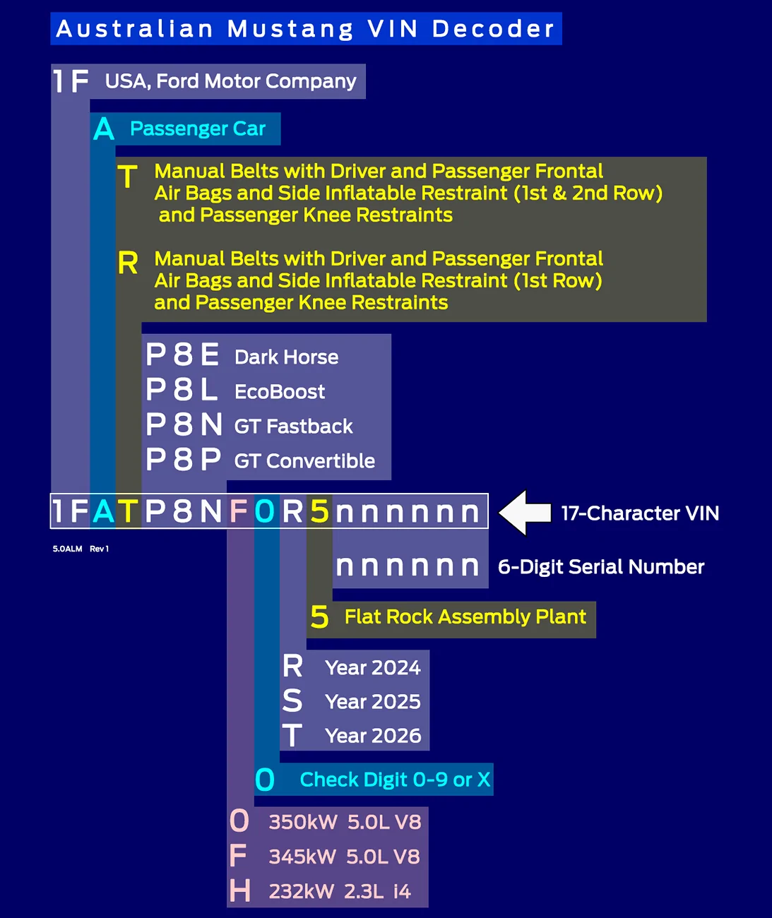

S650 Mustang Australia - 25C43 S650 recall (Water Ingress/BCM damage) VIN-Decoder-R1
I'm assuming VIN beginning with 1FAR must be S550s, and there's 528 of them.
But they have a 2024 model year?
(Digit 10 "R" = 2024)
Anyone?
Moving on to already known variants....
1FATP8E = Darkhorse, 1,000 listed
1FATP8L = EcoBoost, 770 listed
1FATP8N = GT Fastback, 4,924 listed
1FATP8P = GT Convertible, none listed
I guess you have the risk of water intrusion with a convertible anyway. :giggle:
