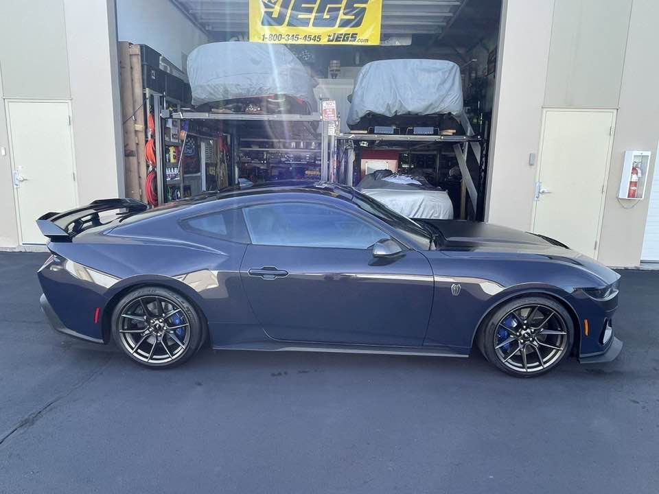

I contemplate the above while waiting for my S650 to be built. I was all set to coat the new car in Gyeon Mohs EVO for its above average slickness and ease of application. However...............................I'm now seriously considering a return to wax. Longevity is not really a main concern of mine. I really like how Collinite 845 looks and feels on Race Red, so I know its a proven winner and doesn't require kid gloves to deal with.
S650 Mustang Anyone use Top Coat F-11 Pro Polish and Sealer ? oct209

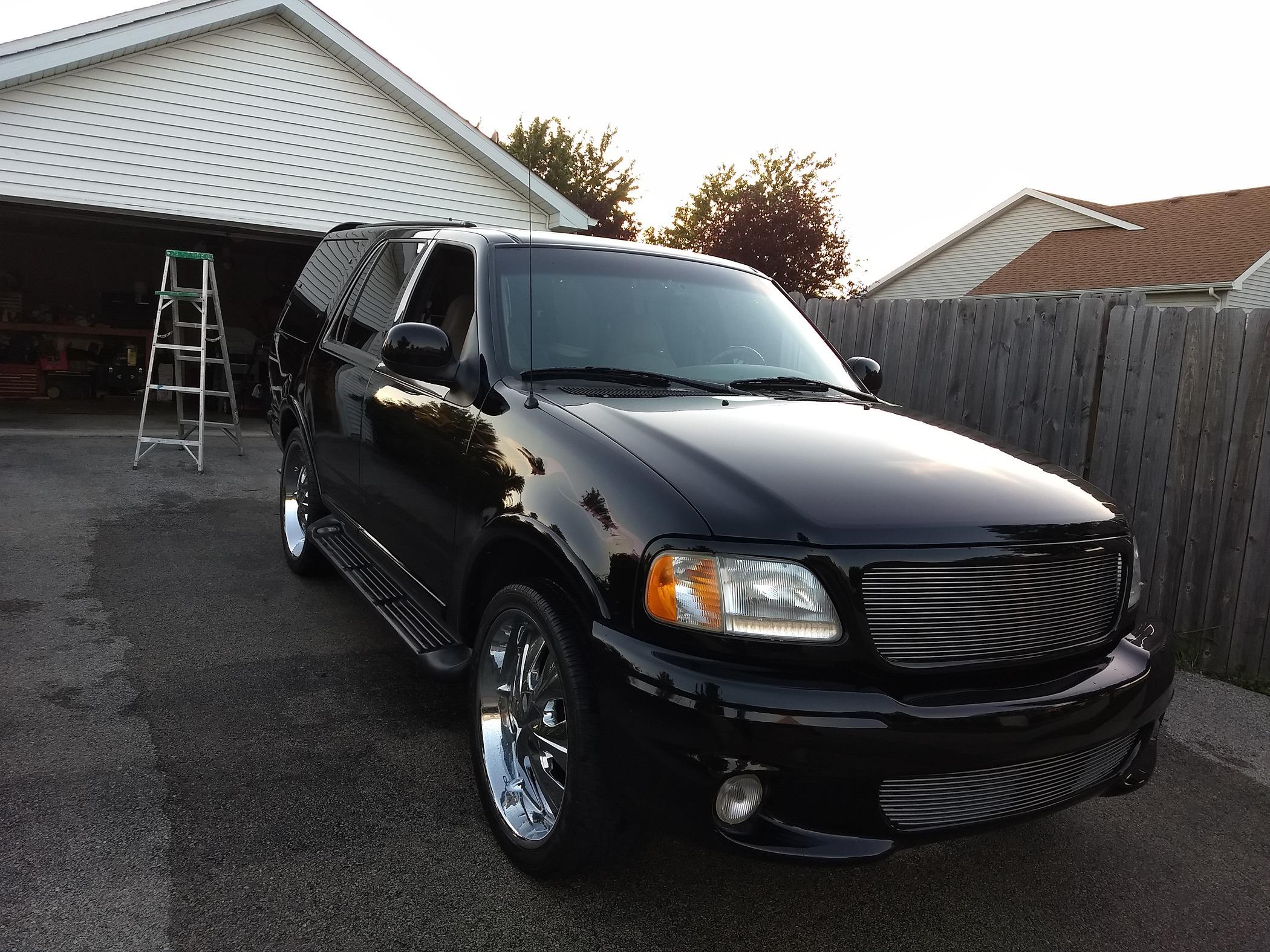

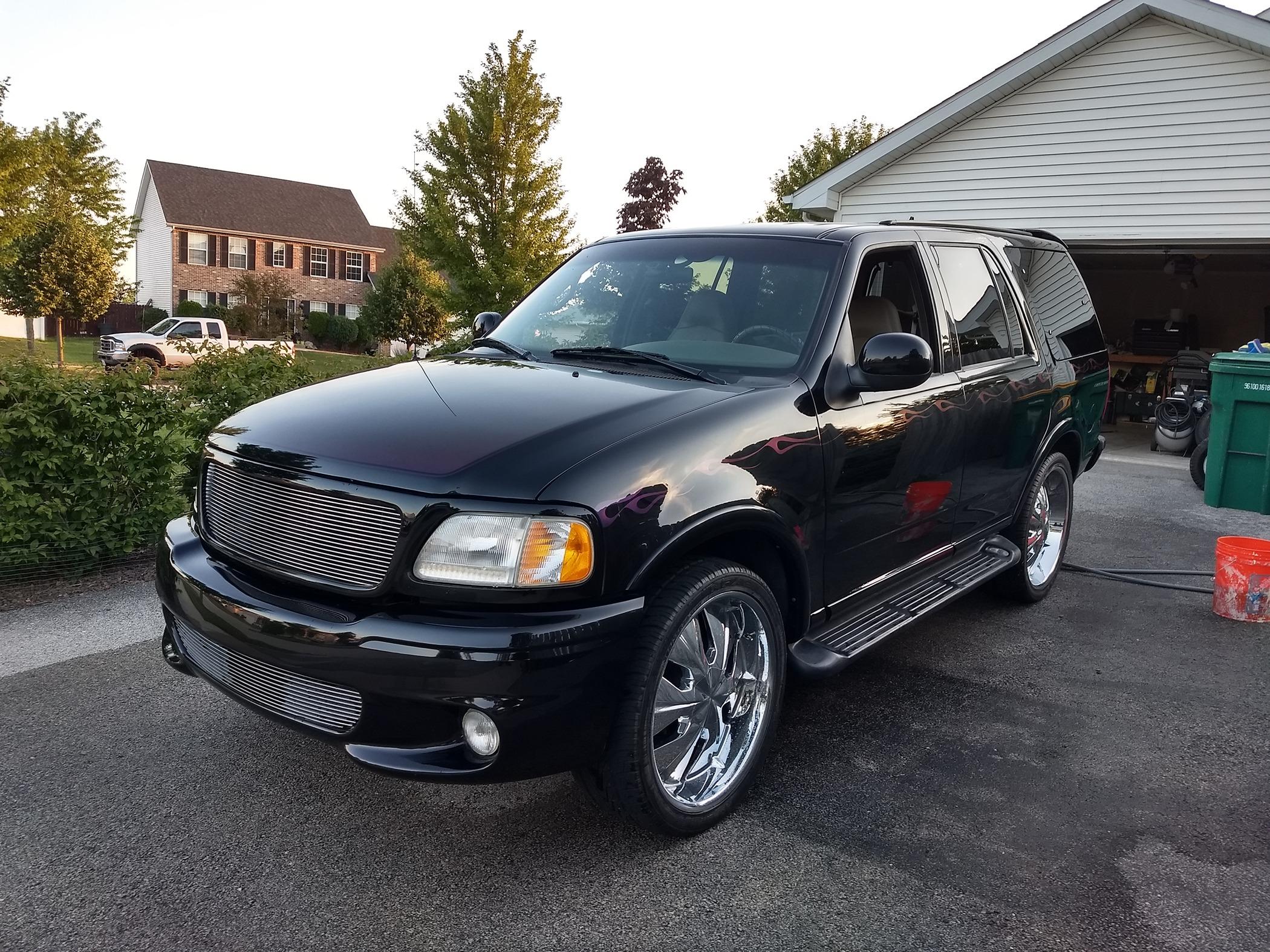

Mr JRONET:
I am personally not a fan of ceramic coating, much for reasons mentioned above. Attached is a photo of one of my cars which has not been waxed at least 8 years from taking picture. I just finished washing it by hand. I use Maguire's products only. Of course the paint is not a factory paint job. I had all door handles and emblems removed. Looks nice. But this was done early 99 truck was only 6 months old when I had work done.i does get rained on if I'm caught in it. Only used in snow for one winter. Not been waxed afterwards. Only hand washed and Maguire's Quick Detailer between hand wash. Hope this helps in your decision making
S650 Mustang Anyone use Top Coat F-11 Pro Polish and Sealer ? IMG_20200717_200212888
S650 Mustang Anyone use Top Coat F-11 Pro Polish and Sealer ? IMG_20200717_200146890_HDR

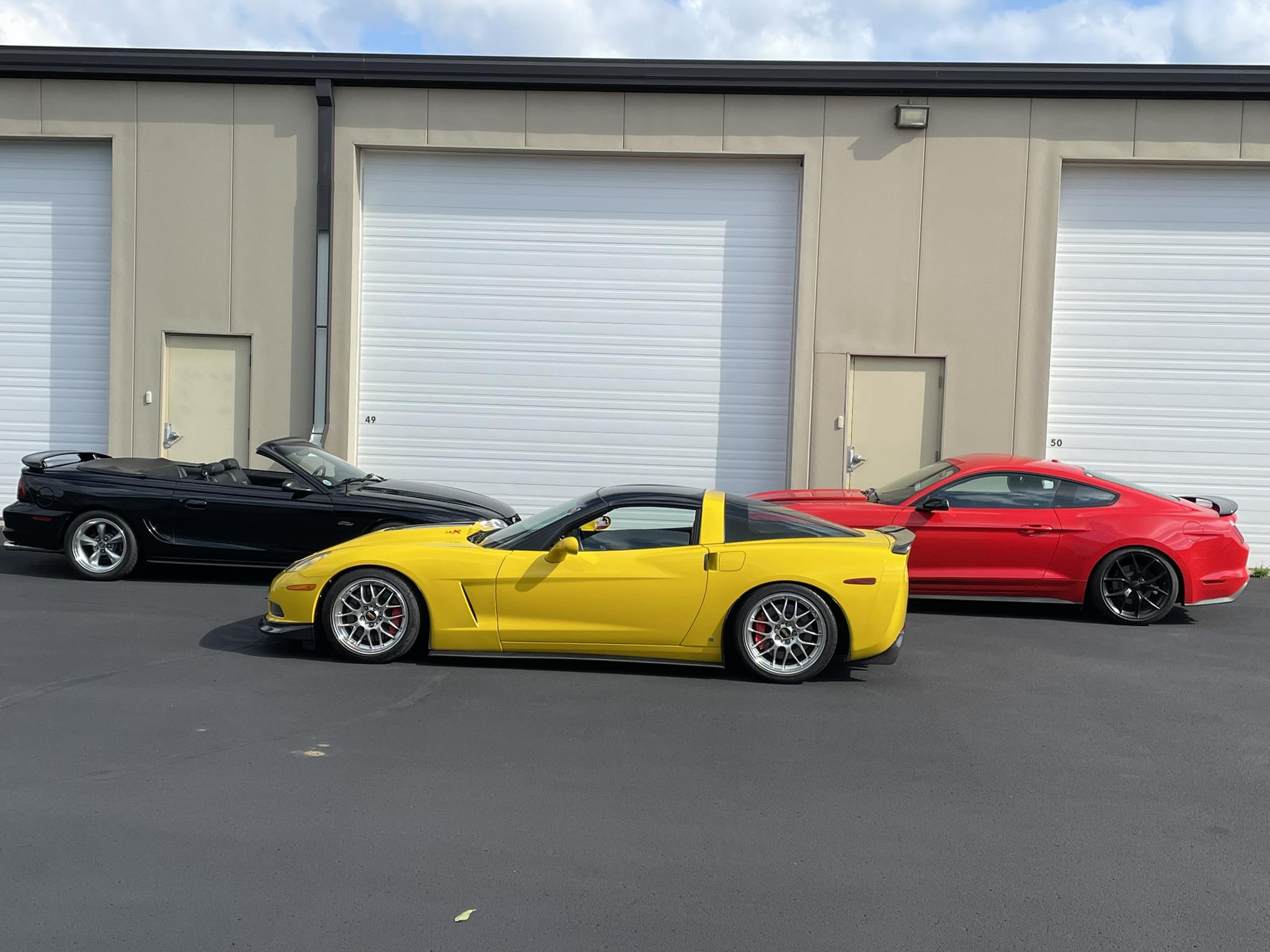

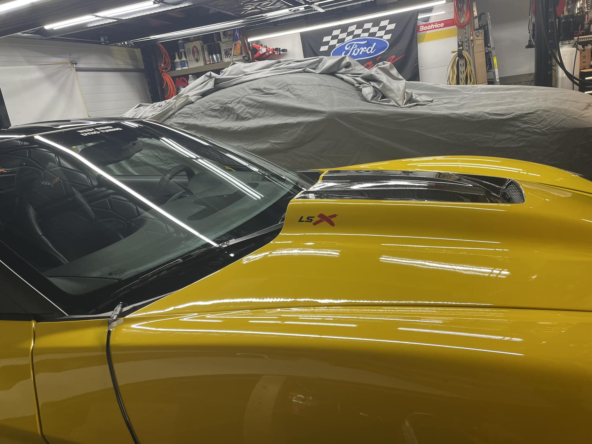

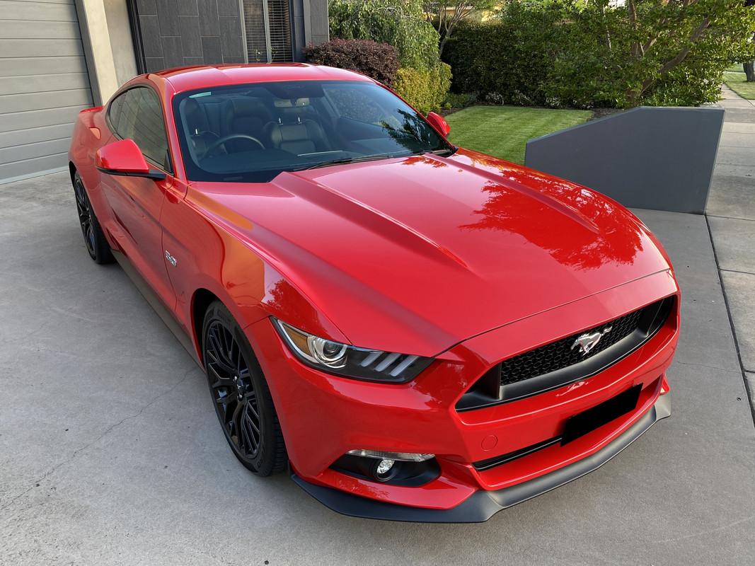

I am retired and have lots of free time. I use Turtle Wax "1 and Done" ceramic that has a light abrasive in it to help polish out the imperfections, then two days later apply their Max Graphene. Is it the best ceramic, no, but it is relatively easy to use. relatively cheap and my cars look great. I use a Milwaukee M18 orbital buffer to apply both products,
Just my opinion.
S650 Mustang Anyone use Top Coat F-11 Pro Polish and Sealer ? 1711468560436-wn
S650 Mustang Anyone use Top Coat F-11 Pro Polish and Sealer ? 1711468713465-ek
S650 Mustang Anyone use Top Coat F-11 Pro Polish and Sealer ? 1711468644297-gk
