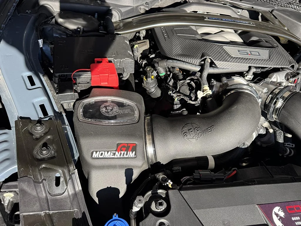

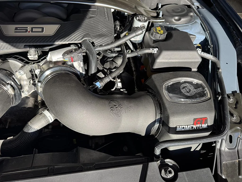

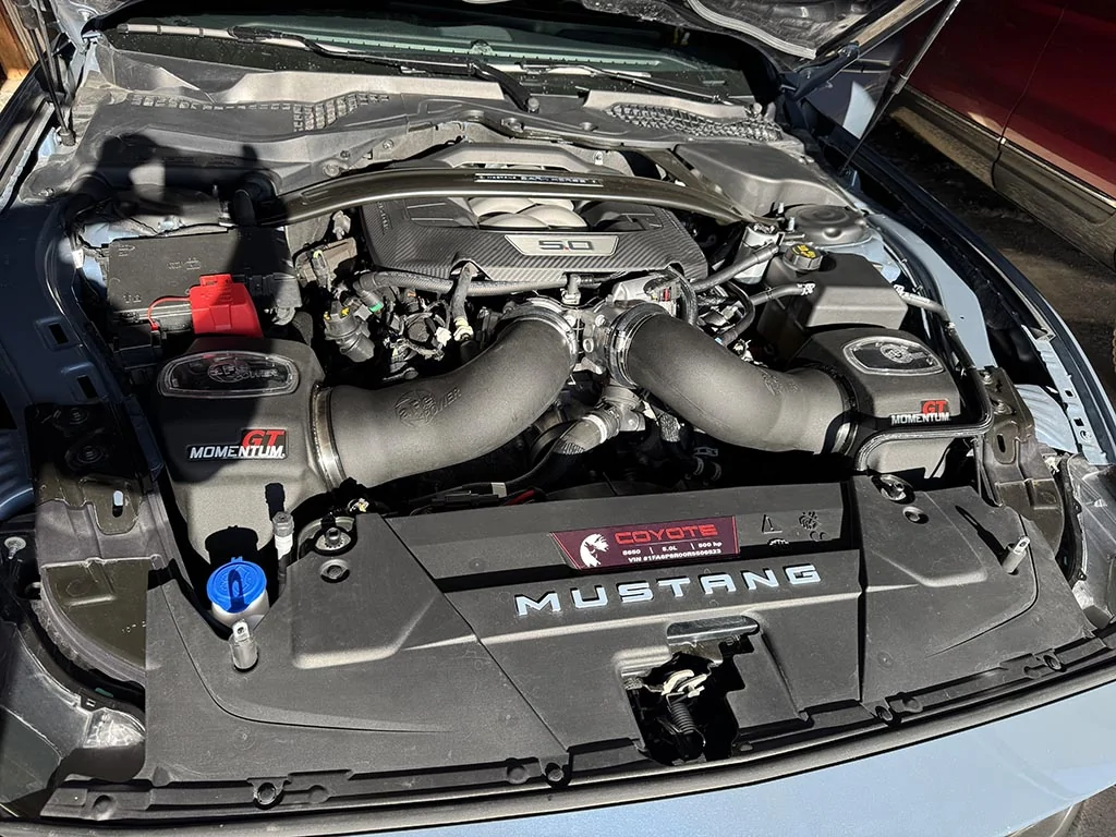

Just received my aFe Momentum GT CAI this afternoon and got it installed.
Total time to install was right around 30 to 40min and overall was pretty easy if you take a few minutes to watch aFe's installation video before going to work.
The kit included:
2 aFe Pro Dry S filters with clamps
2 complete airboxes
2 intake tubes
2 connectors for the intake tubes to throttle bodies
4 clamps for the aforementioned connectors
2 connectors for the airbox to factory grill intake vents
4 screws for the MAF sensors
2 factory style hose nipples
Overall, fitment was quite good and used the factory mounting locations and hardware for the airboxes themselves. The new airboxes are a single component each, unlike the factory 2 piece units, and have a window on top of them for viewing the filters. The right (passenger) side airbox was a bit more difficult to remove and install than the left (drivers) side due to the fuse box; but nothing a little extra force and a wiggle couldn't resolve.
The filters simply install into a large hole in the airbox and sort of snap in after being attached to the intake tubes, which appear to be made out of the same rigid plastic that the airboxes are.
The MAF sensors fit into the intake tubes rather snuggly, so much so that I wasn't sure they were actually going to go in. Be sure to use the new screws that come with the aFe kit for attaching the MAF sensors to the new intake tubes. Factory style hose nipples thread into the intake tubes and the factory hoses connect up with no modifications.
Quality of the materials all seemed pretty good and my only complaint would be how well the filters fit into the airbox. The fit could be a little tighter but will in no way affect filtration or operation since the filters connect directly to the intake tubes.
All in all, I'm quite pleased with this CAI despite the fact that it will make it a little more difficult to access the filters now, but personally I think it's one of the better looking ones out there.

Pretty nice, how do you access the air filters again? You have take the system apart to swap them out? The intake tubes do look beefy and looks to flow plenty of air. The air filters dont clamp on they sort of clip into place? That might bug me, id probably want them to clamp on. Let us know how they perform?
Yamazuki
Yamazuki
May 14, 2025
481
770
North Dakota, USA
The air filters clamp onto the intake tubes, then go into the airbox. They have a groove molded into them so that when they are put in place, they are held there by the airbox. It's similar in design to how the rubber grommets on top of the intake manifold hold the plastic engine cover on.
If the aFe airboxes had covers on them like the factory ones do, the covers could still be removed and have no impact on the filters ability to filter incoming air. Nor would removing the covers allow unfiltered air into the engine. The airboxes are really only there to support the filter, provide the filters with outside air from the grill vents, and prevent hot under hood air from being used by the engine.
As far as accessing the filters, yes, it is slightly more difficult than the factory design; but not incredibly terrible. Loosen the clamps for the intake tubes at the throttle bodies, unplug the MAF sensors, disconnect the breather hoses, and you can pull the entire intake tube and filter out as an assembly. Loosen the clamp on the filter and remove from the intake tube. It probably takes all of about 60 seconds per side and only requires a flat head screwdriver.
