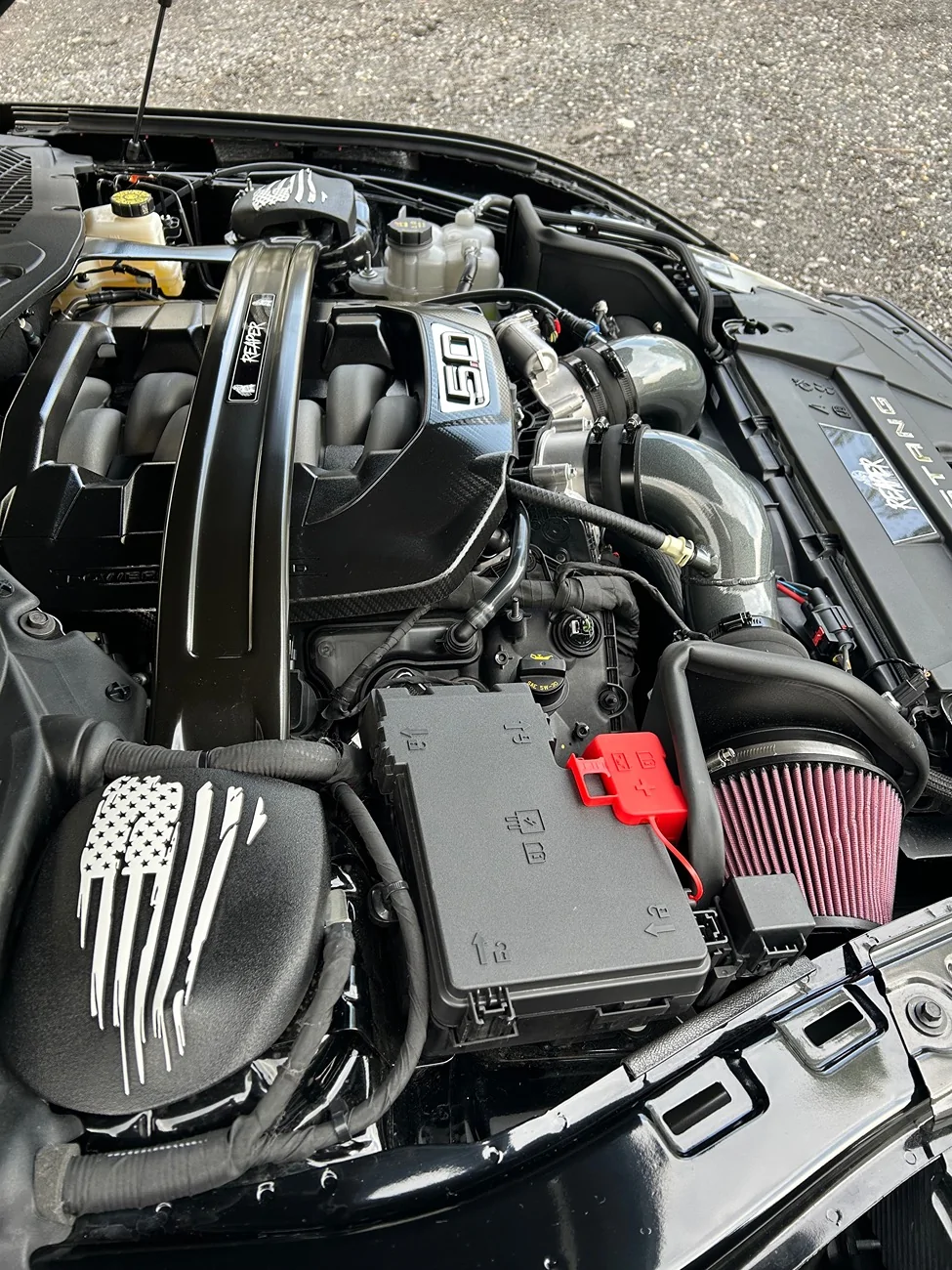

Looking into intakes and I need a general idea. I’m leaning toward Corsa but open to other suggestions.
As many have stated none of them really improve system performance. I decided to go with the k&n typhoon kit, something I find aesthetically pleasing. I’m sure it’s not everyone’s cup of tea but I like the way it turned out. But yeah I’m sure it made no difference performance wise
Those do look pleasing on the eye. And the bar across with the flags just sells the whole setup. But yeah I think I’m getting the idea on what to do now. Thank you for the pictures
