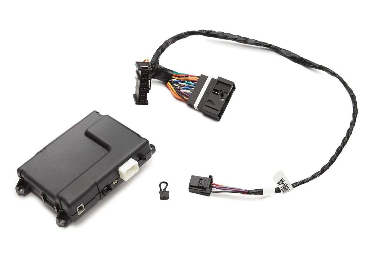

So looks like there's not many options left. How about the part below, anyone have any expierence with this?
Genuine Ford Vehicle Security System Remote Start Kit Ford Perimeter Plus For SYNC4
Part Number: ML3Z-19A361-A
I noticed it says Dealer programming required, is that accurate? Dealing with my local dealer is like pulling teeth, if I can avoid it that would be preferable

This was on mine. Possibly different frequency and also the car need the above module (mine had already the remote start via Ford app):
Just to make sure I understood correctly, did you have to install the perimeter plus security module on your car prior to getting the remote start to work?
I have a convertible which is supposed to have the security system installed, but I think this module adds to the existing system even on the security pkg cars, but I could be mistaken.
My big concern is getting it programmed to enable remote start after the install. Dealers around here seem to be a pain to deal with when it comes to stuff like this.
https://www.mustang7g.com/forums/threads/added-remote-start-keyfob-on-eu-s650.165197/
I don't know where he is from.
You have a European Mustang. It's having all the bells and whistles and almost the same option as the top trim USA Mustang. So if there are any module, harnesses or anything involved here, he might miss some important hardware.
Nope, having an EU one, I basically have all the features already.. that's why I said, you may miss the remote starting module.
