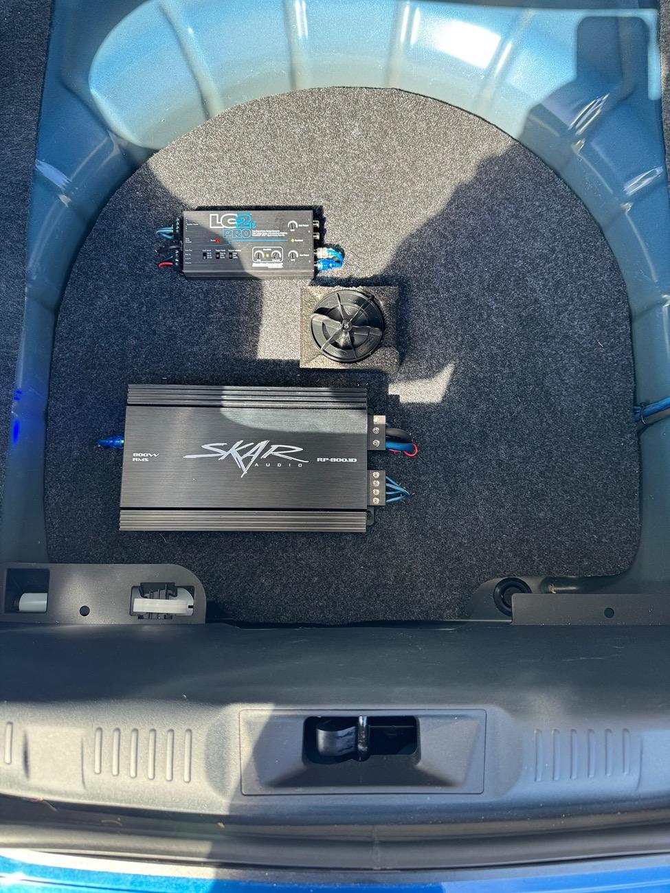

I did wrap mine in dynamat because I added an amp. At higher volumes you could hear the cracking sound of the enclosure flexing. Solved the problem. If you're not adding an amp it probably won't be necessary.
What did you use for the amp input signal?

Pretty sure he meant if you connected to the rear speakers or used the original sub wires.
I wonder if the sub wires still get their signal when no sub is connected to them.
Some cars check electronically if the speaker supposed to be connected works and if not turn off the signal for it.
Edit: Your install looks nice :thumbsup:

For that, I tapped off the subs wires.

so the LC2i is the only thing connected to the sub wires, right?

For the signal, yes. out of that to the amp and from the amp to the sub
