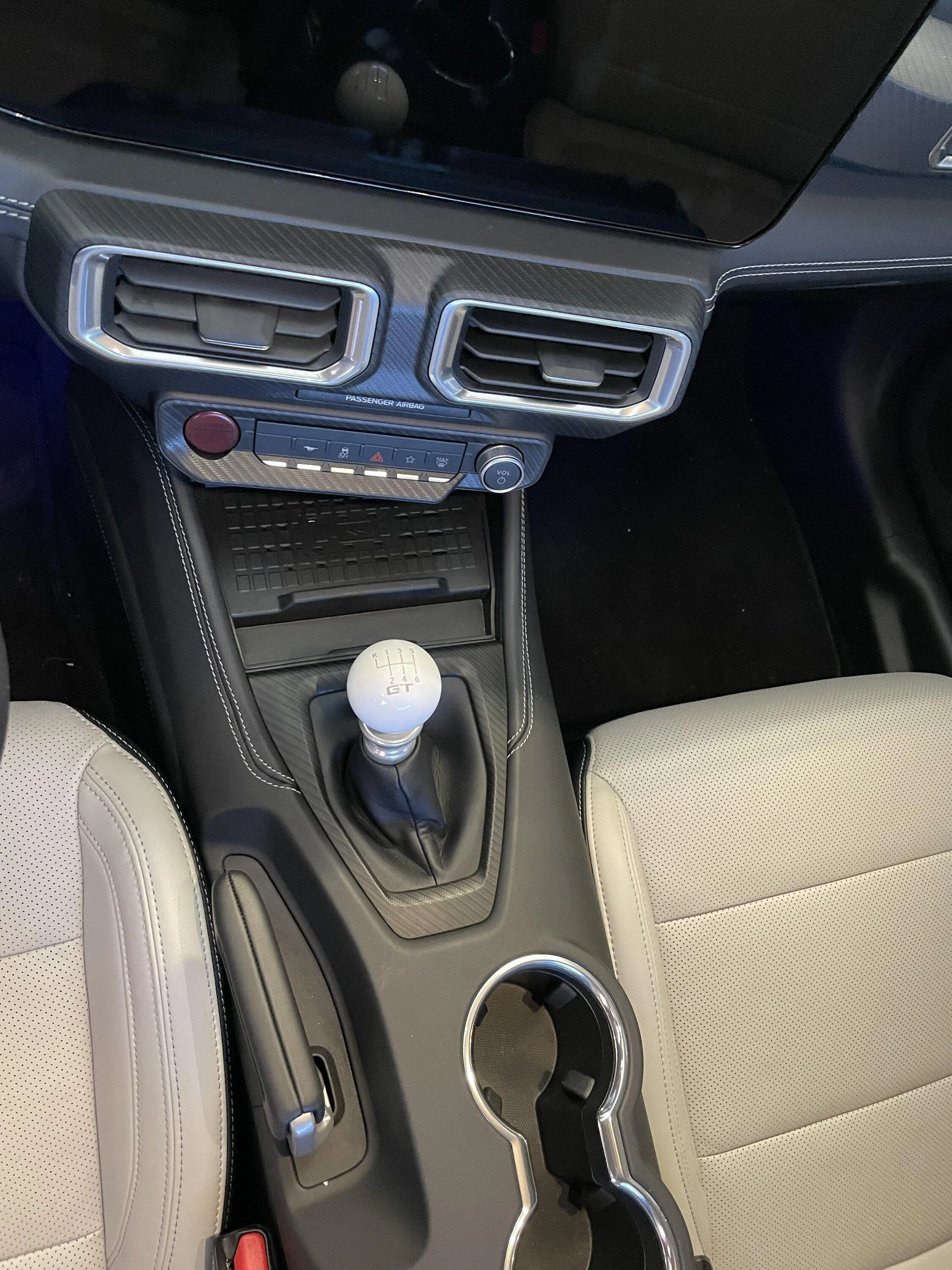

I have the Ford Performance Bullitt knob. It installs easily with a strap wrench.
I would not be worried about stripping it out unless you go full send like a gorilla. Just follow the instructions and you’ll be good to go.
S650 Mustang 6-Speed Manual Shift Knob replacement IMG_7794

GREAT!

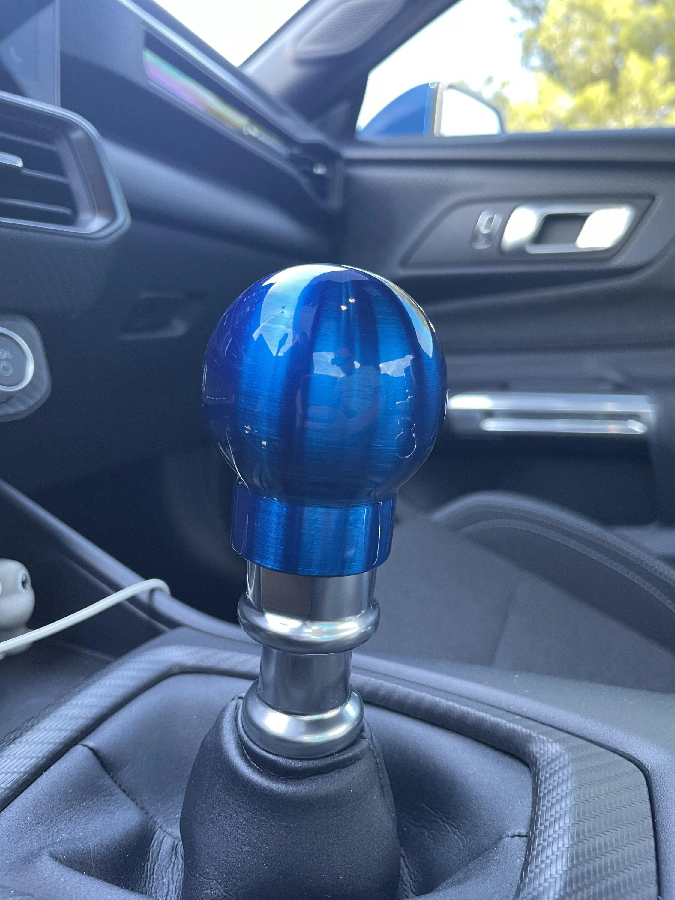

I got the round billetworkz knob and it works fine as long as you get their reverse lockout too. It was easy to install.
S650 Mustang 6-Speed Manual Shift Knob replacement IMG_8616

Did you have to use Blue Loctite to secure it?

No I didn’t, the instructions didn’t call for it. The knob is so tight that you would be hard pressed to move it without the strap wrench.
Here’s the Ford instructions

Instructions "picture" a strap wrench, but don't say to use it. Did the knob come with one and is it really needed to install?

In the third step illustration on the right it shows what tool to use 🙂.
It’s not included but I would say it’s necessary. They are really cheap. Mine was ~$10 at Lowes.
You will need something grippy so it doesn’t slip and also smooth so you don’t damage the knob. Best tool for that is a rubber strap wrench.
$6 at Harbor Freight. More than good enough to do this job.
https://www.harborfreight.com/rubber-strap-wrench-set-2-piece-69373.html
