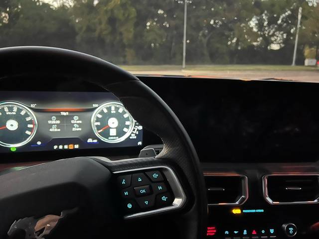

here are pics and video- again last night my right side wouldnt turn on, it came on about 5 mintutes into my drive
@Ford Motor Company
S650 Mustang 2024 gt mustang conv DASHBOARD wont turn on image1
S650 Mustang 2024 gt mustang conv DASHBOARD wont turn on image0 (4)

Maybe trim your commentary at the end but that should be enough to show the service advisor that yes, there is in fact a problem. Some dealers are sketchy on whether they will take a video as proof that there’s a problem - I’ve yet to hear a good answer on why they wouldn’t.
Get that car to the dealer so they can have a whack at fixing it.
Timry2
Apr 8, 2024
157
101
Fresno, Ca
2024 Mustang GT, Dark gray matter, 2020 F150 XLT Sport, magnetic
Your videos are enough proof, hit the dealer!

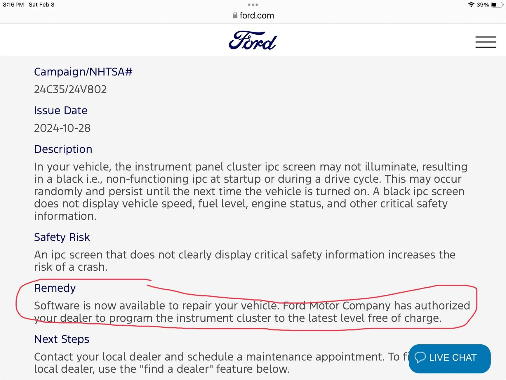

well it seems my issue actually created a recall, the recall which there is no software patch until estimated 1st quarter of 2025 doesnt exist yet...
Recalls *
Black instrument panel cluster ipc screen
Recall Incomplete, remedy not yet available
Campaign/NHTSA#
24C35/24V802
Issue Date
2024-10-28
Description
In your vehicle, the instrument panel cluster ipc screen may not illuminate, resulting in a black i.e., non-functioning ipc at startup or during a drive cycle. This may occur randomly and persist until the next time the vehicle is turned on. A black ipc screen does not display vehicle speed, fuel level, engine status, and other critical safety information.
Safety Risk
An ipc screen that does not clearly display critical safety information increases the risk of a crash.
Remedy
Software is not available. Ford Motor Company is working to provide software for this repair. When the remedy becomes available, Ford Motor Company will notify you via mail to schedule a service appointment with your dealer for repairs to be completed free of charge. The remedy is anticipated to be available 1ST quarter 2025.
Next Steps
Contact your local dealer and schedule a maintenance appointment. To find your local dealer, use the "find a dealer" feature below.
