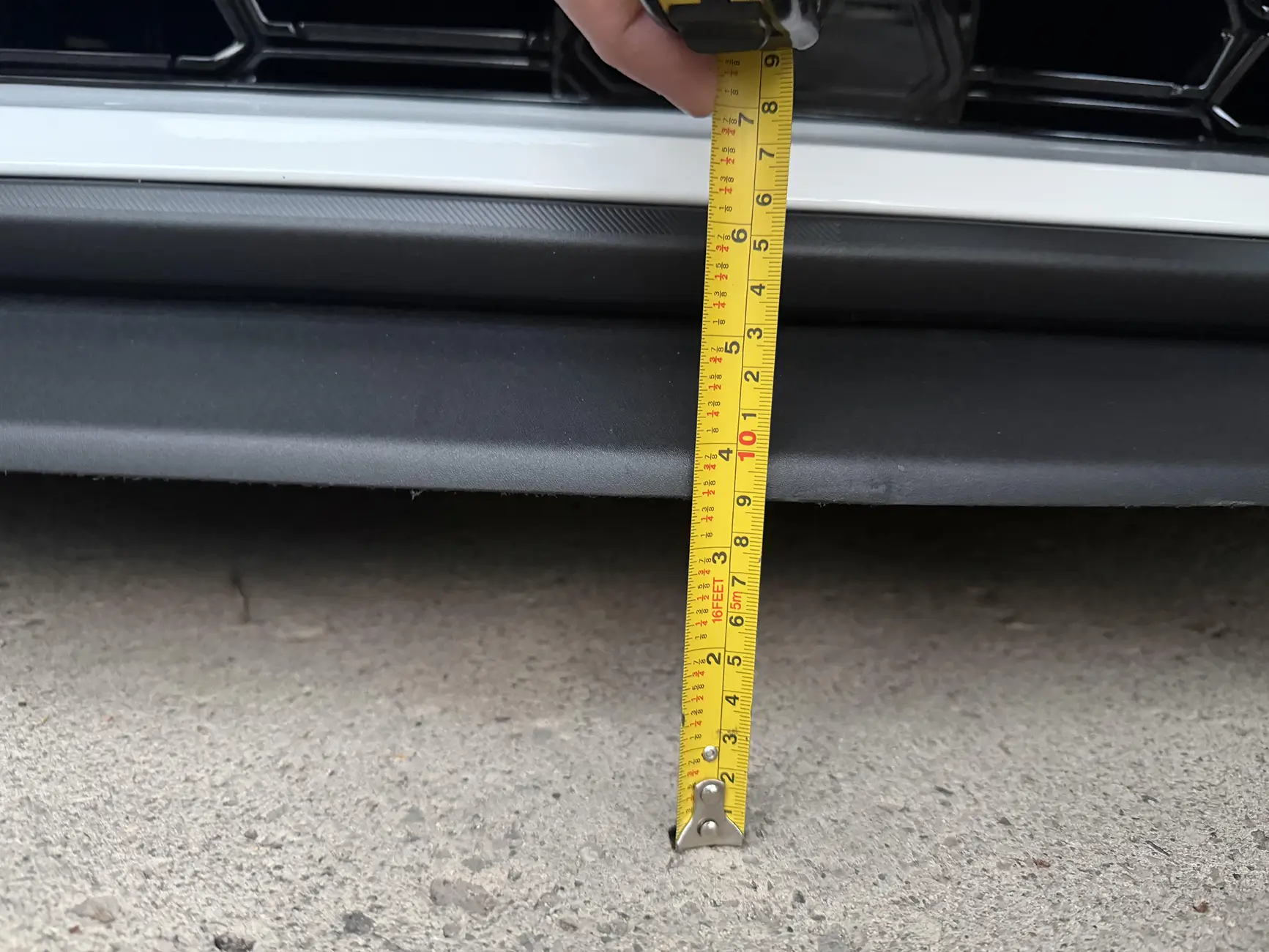

Wow your car is looking great. Where are you measuring your height from? My DH HP sit's at 4 inch's at the center of the front splitter.
Thanks! Now that I am running a detailing product company it's pretty easy to keep the car looking shiny and new LOL I carry all the products I use on my own car with the exception of one (Brake Buster). As for where I measured; I think that may have been from an edge. Here is from EXACTLY centre.

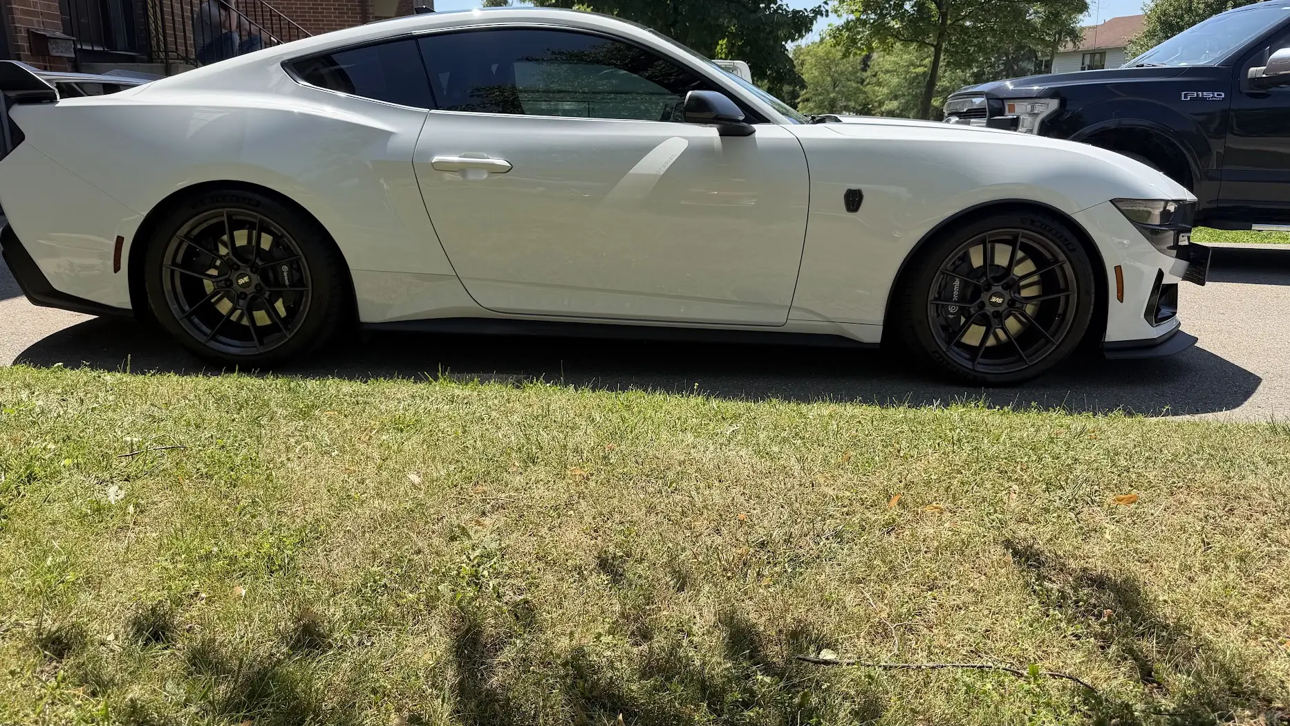

Ordered a set of LMR Smoked Sidemarkers w/startup sequence Amber (Front) and Red (Rear) as those are legal here in Ontario.
