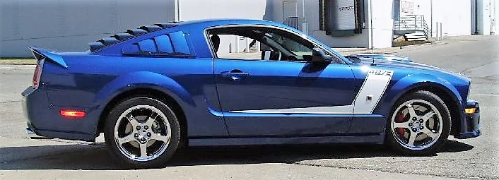

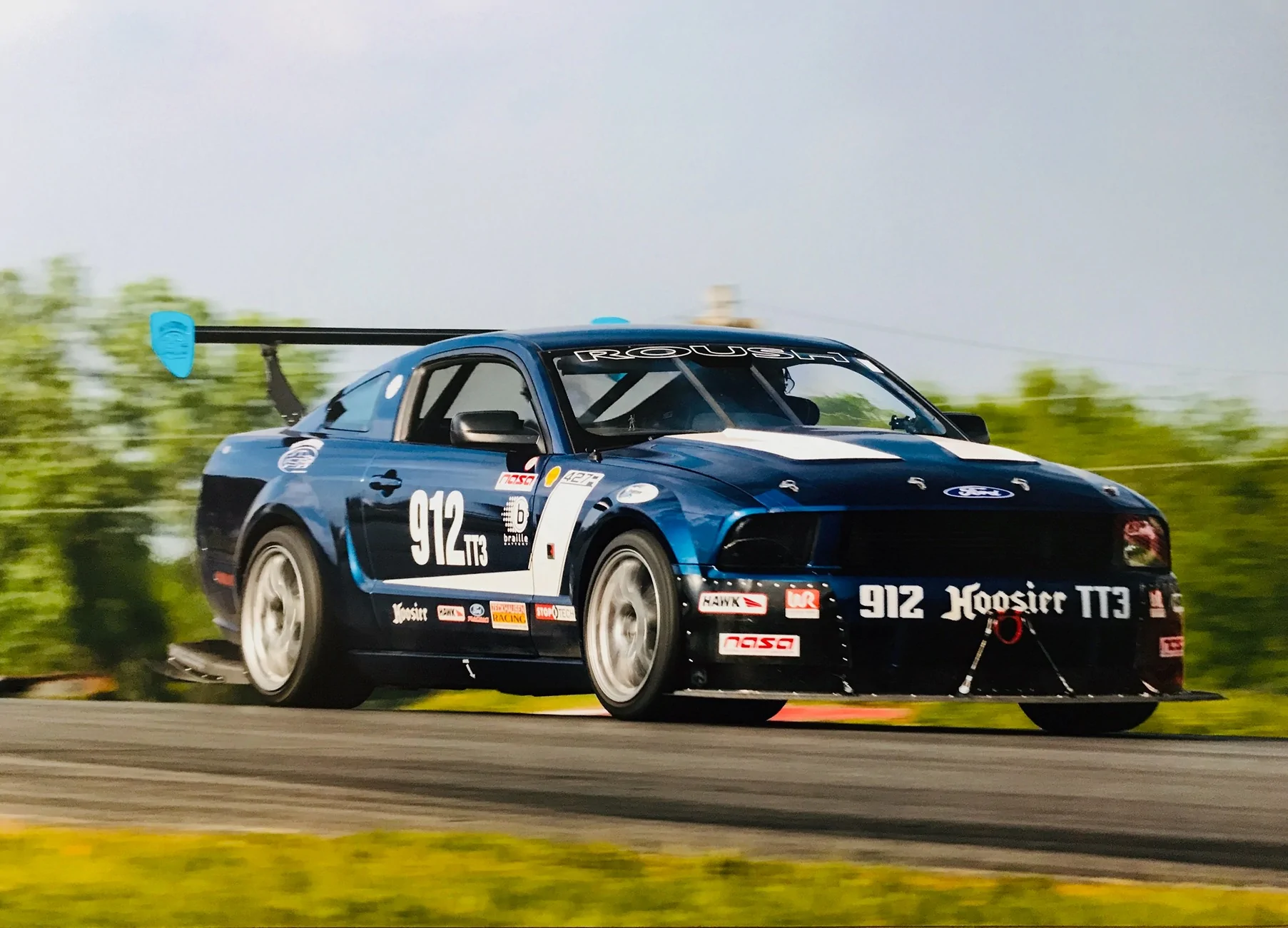

Back in 2008 I participated in my first road race event at Waterford Hills in MI part of a Roush Owners weekend Get-Together. In 2009 I joined NASA and spent 12 years with them. Pic on top was my car brand new in 2007, pic on bottom was what it became by 2012.
