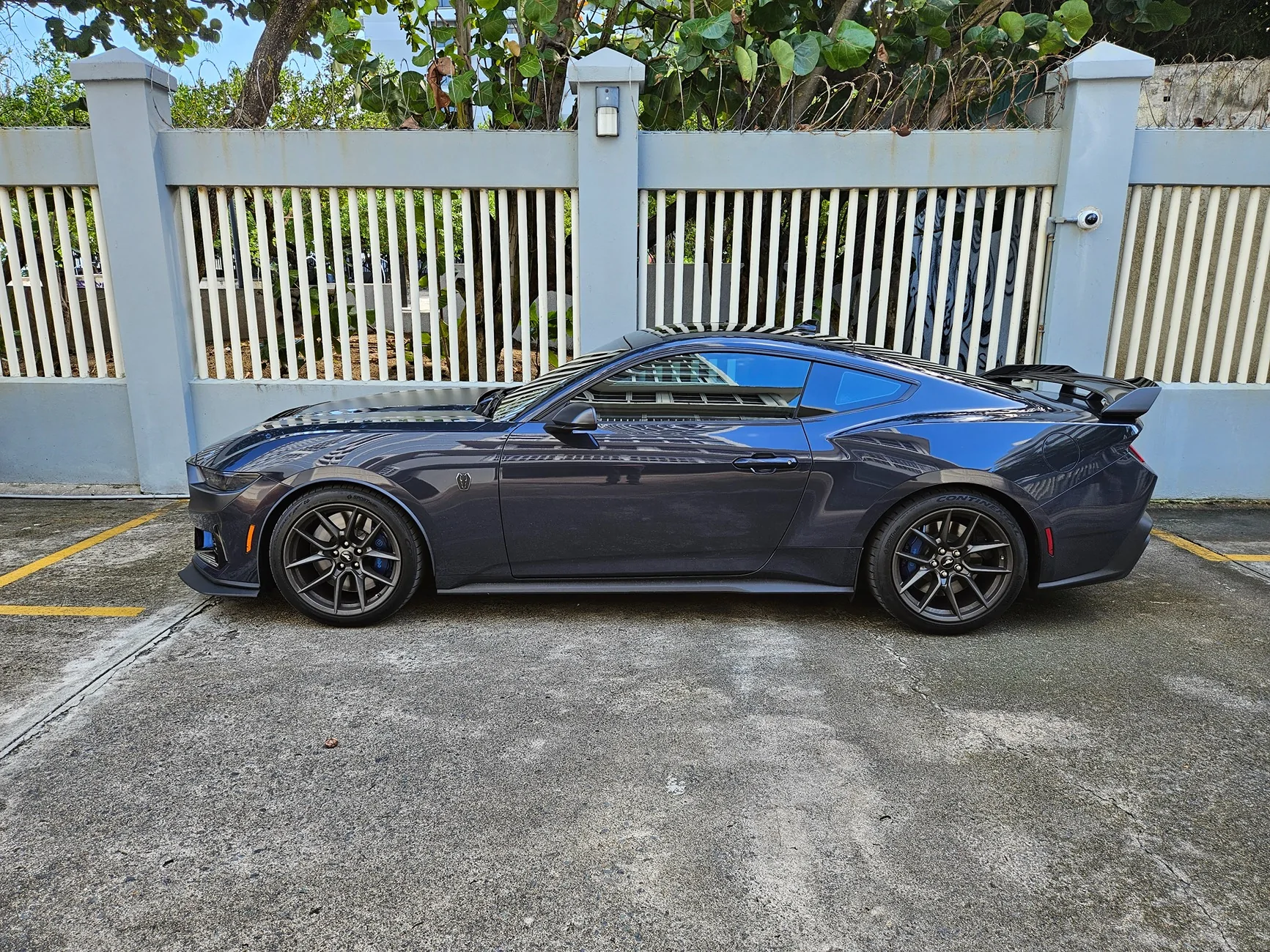

Contis ECS2 285/35/19 front and 295/35/19 rear. Conti now also does 305/35/19.
Replaced the Trofeos at 300 miles and keeping them as future track dedicated tires. Very happy with the Contis. Curretly 7k miles on them. No tramlining, great response, grip, noise. Just excellent street tires.
PS4S are also excellent but have limited 35 profile size options.
