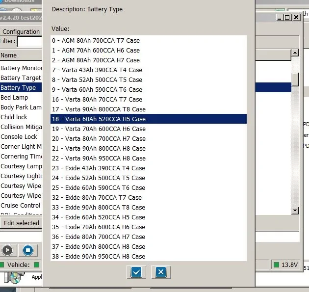

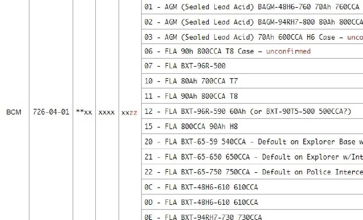

Apparently, lithium batteries are not recommended on cars with smart charging and a BMS system... our S650's. The smart charge strategy for an AGM battery will not sufficiently charge a lithium battery.
1,768
2,778
≈39N
☝ This.
With no Lithium strategy, installing one of these units is not in your best interest.
S650 Mustang Kelltrac S550 / S650 Mustang Lightweight Lithium Battery Kit. battery options bcm 000
S650 Mustang Kelltrac S550 / S650 Mustang Lightweight Lithium Battery Kit. battery options bcm 001

is this Lithium Ion (Li-Ion) or Lithium Iron Phosphate (LiFePO4)? because i would highly advise against putting a Li-Ion battery in a car. LiFePO4 is much safer and is more durable over charge cycles, even if it's not quite as energy dense. but even then, it would be best for racing purposes only, as the charging system in these cars is designed for the factory AGM ones
☝ This.
