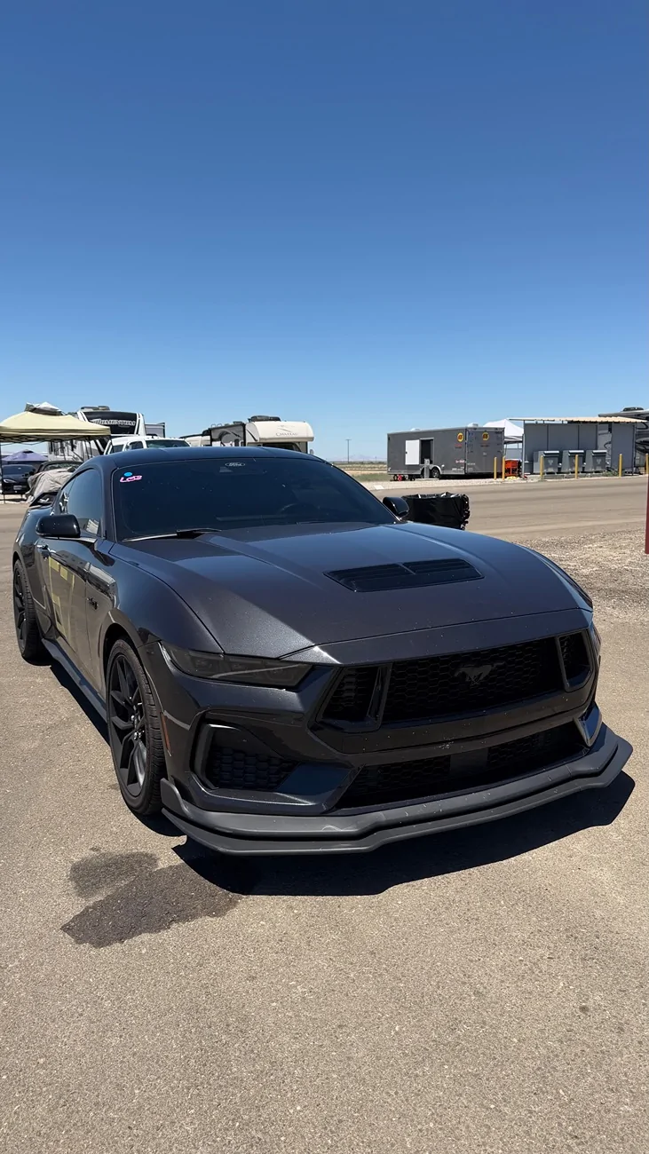

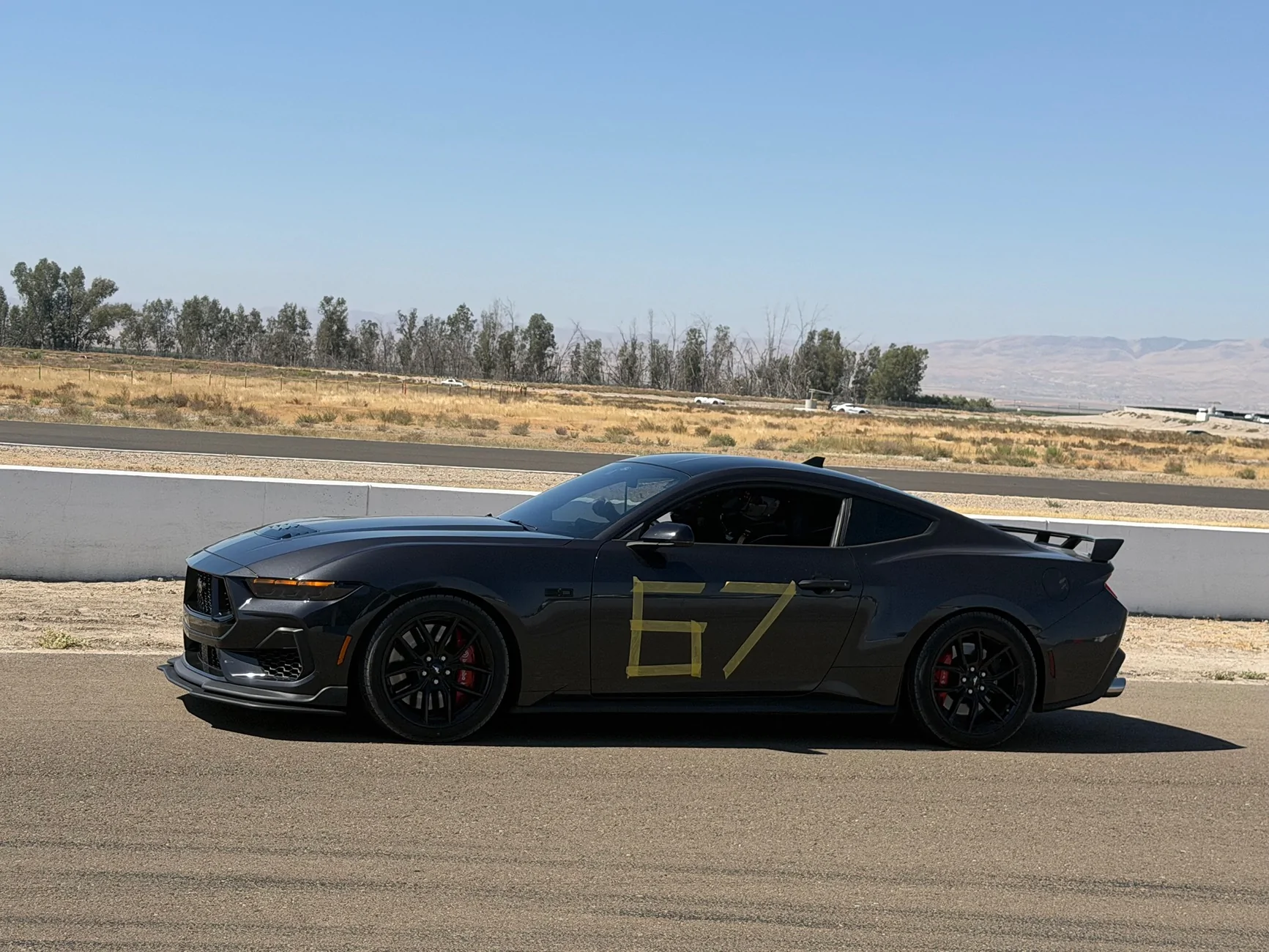

I wanted to make this post to talk about my recent track weekend at the Buttonwillow Circuit track, as well as discussing future steps for my car to make it better on track.
This was an event hosted by NASA. This was my second ever NASA event and second event track event. They are an awesome organizer and I had a lot of fun learning the track. I was in HPDE1 with an instructor for the first day and most of the second day. Luckily during the last 2 sessions we had a double and my instructor gave me the go ahead to ride solo. We ran a double session where we run a session, go back to grid while HPDE3 and 4 do their thing, and immediately after we go back. At the end I was promoted to HPDE2!
The circuit track was definitely fun to learn and there was a steep learning curve as Intook turn 8 a bit too fast and went off track my very first session. But immediately afterwards I got the hang of the track pretty well. Once again thanks a lot to NASA for hosting this event. It was very structured and fun to attend once again. I do have plans to return to Buttonwillow to take on their Classic track in October.
Next I want to talk about my cars performance. My car is a non-pp GT, meaning it had completely inadequate cooling for the track. Luckily I had some cooling mods installed before I took on the track. I had the OEM PP transmission cooler and the MMR oil cooler. I also had an aftermarket oil temp gauge installed to track my oil temps. My tuner also tuned my car to force my grille shutters open and to give me the DH oil temp algorithm to prevent limp mod. I also have the PP undertray and fender liners to give airflow for my oil cooler and my front brakes. I also swapped out to Powerstop Z26 pads on the front and rear. Car comes with the 6 piston front brembos from factory. I was really pushing my car this weekend much to the dismay of my all season 255s. Here are my temps near the end of my second day, peak temps I saw on track.
Ambient Temp: 110 F
CHT: 250 F
Oil: 284 F
Transmission: 226 F
Axle: 293 F
Despite these high temps I was still able to make the most of my car and got a very good handle on the track, leading to my promotion to HPDE2. I do plan to install the DH Rad and Fan combo to lower my CHTs, and I do hope that has some effect on my oil and transmission. As for my axle I might wrap a bit of exhaust wrap around the area near the axle and see what that does for my temps.

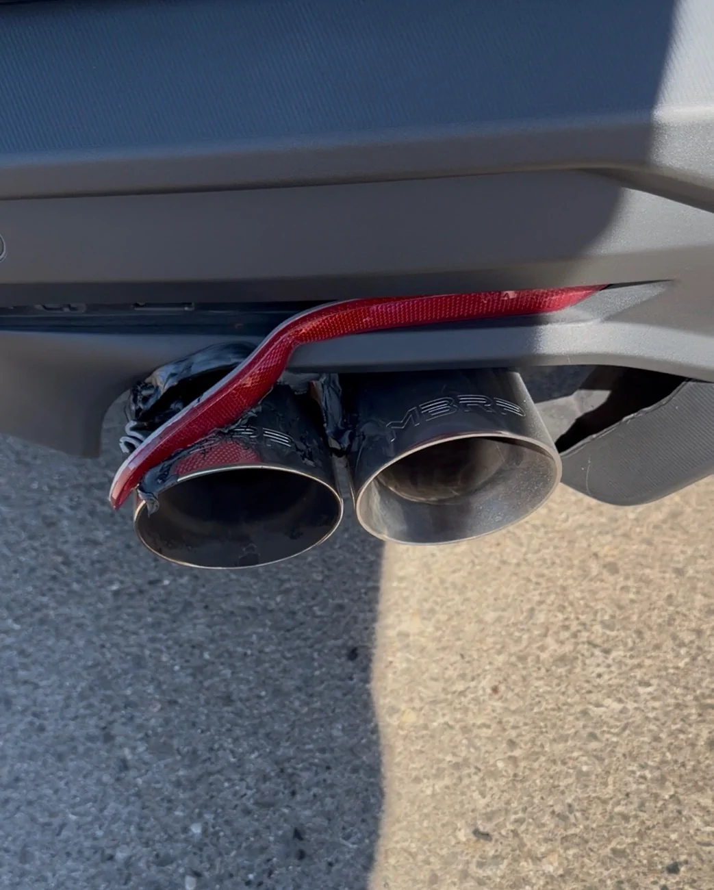

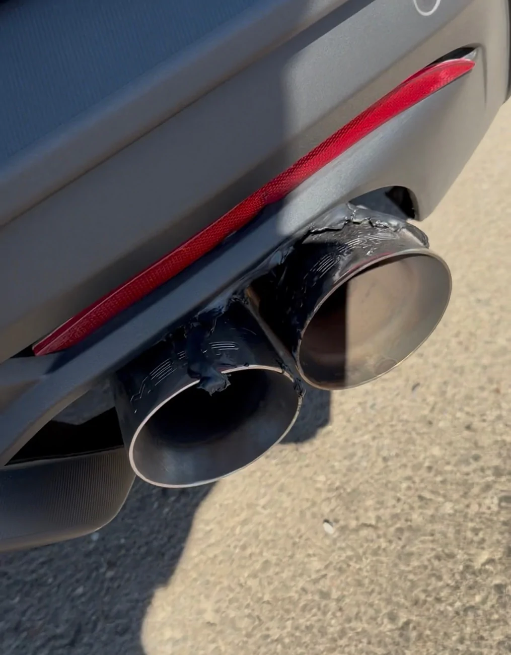

On an extra note I did end up melting my rear valance after my last session on the second day. I do have a DH valance and new rear reflectors on order (photos of the melting will be attached and some nice flybys on the main straight away). Also once my car got pretty hot I would notice if I tried flooring it on the straight away my car would kind of 2 step at 6500 RPM and stop me from further accelerating unless I let off the throttle and floored it again.If you have any recommendations for cooling or track tips please let me know, all advice is welcome!

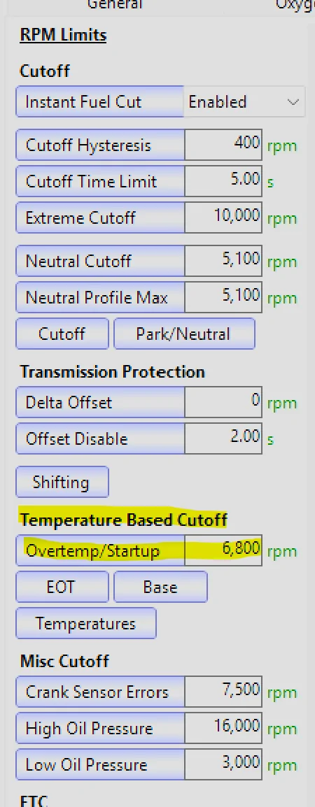

The 6500ish rev limiter was the temp based cutoff limiter. Its actually at 6800. Its a fuel cut limiter.

I had a feeling, it did sound like the factory rev limiter whenever you’re in park or neutral. Do you know what parameters it uses to determine the cutoff? I was able to run the car even hotter. Car was reading max at around 294F oil temp (in reality the oil temp through my actual gauge was 282).

This bad boy right here.

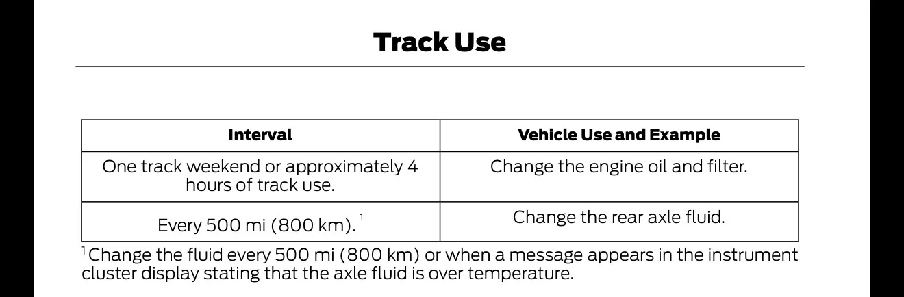

I plan to do my oil changes after every track weekend. As stated by the ford service manual. I am also considering changing out my diff fluid because I did get it to a toasty 293.

I'm glad you posted. I was thinking I had read about the frequent oil changes somewhere else. I forgot it was stated in the S650 manual. Running full synthetic I usually will go 3-4 track days before changing the oil. It just depends on the timing and how much time I spend on track each day. I'm changing the oil today after two track days because I'm heading off for several back to back events. I will have a total of 6 track days while out this time and I intend to change the oil after day 3. I haven't decided if I will bring the drain pan to do the oil change myself in the paddock or if I will bring the oil and filter, then take it to a local shop to have them perform the labor.
