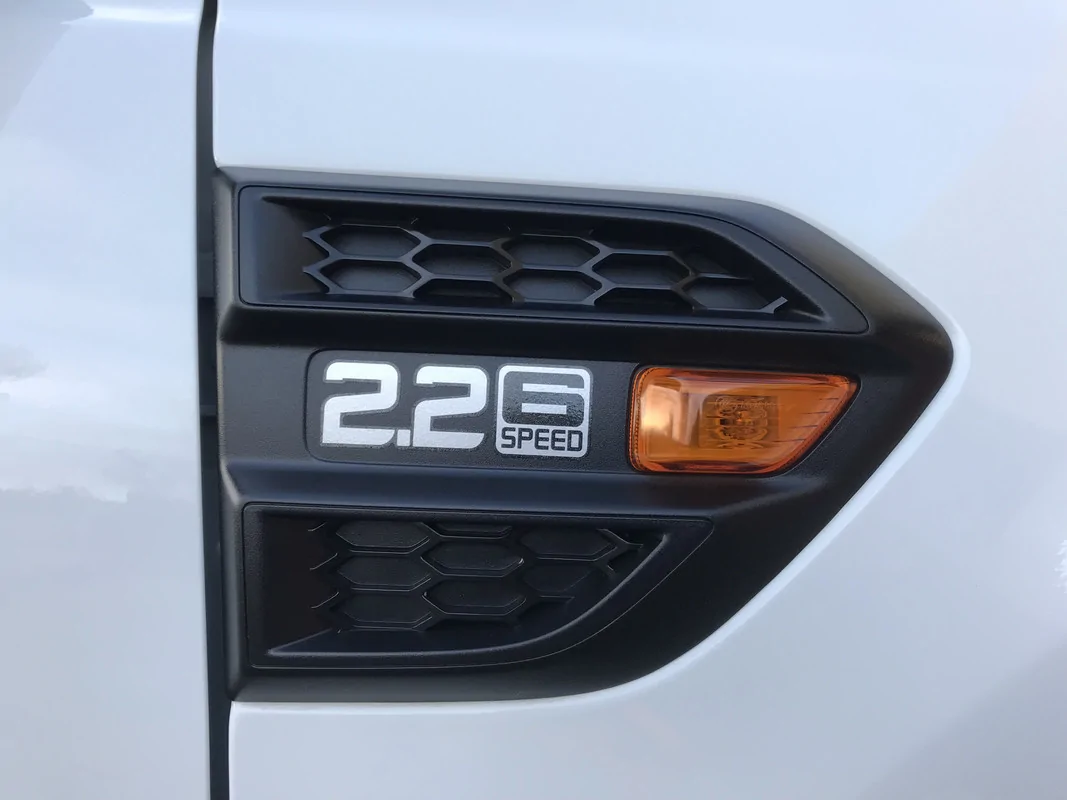

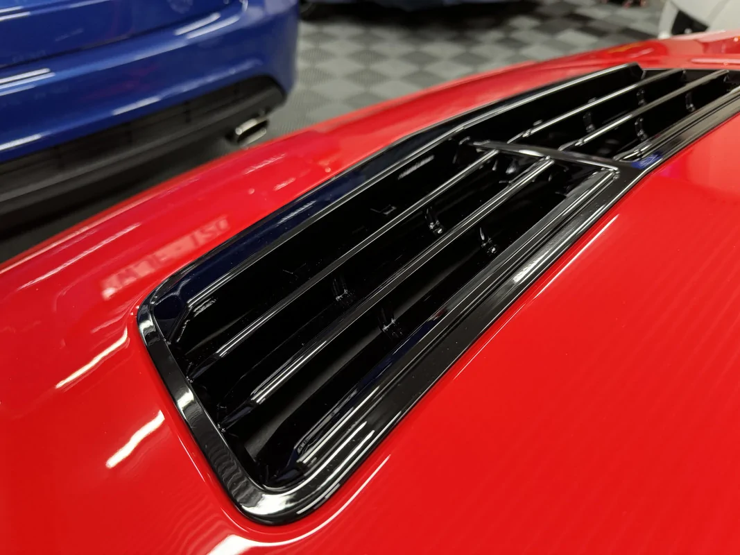

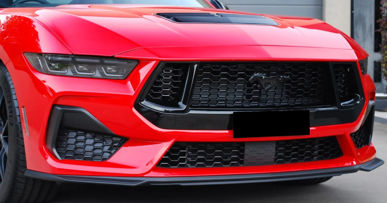

Gloss Black Trim - These materials have become widely used over the last decade as a substitute for chrome, usually as window trims, B-pillar trims, diffuser panels, hood and fender vents, wing mirrors and bumper accents. In simple terms, you are treating these areas as you would paint, so they can be polished and protected in the similar ways.

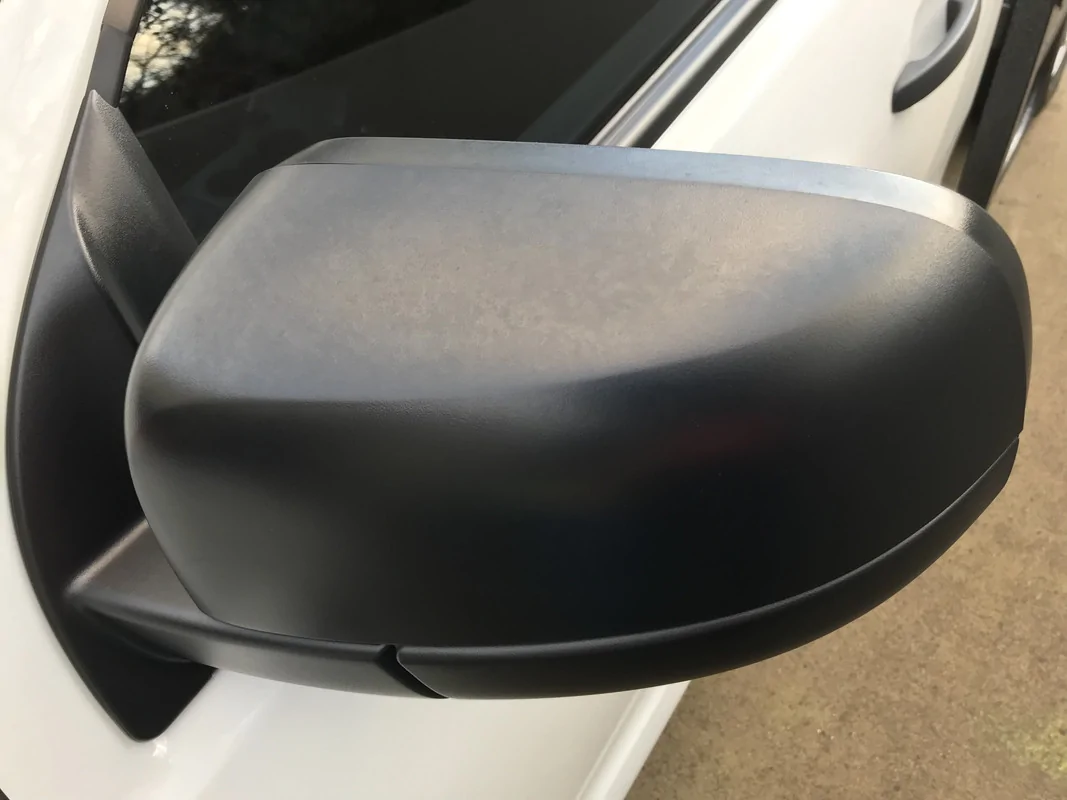

Un-painted Black Plastic – This trim is used as an accent or body extension, think wheel arch flairs, bumper inserts, side skirts and splitters, windscreen scuttle panels, door handles, B-pillar trims, fender vents, and wing mirrors. These materials can be smooth or textured plastic and require very different methods to restore and protect.

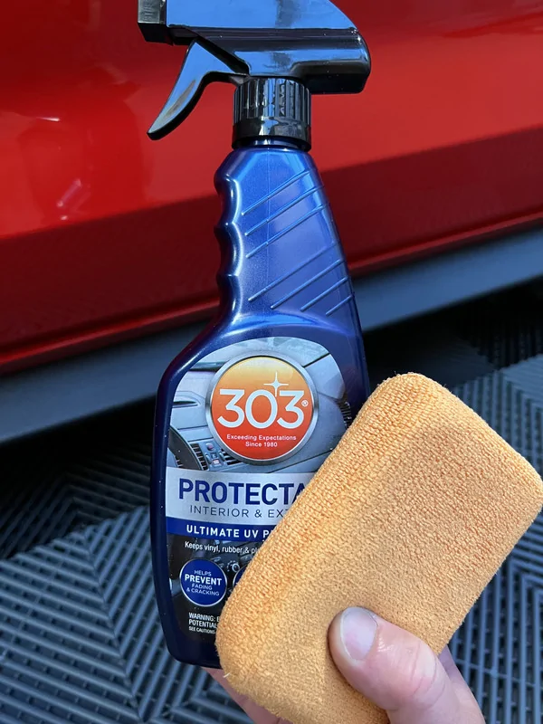

Rubber & Plastic Dressings – These products are water-based dressings that can be used on plastic, vinyl and rubber surfaces inside and outside the vehicle. They require the least preparation and skill to apply, but to get proper UV protection, you need to apply them regularly. Being water based, this means they will degrade quickly when washed or exposed to rain. That’s not to say don’t use them, but just be realistic in what they can achieve and be prepared to apply them after each wash.
Application - Dressings can be applied with microfiber towels or applicators, or even foam blocks.
Product Suggestions – 303 Protectant, Carpro Perl, Meguiar’s Hyper Dressing and Koch Chemie PSS
Longevity – Days

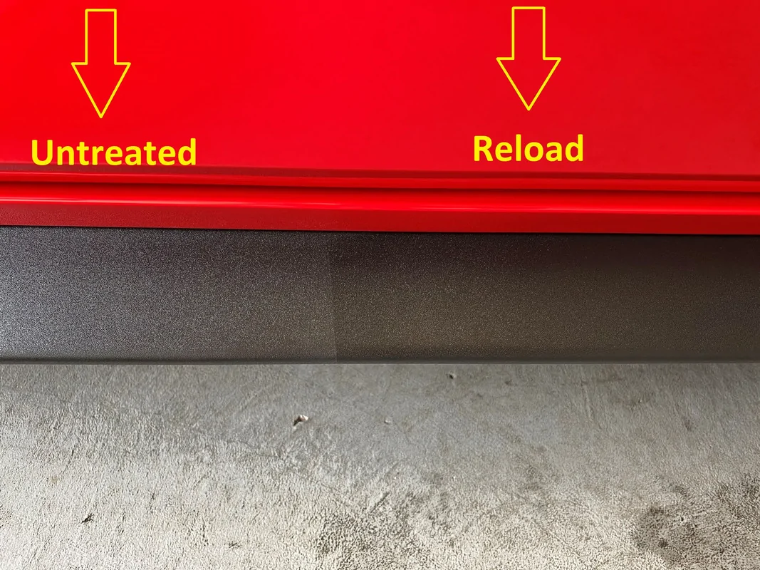

Spray Sealants – This may not be an obvious choice, but from experience, I’ve found spray sealants to be a very attractive option here. They are just as easy to apply as a dressing, but much less messy in terms of getting it on surrounding paintwork or glass. And because the product bonds to the plastic, it won’t simply wash off in the rain or next wash. That means you can apply it every few months, rather than every few days. I also appreciate the subtle enhancement a sealant provides, a deep and dark appearance without looking like an oil slick.
Application – A microfiber towel or applicator is best here, apply heavy and lightly buff afterwards.
Product Suggestions – Something like Bead Maker or Obsessed Garage Drying Aid are nice for trim, but Carpro Reload is THE winner here. The specific oil/solvent used in Reload is what provides that deep-dark look, while the high Si02 content locks it in and provides UV protection. If you are on the fence, just buy the small 100ml bottle and try it out.
Longevity – Months

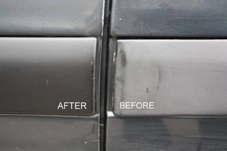

This is where we are trying to reverse the damage already caused by exposure to UV. As per the previous category, you have a few options. In broad terms, the products are the same as above, but their effectiveness will depend on how badly degraded the trim is, and how long you want it to last.
Note – In some cases, a heat gun can be used to bring oils to the surface of the plastic, restoring that black finish. However, do so at your own risk, not all plastics will respond to this method.
Rubber & Plastic Dressings – As per the previous section, a water-based dressing will provide a short-term improvement and will require frequent re-applications. In some cases, I have seen where a dressing won’t actually make an improvement, so it's very dependant of the plastic used by the manufacturer.

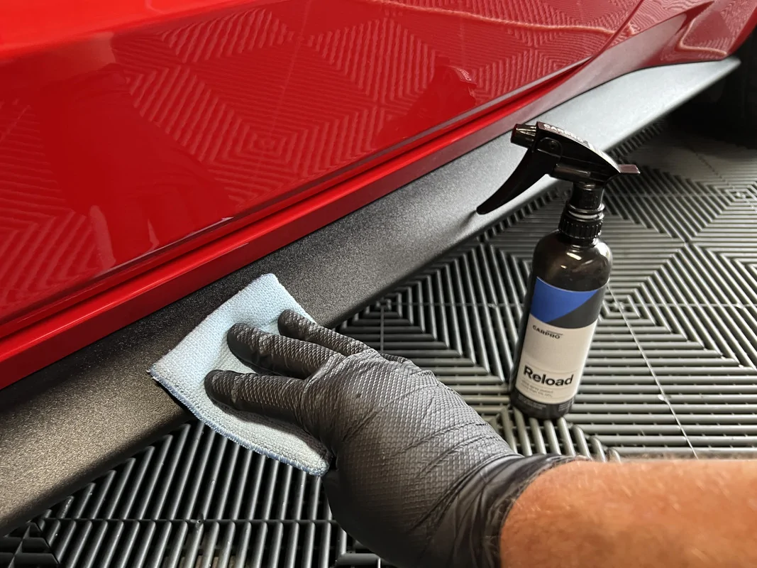

For trim protection, I tend to prefer the use of a spray sealant, Reload in particular. This provides a nice balance between safety, longevity, ease of application and the look I’m going for, ie a natural factory look.

Thanks for recommending Reload, it’s a great product. I used it on unpainted plastic as recommended: chin splitter, corner grills, side skirts, window trim, rear bumper/ diffuser, and mirror plastic, they look clean and protected without looking overly glossy/ shiny. Is it ok to use Reload on my rear ducktail spoiler bc the plastic is painted satin black?

You can use Reload on pretty much any surface, from paint to carbon fibre, wheels, glass, trim. On satin surfaces, it will add richness to the finish rather than turning it glossy.

Reload is good stuff. I got a bottle last year after reading this. I like that it lasts up to 4 months. No need to re-do your trim after every wash.

And that's why I like it for trim, it will last but doesn't come with potential side effects. Dressings are instant gratification but disappear at the next wash or rain. Ceramic coatings certainly last, but there is risk involved that can't be undid, and it locks you out of future revival.
