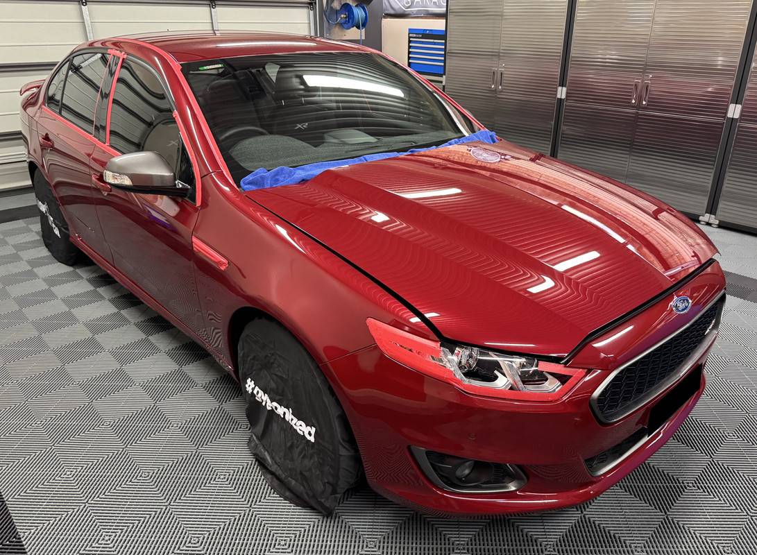

Edge Protection – When polishing panels with an adjacent edge, its good practice to protect that edge to reduce the risk of burning through the clearcoat on these vulnerable areas. This can be done with tape, or by propping an opening panel with a folded towel.

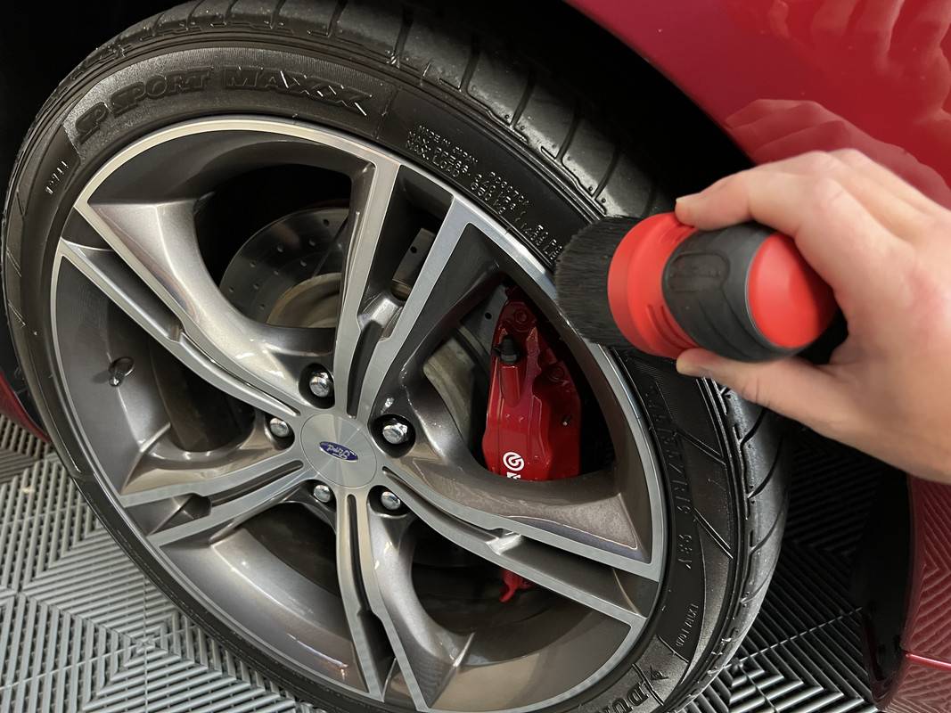

I almost always use a brush to dress tyres now. Not only is it cleaner, but I also find a brush quicker and easier. The XL sized Maxshine brushes are brilliant for this, and if you have large pickup or SUV tyres, a soft wheel face brush is absolutely brilliant! Brushes can also be cleaned as required and won't require frequent replacement like foam or microfiber.

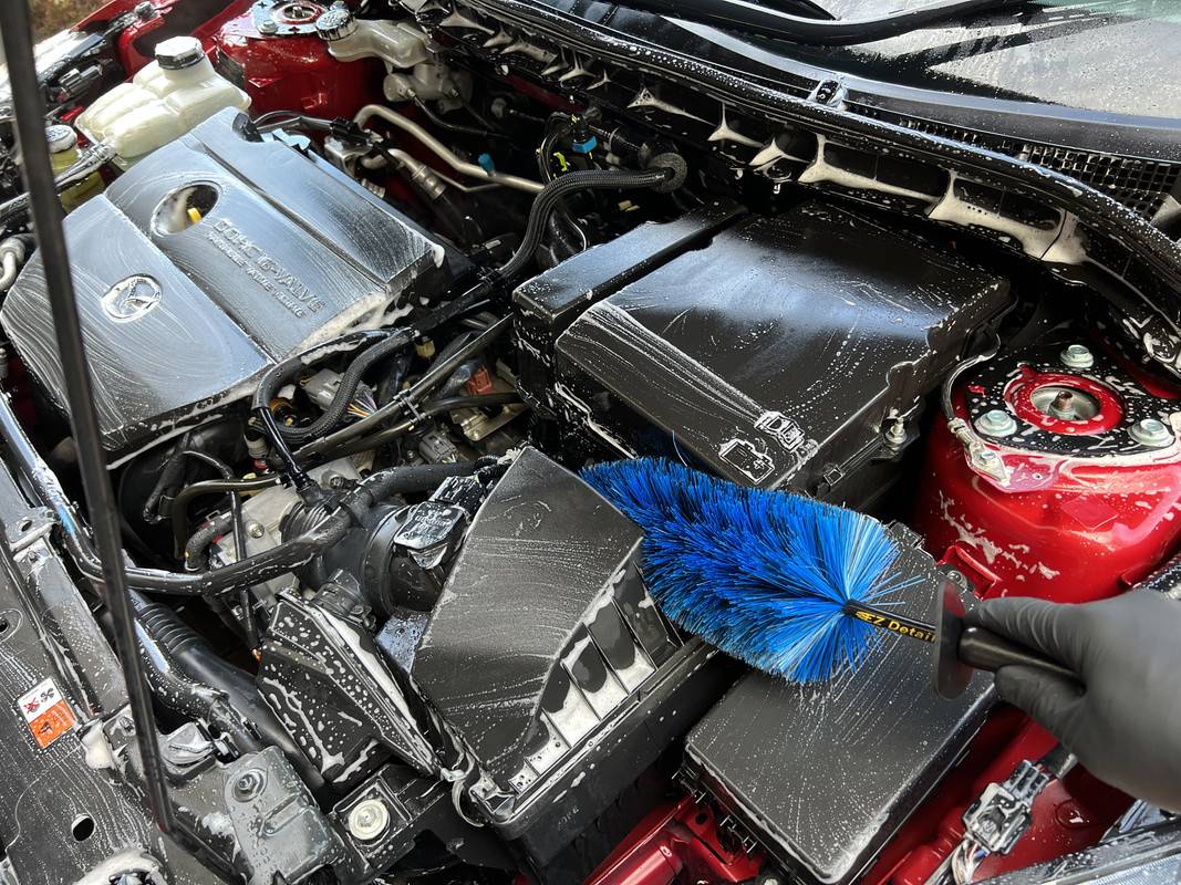

Engine Bay Cleaning – The EZ-Detail brushes were originally designed for cleaning wheels with limited access. However, that same attribute makes them ideal for engine bay cleaning as well, allowing you to easily clean between hoses, intake parts, wiring looms, the scuttle panel……….or anywhere a normal brush won’t fit or be effective.

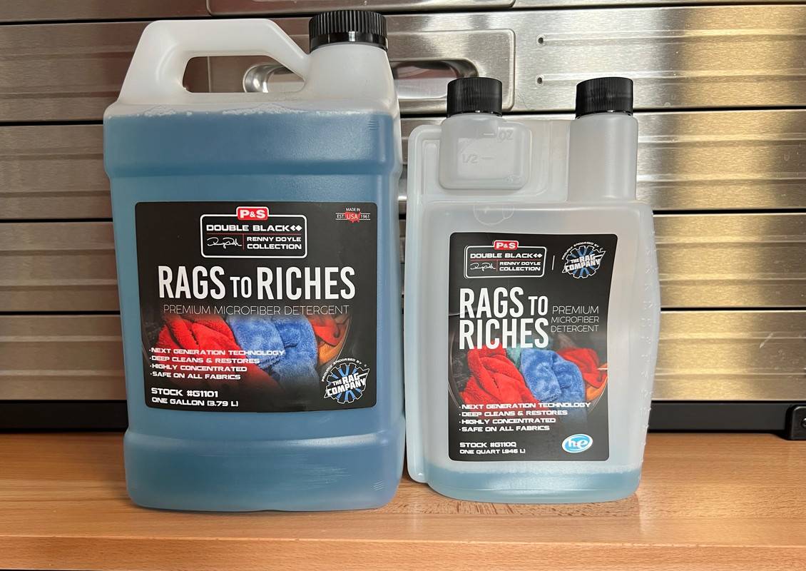

Microfiber Detergent – Always use a dedicated microfiber detergent to properly remove modern detailing chemicals, in turn extending the life of your towels. I know it might seem like a needless cash grab, but towels are what touch your paint, you want them in the best condition possible. Once I switched to a dedicated detergent, I noticed a significant improvement in towel softness and performance, to the point where it revived towels on the brink of replacement.

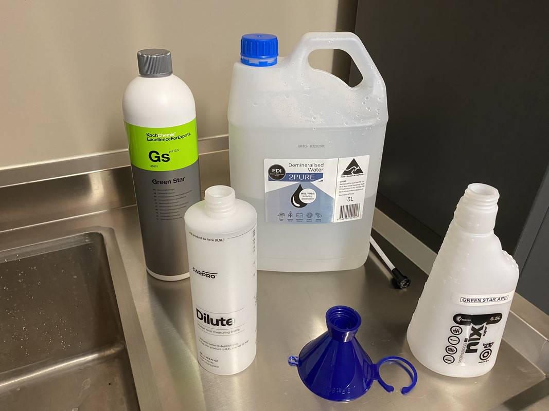

Dilutions – If you struggle with dilutions, the Carpro Dilute bottle comes in both 500 and 1000ml versions to make this task simple. While you can use these as a spray bottle, for me they are purely for measuring out the correct ratio of water to chemical, then emptied into a double action sprayer. Simply fill with water to the ratio line marking, then top off with the chemical. Otherwise, there are dilution ratio calculators available online or via phone apps.

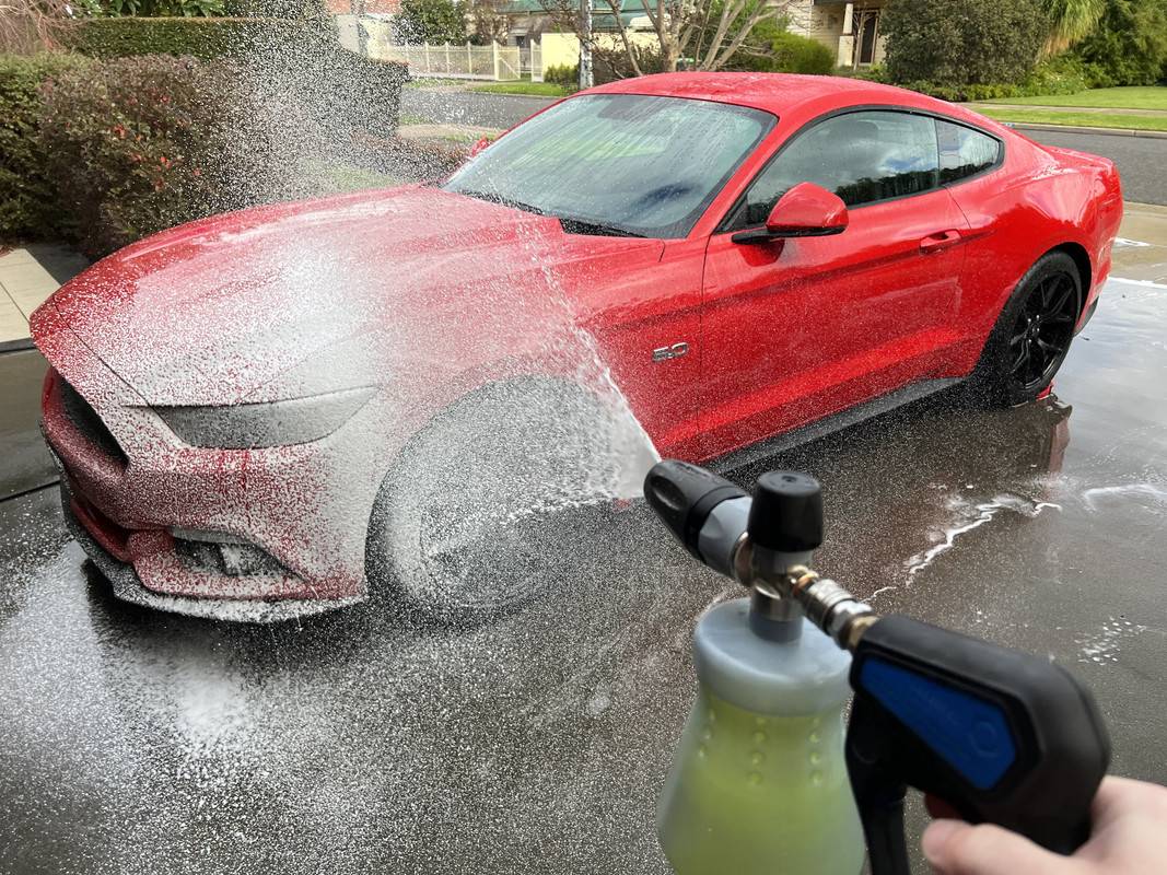

Foam Cannon Filling –
I always fill a foam cannon with water first, then add soap. Doing it the other way around, you end up with the soap foaming up and preventing you from filling all the way with water, in turn altering your dilution ratio. The other option is to put the soap in first, then submerge the bottle in your rinse bucket to fill with water. I much prefer the first method as its quicker and easier.
