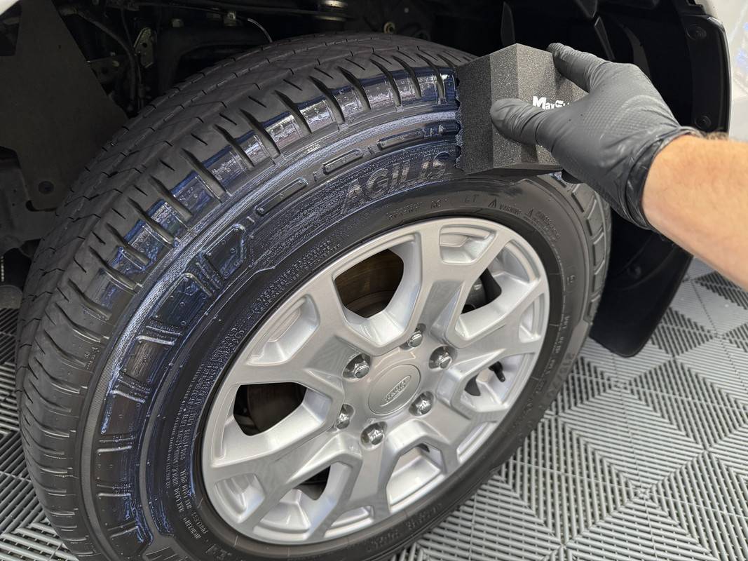

Either Adam's Rubber & Tire Cleaner (ready to use), Shine Supply Wise Guy (needs to be diluted) or Carpro ReTyre (ultra strong), team with the Detail Factory Tire Scrub Brush.

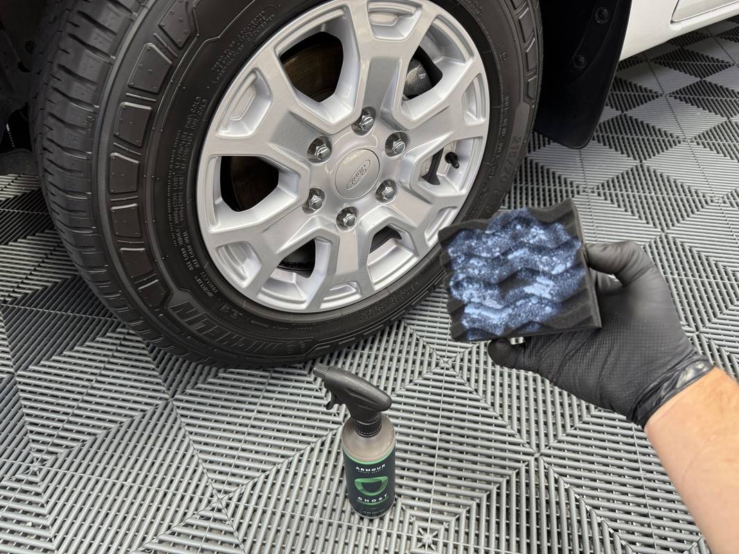

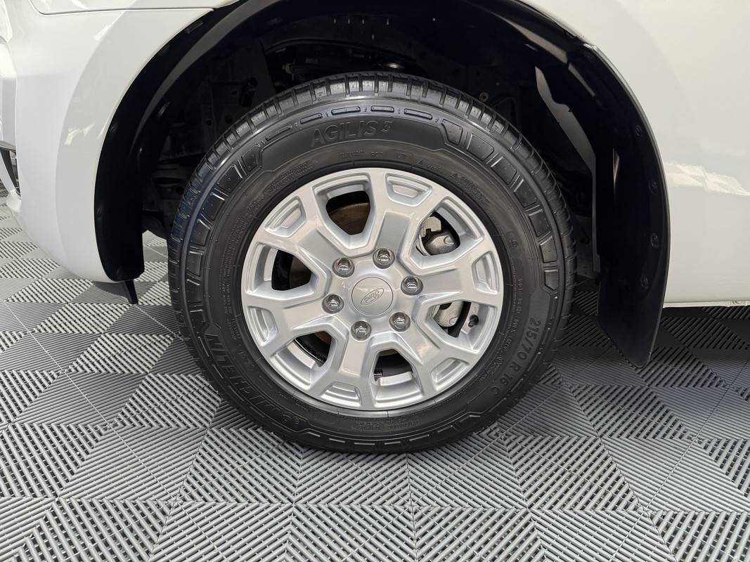

For the tire dressing, I could list countless examples, but I think if longevity and non-sling are desired, the best I have come across would be Armour Detail Supply Ghost. This should last quite a while for you, but importantly, it completely dries and will not sling or accumulate dust and dirt like solvent-based dressings do.

This product has a natural satin look, but if you prefer a glossier finish, apply a second or third coat with 10-minutes between. Absolutely fantastic product!

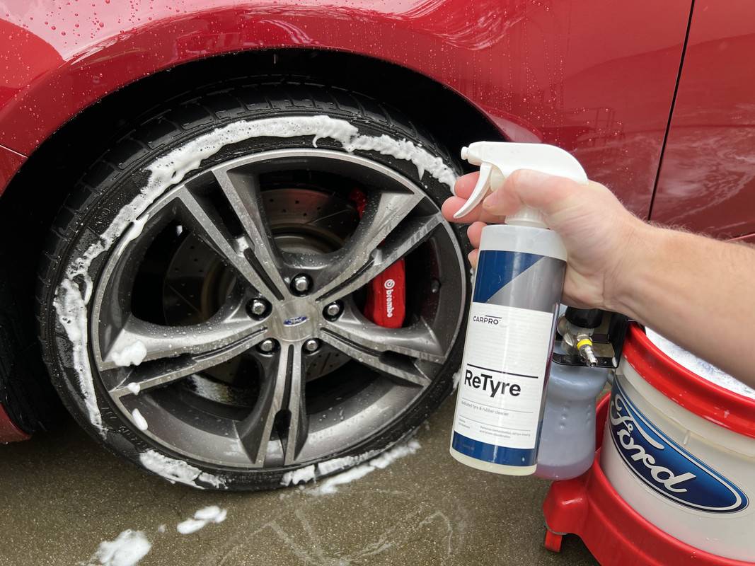

Yeah, be careful with it. It's not going to strip a good ceramic coating, but don't go doing something else while it's on the tires. That said, I've used it on and off over since it was released on coated and non-coated wheels and haven't had a problem.
What I do with ReTyre is to spray it into you brush and not directly onto the tyre as it the foaming spray head can be hard to control. Spraying into the brush helps control where the chemical is going.

This is how it tends to end up on the wheels (and ground) because of the foaming spray head.
