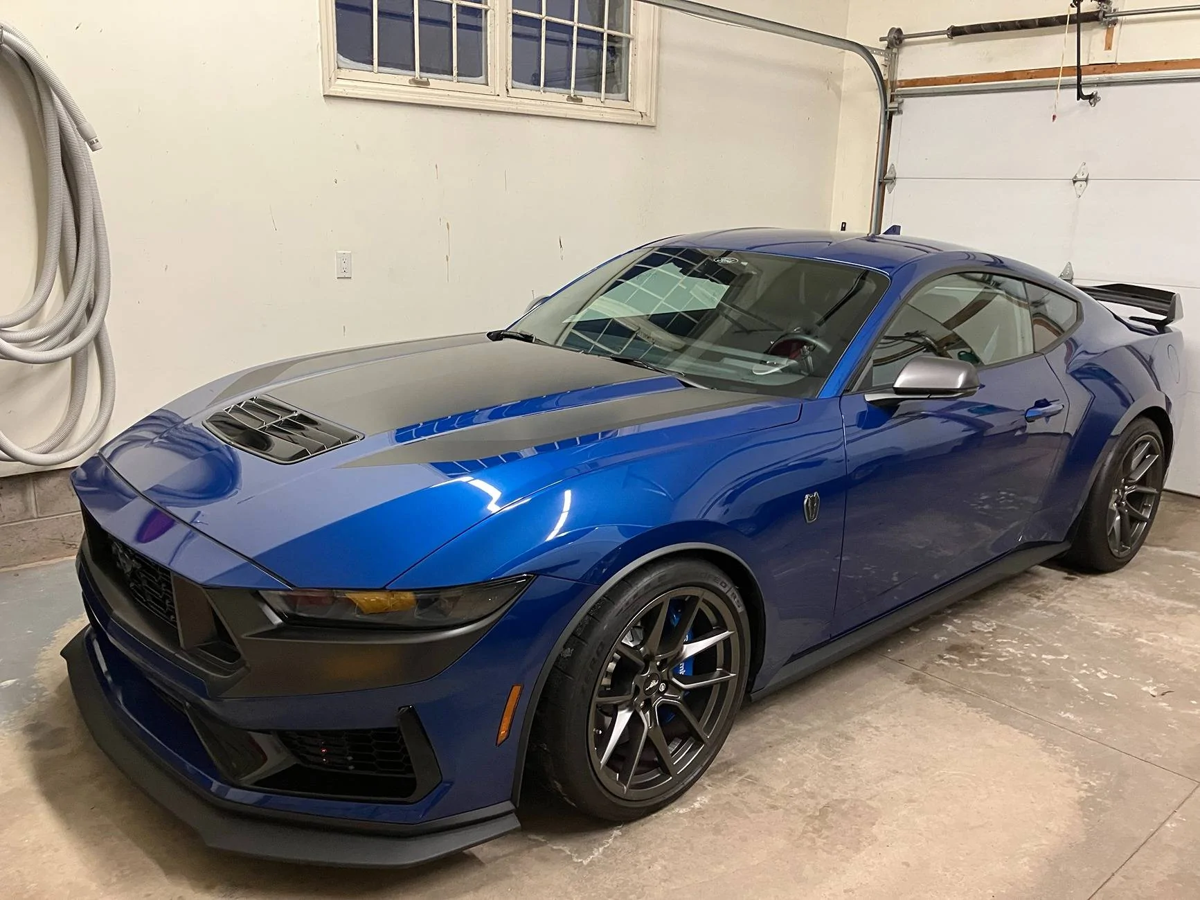

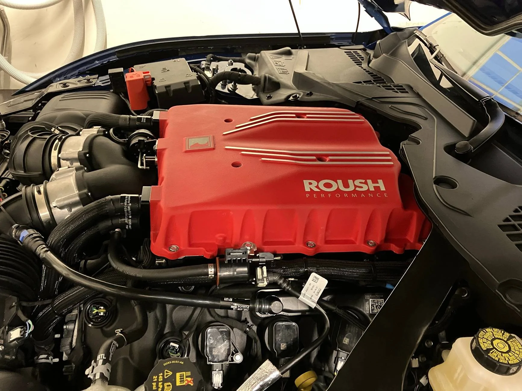

Just got my Dark Horse back from DaSilva Racing in Pickering, Ontario where they installed a Roush Phase 2 supercharger. Dyno results came in at 683 RWHP and 541 RWTQ. No other modifications were done. For those of you who may be in Southern Ontario and looking for a top notch Mustang shop, I cannot rate DaSilva Racing highly enough. The work was done exactly as promised and on time, and my car was picked up and delivered back to me in pristine condition. Looking forward to winter's end so that I can get this bad boy out on the road again. Only has 429 miles on the odometer!

Sweet looking ride! That bad boy needs to get out of the stable.

Seems you should've gotten more horses than that. Something like 740 horses? That SC was my first choice for an SC, but it didn't come with a Ford warranty, not to forget I didn't care for the whine. If I wanted whine I'd stay home with little Wifey😇. But I really wanted this one because it stands out big and bold. I had the Whipple installed when I bought the car. I'm not sure what it would do on a dyno. After a couple thousand miles I'll dyno it.

Having had superchargers before there is usually a 14-16% loss from crankshaft to rear wheels. For 810 hp at the crank that would translate to 680-697 RWHP. I’m quite happy with 683 for an engine that has yet to be broken in.

True. Mines probably about the same. I basically got it to get away from the bad guy. Going to probably have to install a short shift kit. I go through gears like lightning. I think a 3.18 would've mellowed it out. Not available with 6 speed. Have the 3.55. Forgot about those pesky old at the crank HPs.

Same as what the base whipple kit makes...pump gas is the limiting factor on either kit

Ya, I made around 660 hp on my setup, but I'm limited to 91 octane. Have seen multiple cars in my area make around the same with their whipple kit stage 2 as well. Only way to make the numbers that shops and others have been getting is with some E blend, headers, or both. I see you're in california; i am as well, so id say around 660-680 is what you're gonna realistically see on 91 octane unless you have 93 nearby
