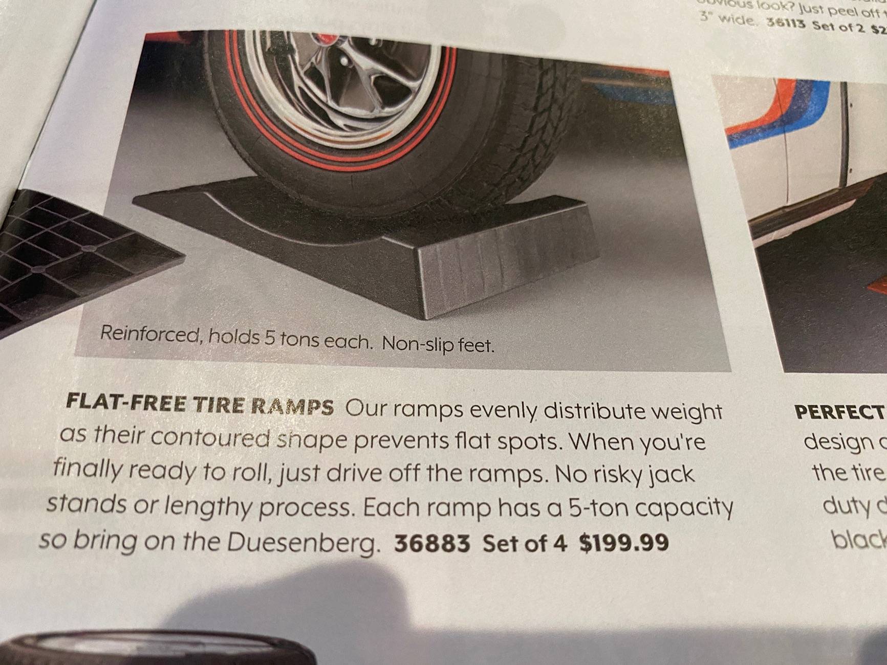

Another way from Griot’s is this:
S650 Mustang Winter Storage options IMG_3075

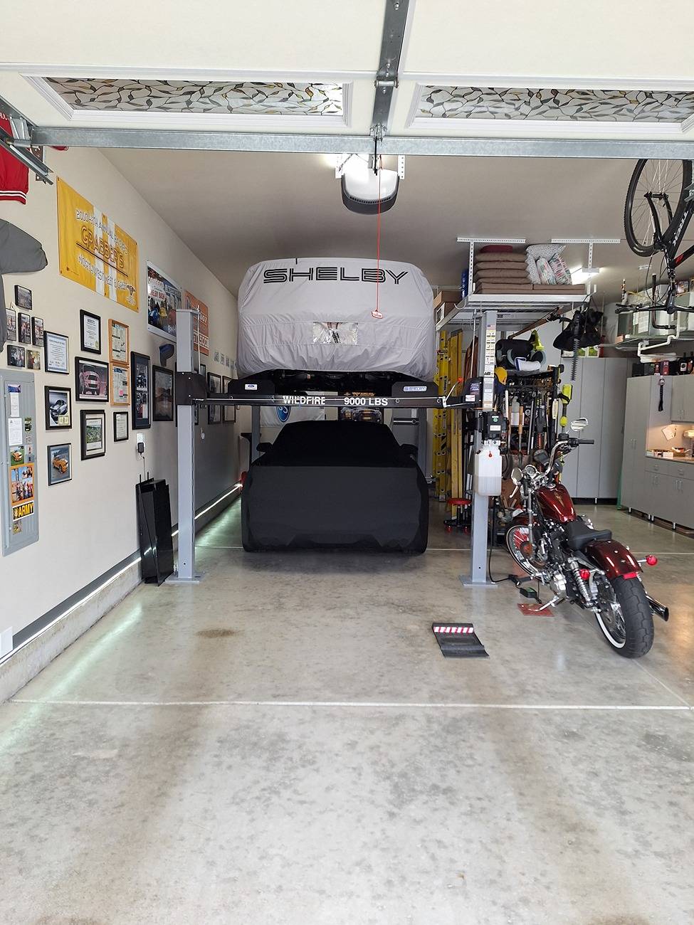

My garage stays about 50 to 60 degrees most of the 4 winter months. I've been storing 2 cars for 4 winter months since 2007 and have always put about 3 extra PSI of air into each tire and I've never had any problems with permanent flat spots. They go away after the first 20 mile drive.
S650 Mustang Winter Storage options 20241112_095036
