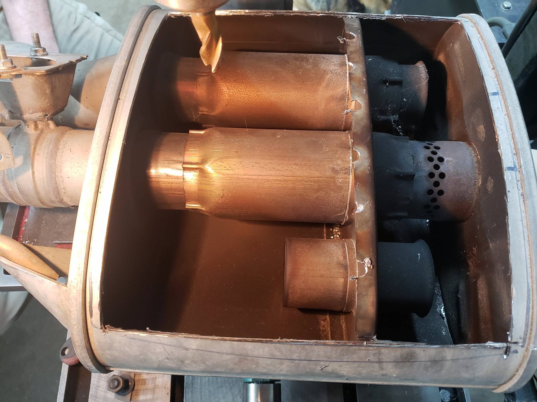

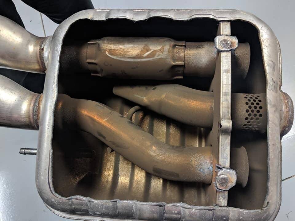

^ This thread is older, but highlights the valves and exhaust. I'm also attaching some photos.
It'd take a lot of effort to end up with something with an undetermined sound. To me, it'd lean heavily towards Track Mode, too loud for most communities and ordinances.
As @agreywolfe mentioned, I'd look at an aftermarket setup, something designed (and tuned) for the car.

To answer the original question directly, the active exhaust will fit a non-active car (with valence mod or replacement), but the management system in the car that manages the valves won’t work (even with wiring harness updates) since the computer is basically locked down. So you’ll need an aftermarket way of managing the valves.
I opted for just axle back (Roush dual black tips) and it sounds great with the stock resonator. I have an X Pipe, but chose not to install it (don’t want the extra noise). If anything I’d get a resonated X pipe, for more HP with not much more noise, but Steeda posted a video where the S650’s don’t make that much more power with an H or X compared to the S550. They did this experiment with an active car, which may have a different resonator (doubtful but I’d still like to see the insides to compare).
Note that the stock resonator isn’t “restrictive” as some claim as It’s basically two straight pipes with multiple chambers. However since there’s no crossover, it doesn’t provide for equalization/scavenging, which can provide more power.
