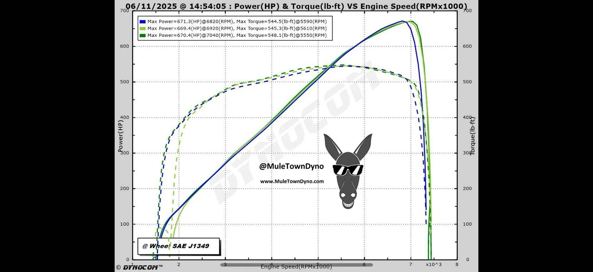

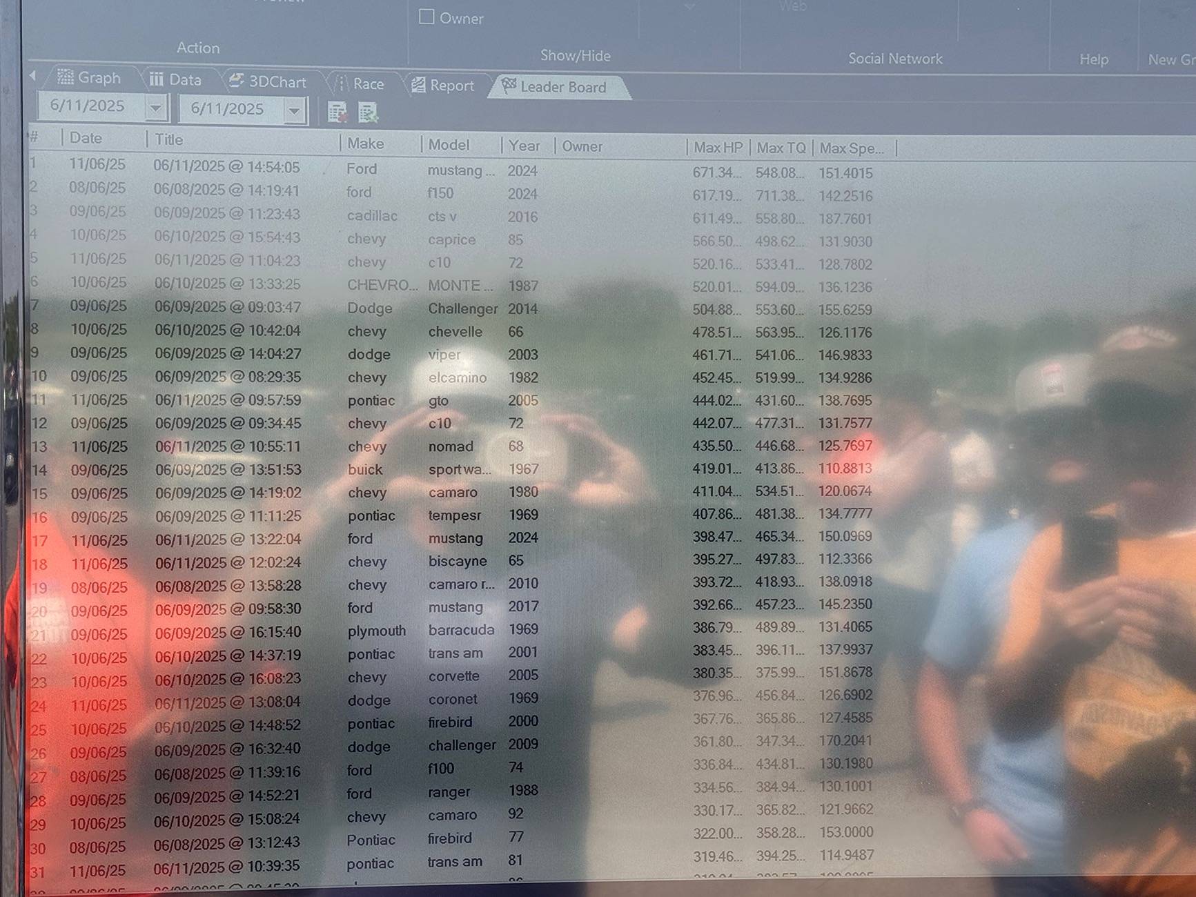

When I bought the SC from Steeda they asked me if I wanted a Ford/Whipple or a Whipple version. The hardware is same except for Ford logos, the Ford/Whipple software has a speed limiter and the Whipple software does not. Wasn’t a big deal to me for real world driving, didn’t consider the Dyno thing until I put car on dyno and couldn’t figure out why it was cutting out at 7k rpm. Didn’t dawn on me until I saw the leaderboard, the dyno sheet doesn’t list wheel speed. Pic of leaderboard is hard to see(full sun) but if you zoom in a bit my cars at the top.
gregrarnold
Dec 22, 2023
48
North Franklin, CT
‘24 Dark Horse Whippled, ‘24 F350 Platinum, ‘84 CJ-7, ‘19 Road Glide,
So the Whipple tune cut it off at that rpm?
To be clear the Whipple tune still revs out 7,400-ish rpm if I remember correctly, don’t think any different than stock. It was the wheel speed in 5th gear that cut the party short but I wasn’t looking at speedo when on the dyno. Never crossed my mind, after 3 pulls I gave up. The tech running dyno was convinced I was chicken footing it but had pedal planted firmly on floor even after it limited out. It wasn’t until I had car back off the dyno and was looking at leaderboard that had the wheel speed data what had actually happened. Figure I got robbed of a few HP on paper anyways.
