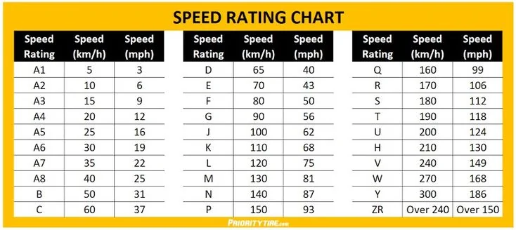

a very good approximation of the limited top speed would be to look at the tire speed rating, the top speed will never exceed what the tires installed from the factory are rated for.

Yeah, that is not helpful in this case. Trofeo RS are Z rated (149 mph +) and rated at 186 mph according to Tiremart.com (no idea whether that is accurate at all). I cannot find anything directly from Pirelli.

If you look at the sticker on the B Pillar when you open the door, it is going to give you the size, placement, load and speed ratings along with inflation
IIRC W rated is 168,
I have seen the number 166 tossed out there for the Dark Horse from a Motor Trend article, so that would jive with the W rating.
