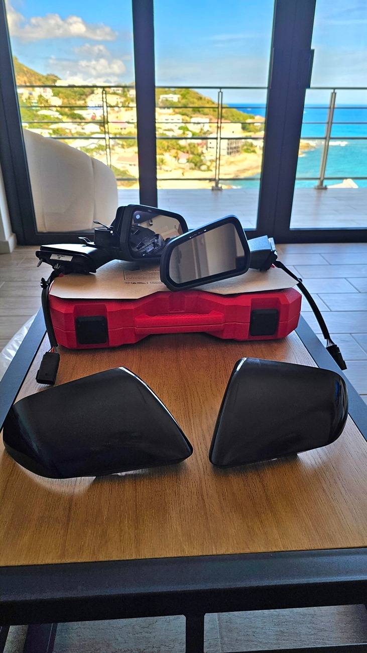

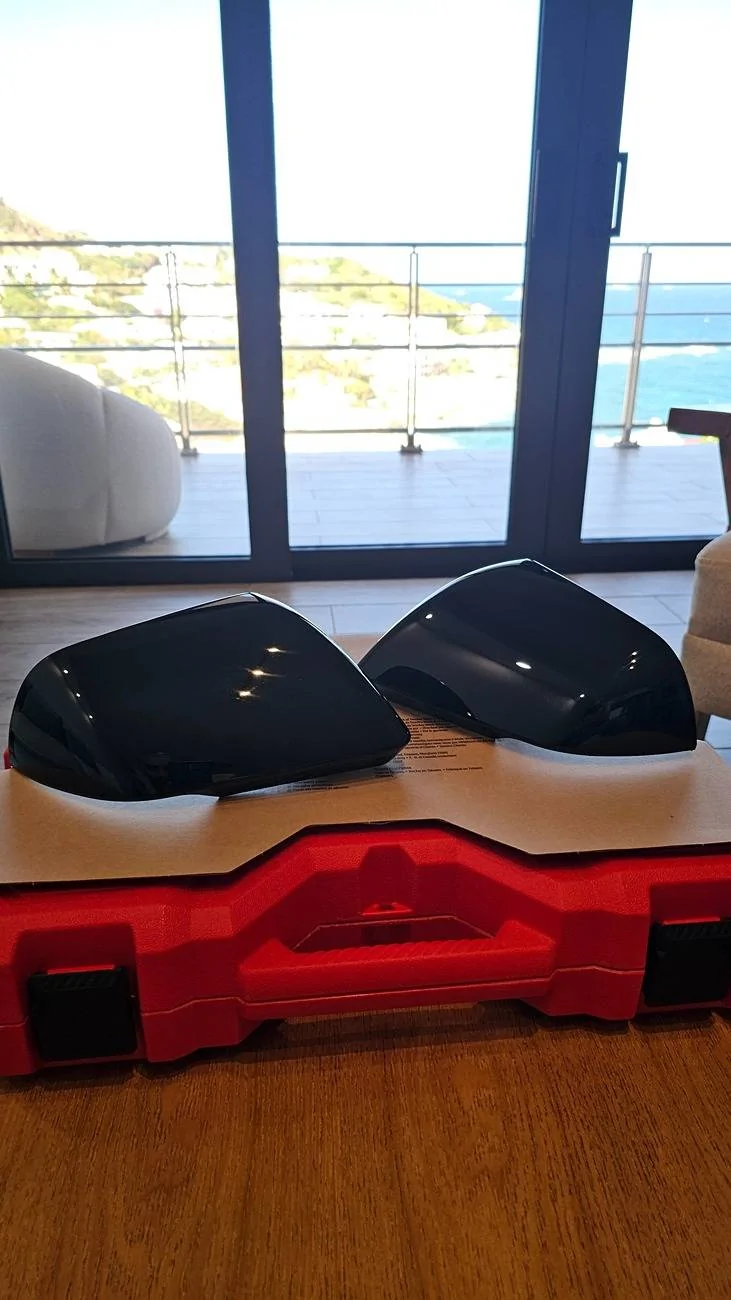

My side mirrors with integrated turn signals arrived and so did the mirror caps.
I brought the mirror caps to the body shop to paint them gloss black. The mirror caps were already gloss black'ish' but that was the primer color.
I placed the mirror cap next to the mirror cap that is installed on my car and you could see and feel the difference. The difference is not that big, but it definitely should be painted.

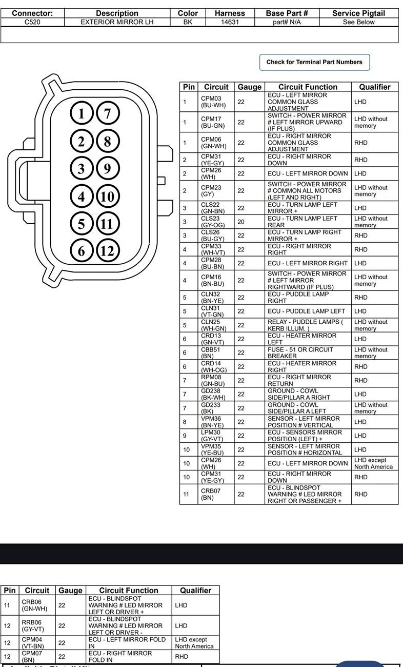

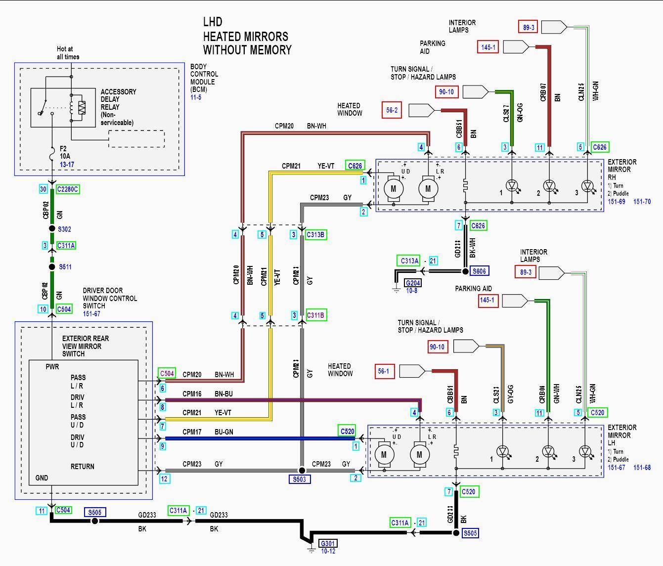

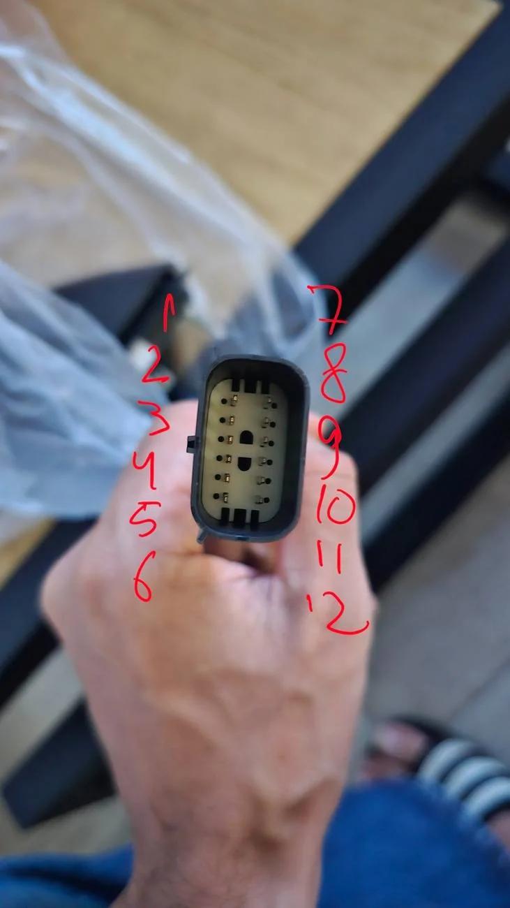

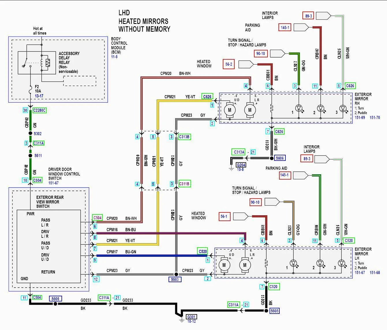

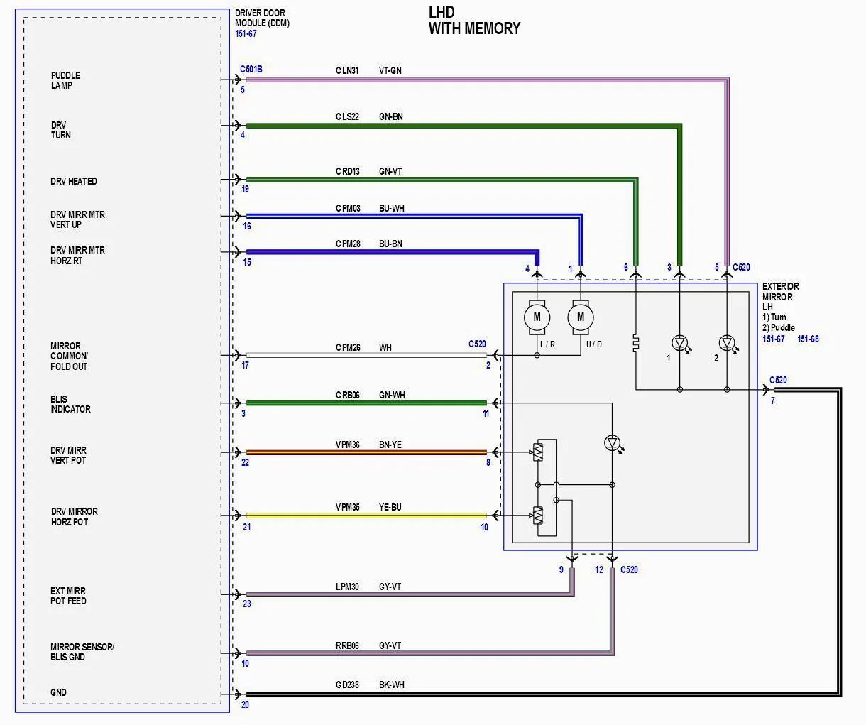

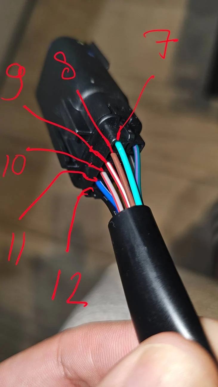

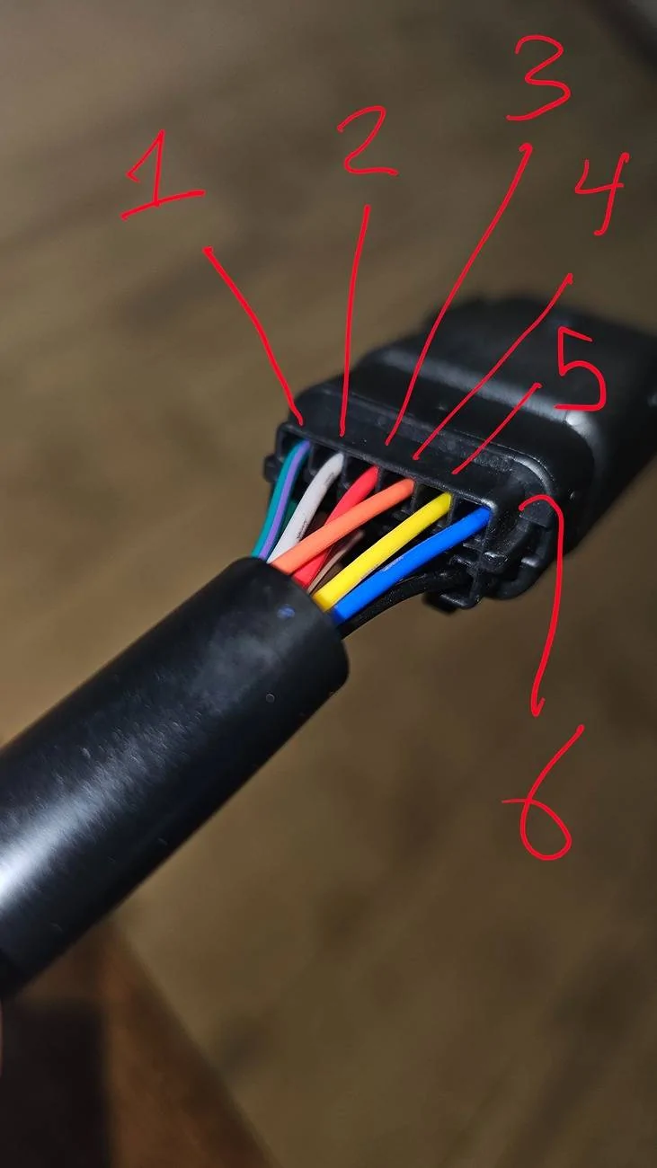

Okay, I thought that I could read the wiring diagram, but I guess I still suck big time, or there is something wrong.
So I received my new side mirrors, and I'm trying to understand what each wire in the cable does.
I'm comparing every wire to the wire that is shown in the diagram.
But it seems that almost nothing corresponds.
The wire colors are all mixed up and located in different pins.
So I have a wire diagram of the car with memory and the wire diagram without memory, but both diagrams look way different than the wires I have in my new side mirrors with integrated turn signals.
I gave every wire a number so that you guys can solve this mystery.
Some people said that the wire for the turn signal must be in PIN 3. Well, my turn signal wire looks like in PIN 1. How is that possible?
HELP
PS: The right and left side mirror have exact the same wires and colors in the same connector.

Edit: Even though all these wires doesn't make sense to me, I searched for other side mirrors and they all have the same layout. So it should be fine. The only frustrating thing is that I can't understand the wiring, colors and the pins that don't match with the information that I have.
I still find this a very interesting topic since I'm probably the first one who is doing this conversion and there is literally nothing known about it yet. I'm braking my head about this for weeks/months and I'm almost getting closer to the solution. Now that I have the mirrors at home, I can't wait to test them out. But I have to wait until the 31st of this month before a mechanic can look at it. Until then I'm trying to gather as many information as I can to help myself calm down LOL.
What I really find interesting is that the door harness that I have (PR3Z14631KA), is the door harness that's on all Premium non-401A Mustangs. All these cars don't have turn signals in the side mirror. But for some reason, almost all Ford OEM part stores say in the details that this door harness supports turn signals. That's very very interesting and that gives me hope that there is still a chance that the turn signals are plug and play. But since Ford did not put the turn signals on my Mustang while the door harness supports it and since I have the 401A package but not the 401A door harness, I also give it a high chance that the mirrors are not plug and play. And since I don't have a DDM and PDM, the chance to have it plug and play is a bit lower than the chance that it will not be plug and play.
ChatGPT says without DDM and PDM, the side mirrors are not plug and play.
But ChatGPT doesnt know much about this carI noticed.
So my guess is:
- Plug and play 25%
- Add extra wires 75%

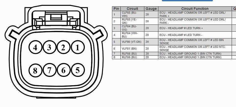

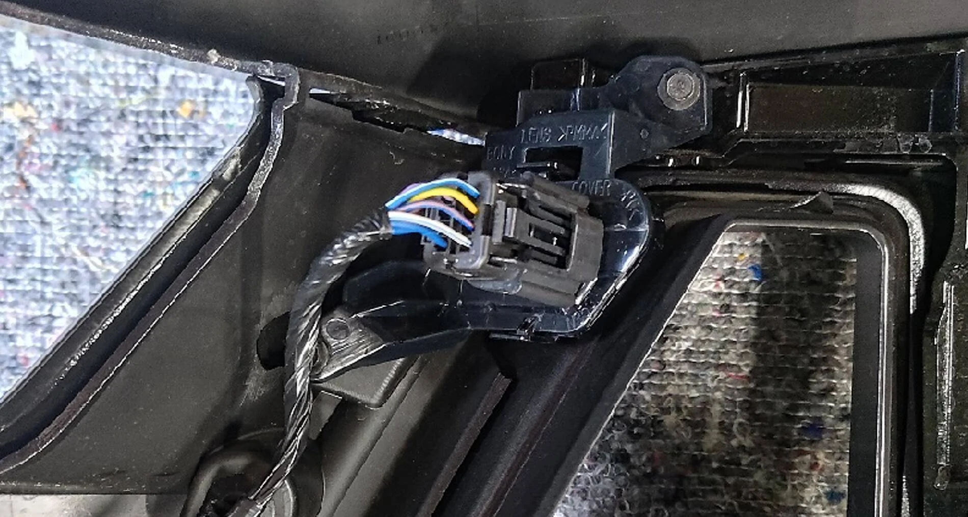

Great news! Since it's not the 31st of March yet, I still have time to do more research before bringing the car to an electrician who is going to try and make my turn signal work.
At this moment I'm gathering all possible diagrams so I can hand it over to the technician.
Last week the Mustang wizard aka Roket, gave me the advice to tap the turn signal wire from the corner lights in the grill and he gave me the wiring diagram of that connector.
Today I received a real life picture of the connector from a European Mustang owner who had to do some headlight modifications to get it pass the inspection.
This means there is a chance that I don't have to remove my front bumper to get to this connectos. I'm not 100% sure. I'm still searching on Youtube for a video that somebody is removing the radiator cover to see how much room I have and if it is possible to get to the connector from there.
The corner light in the grill seems very close to the radiator cover, so there might be a chance to work from there. I really hope so cause I don't want to remove my bumper.
If anybody has a picture of a video of the room behind the radiator cover, much appreciated.
Edit: If I read the diagram correctly, the yellow cable is the + Turn signal and the Blue-White cable is the - Turn signal.
Does this mean I need to add 2 wires to the turn signals?

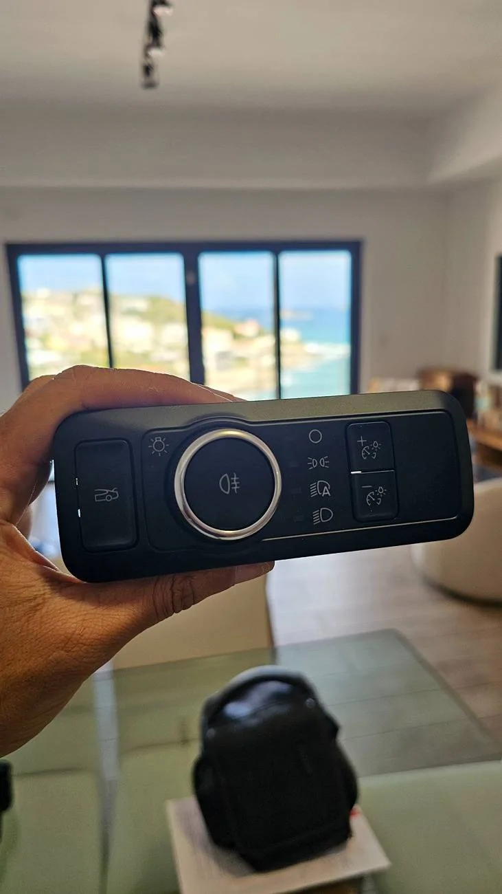

My rear fog light switch finally arrived.
That means I can make my car Europe proof.
I already started with the side mirrors which I'm going to update later when I'm finished.
Side mirrors are plug and play but I had a hard time releasing 1 connector.
I will change the other side mirror this weekend when I have time.
When my side mirrors are done, I'm going straight to this conversion. I have to remove the reverse light and the light switch and replace them with the European models and change some codes in Forscan.
