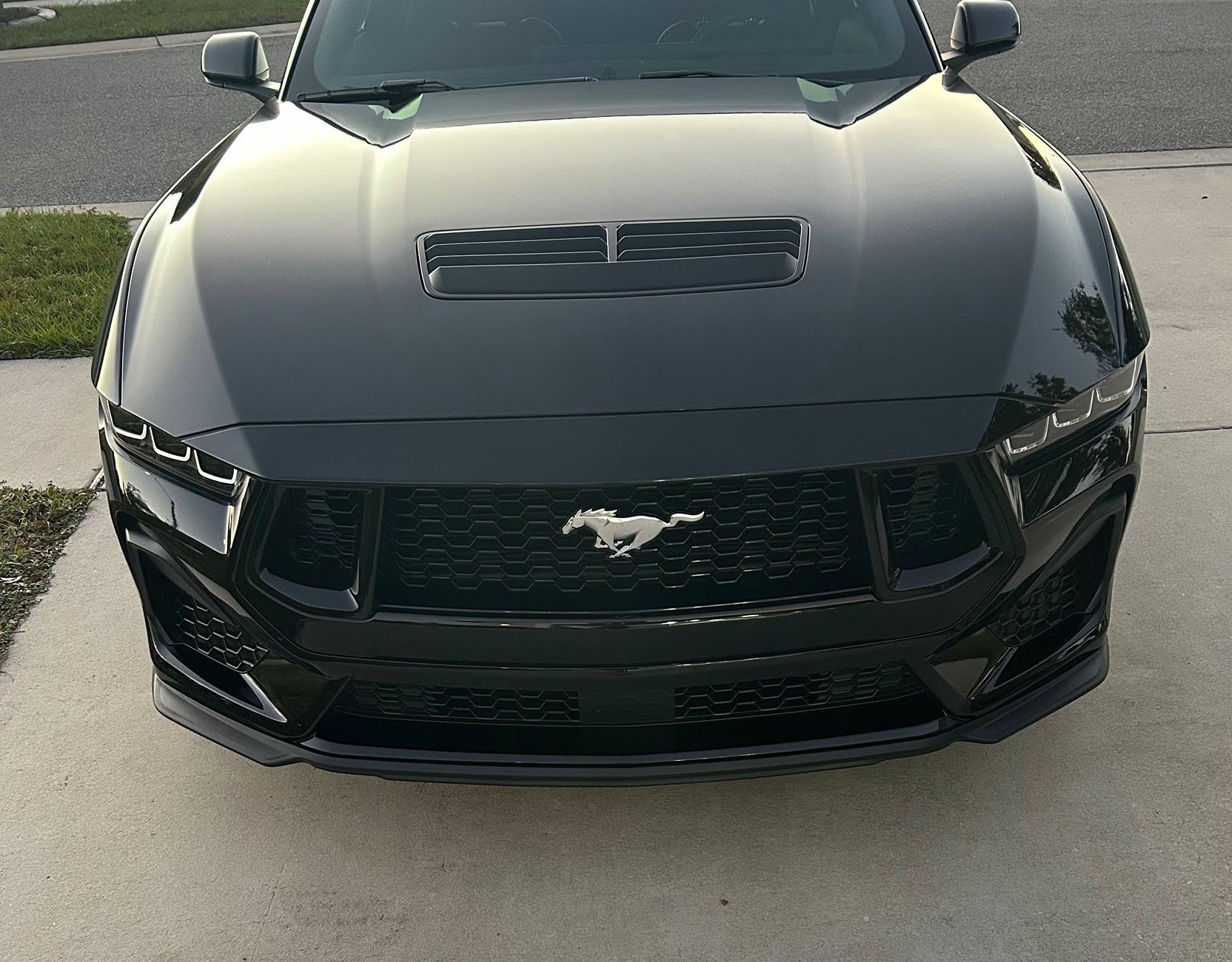

Halfway through the swap. Very easy. 18 screws, 4 plastic rivets, and 6 more plastic rivets for access.
Just enough of a difference!

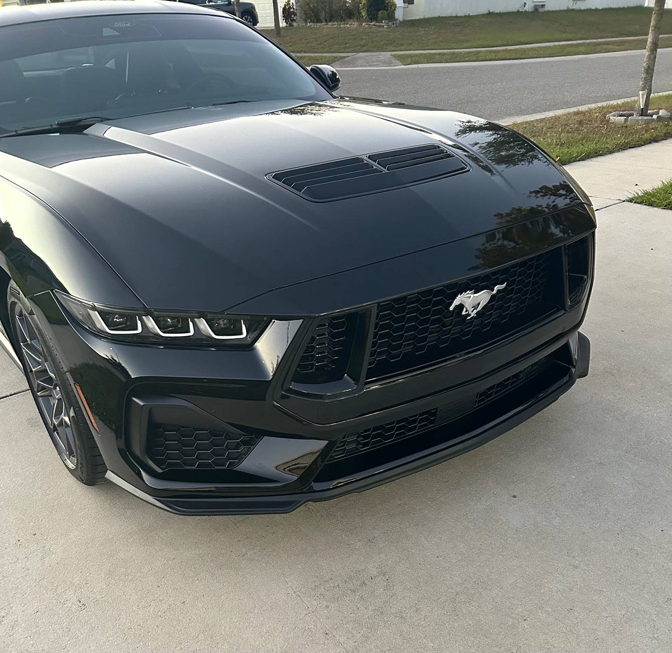

And final product. Fit perfectly, just like it was made for the car, or something! 😁

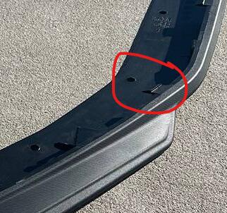

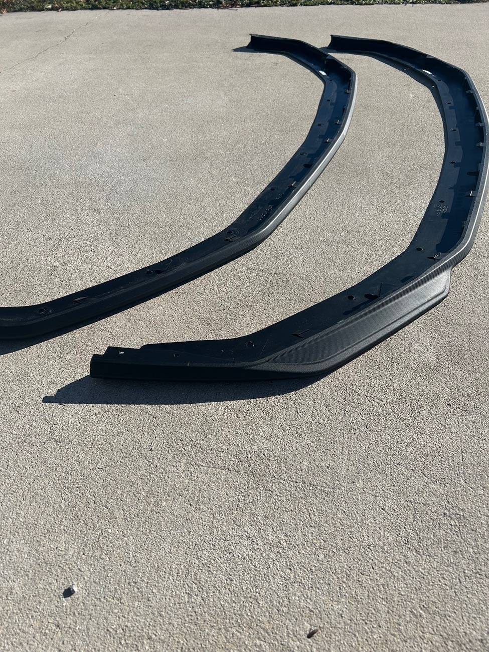

did you need to get a PP belly pan to make it fit?
Nope! The PP one literally replaces the non-PP one. Same mounting holes, same tabs, same slots, same mounting hardware.
After you take off the screws going along the bottom (12), you have to push up on the belly pan to access six more screws. The two plastic pins on each side are behind the wheel wells (three plastic rivets to remove on each side for access).
After that, there are several tabs still holding it in place (see pic below). At first, I was trying to push them down from inside so they'd pop out, but that's not necessary... just gently pulling on the splitter (starting from the ends) releases them.
Then you just push the new splitter into place and the tabs hold it as you tighten down the screws. There are alignment pins on the splitter that hold it exactly where it needs to go.

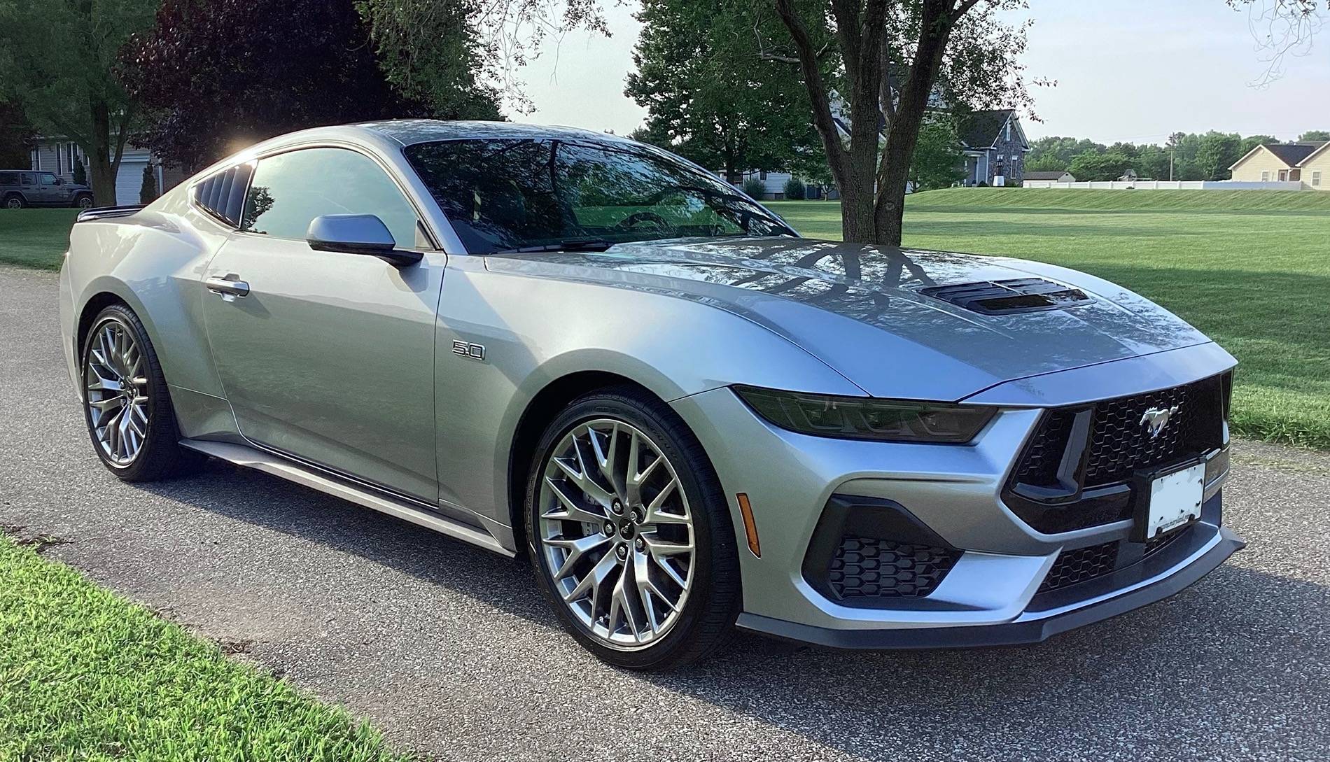

Just did this mod today, highly recommend if you want a tiny bit more aggressive but still a simple look to the front end. A lot of aftermarket lips were too busy, too big, or didn't match the modern "low-poly" boxy/sharp car styling trend used by the S650 (see Hyundai, BMW, Toyota, etc. all getting boxier with simpler low-poly shapes).
During the removal, use a trim removal tool on the 4 interior plastic push-pins (2 on each side) inside the corners of the OEM lip. Various install vids said those are really hard, but with a trim removal tool it's a few seconds each.
The hardest part is actually trying to fit those push-pins back in. I couldn't get them to cooperate so I only put in the base of 1 push-pin on each side. I think aftermarket companies realized this issue too, i.e. MP Concepts Chin Spoiler supplies their own hardware for those holes instead of reusing the push-pins.
