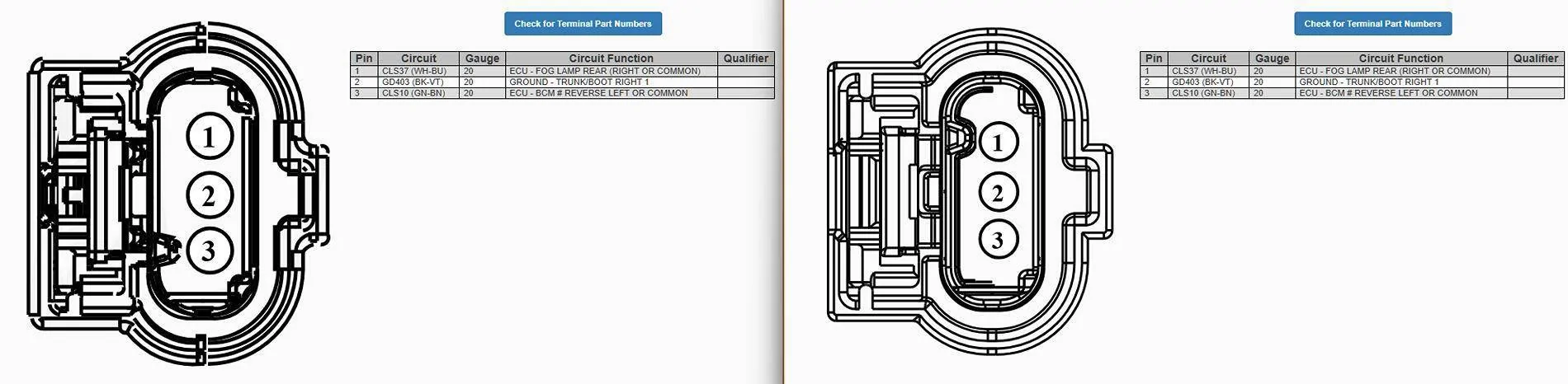

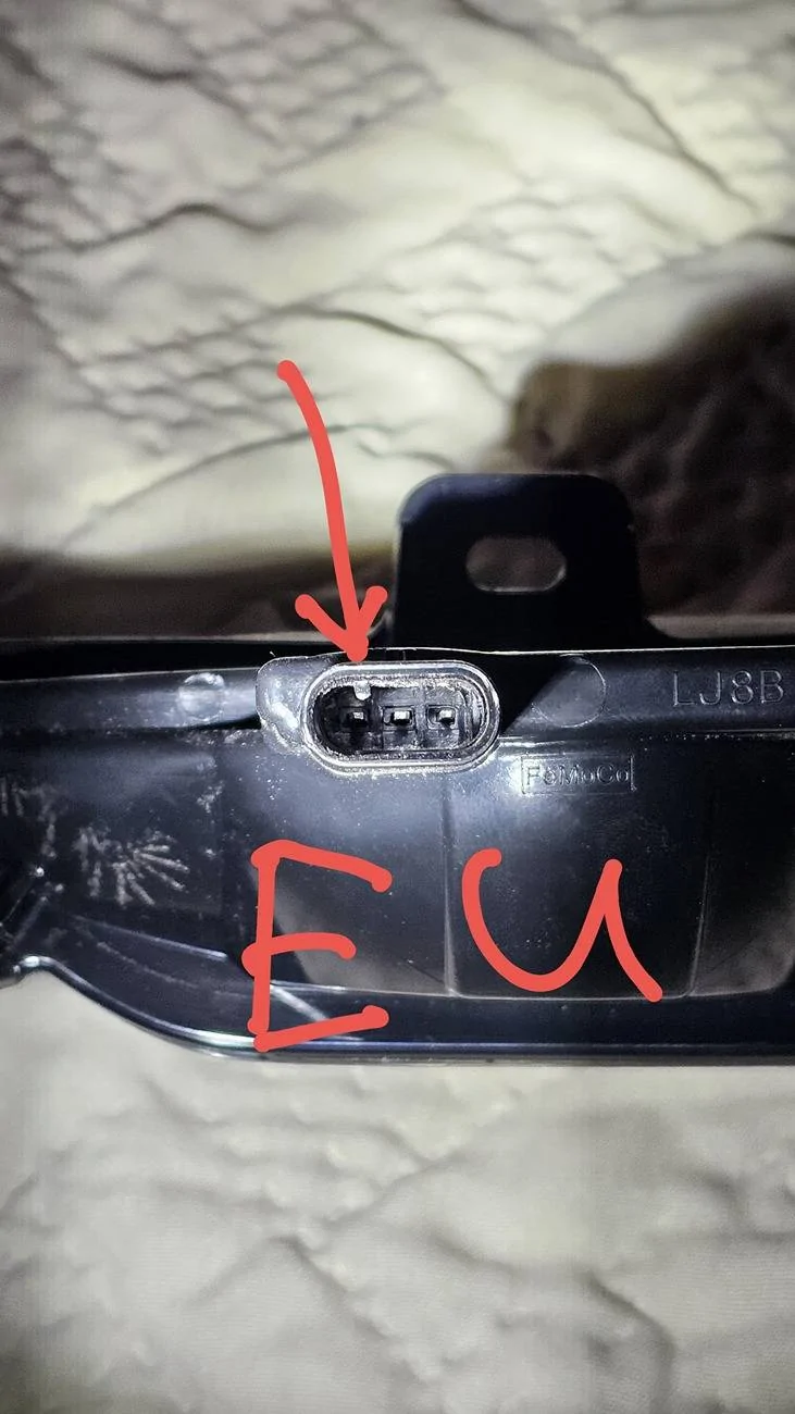

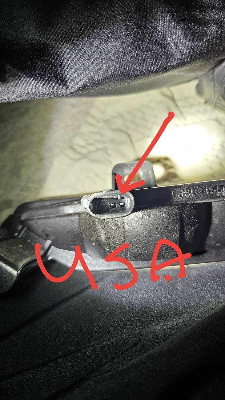

I tried to install the rear fog light but it is not plug and play as they said.
I found out that the connector on the USA part has a metal pin on the right and the EU version has a metal pin on the left.
If the metal pin is not there, it is plug and play.
Ford only did this so that during the assembly they will not place the wrong part on the car.
So now I have to find out how to remove that metal pin and place it on the other side to make it plug and play.
Anyone knows how that works?

Update: I removed the "metal" tab inside the socket. It turned out to be plastic, so it was easy to brake it with a pick. Now it should be plug and play. I'm going back to the car.

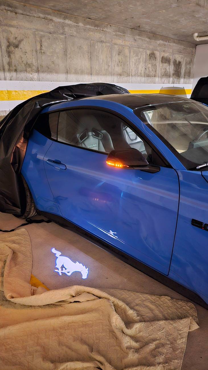

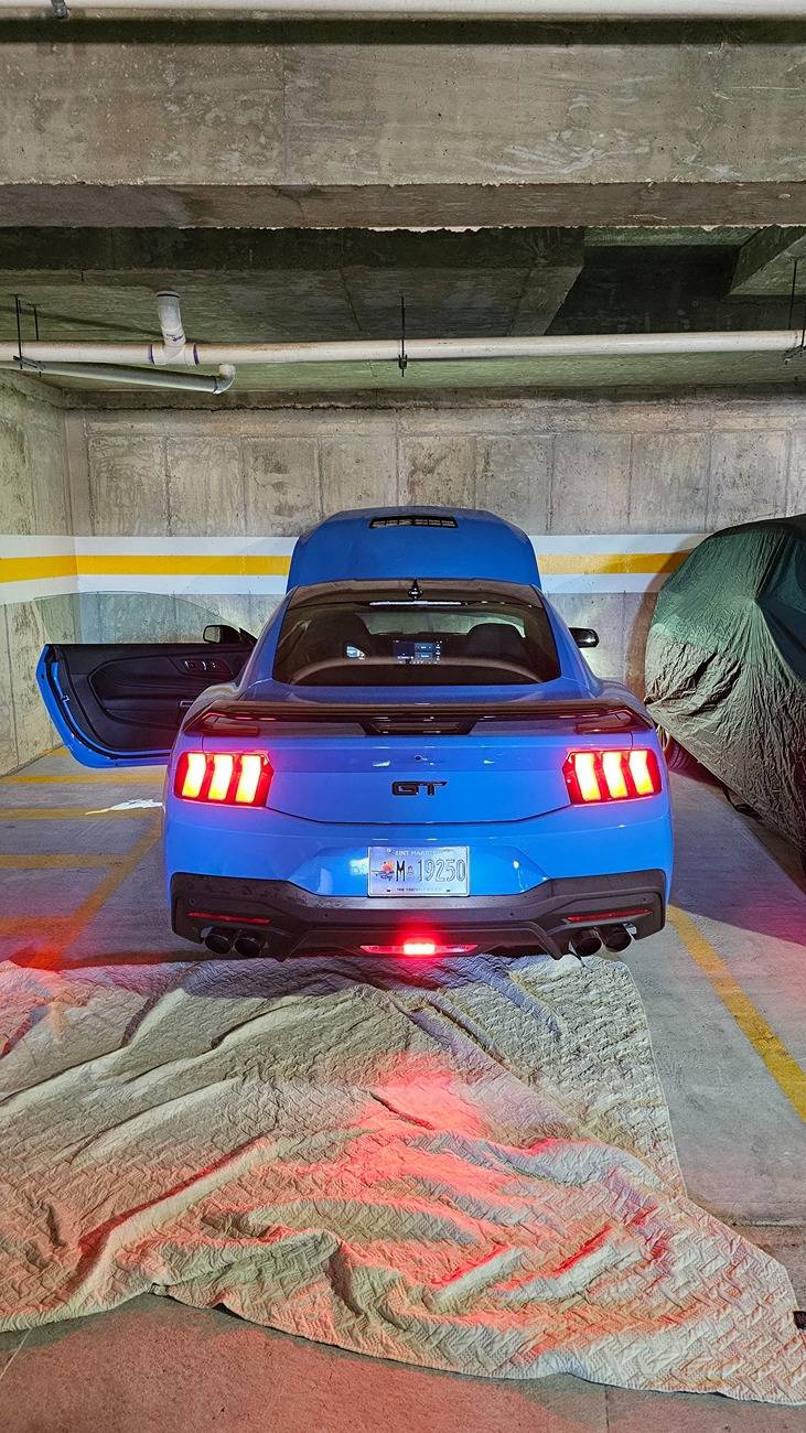

FINALLY!!
The first US to EU conversion on the internet!
I filmed the whole process and will upload it to my Youtube channel.
Side mirrors with turn signals INSTALLED! ✅️
Rear fog light INSTALLED ✅️
- Side mirrors were plug and play. This was the biggest surprise because no one on the internet has ever done this conversion so I didn't know what to expect.
- Rear fog light I was told it was plug and play but that was not very true. The EU socket on the rear fog light was different than the USA socket, so I had to do a minor change to make it work.
Also I had to change some Forscan lines to make the fog light work. I'm super happy that the fog light yellow logo lights up on the dash when enabled.
My car is now 100% Europe proof and I can ship it to Europe and get it pass the inspection and have it registered without paying thousands of Dollars to garages that all told me that they had to add wires and all other lies just to charge more working hours.

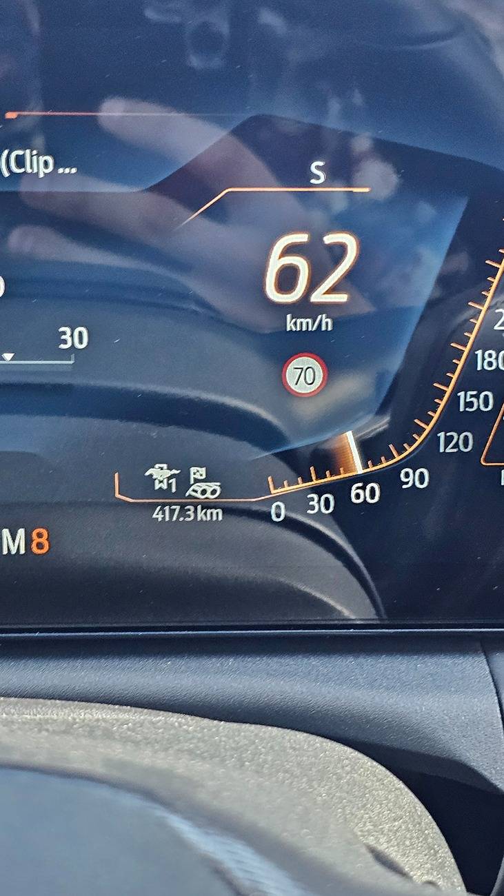

Tomorrow I'm going to change the TSR (Traffic Sign Recognition).
I have the North America TSR and it doesn't work with the European traffic signs.
I will share the Forscan lines when everything is working.

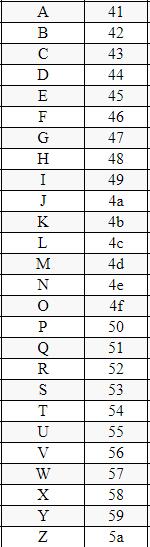

Also I was searching for a way to find out all the country codes, for people who want to change their vehicle to their own country. This can be handy if your language is not available in the language settings. It was a pain in the ass to find what my county code is (The Netherlands) since I have a Canadian Mustang. The only thing I knew was that the country code of:
Canada is 4341
United States 5553
Then I found a very handy tool for people who want to find out what your country code is.
See the picture below to find out what your country code is.
I haven't verified this table, but:
Canada is CA, so the letter C and A makes 4341
United States is US, so the letter U and S makes 5553
This means my country code, The Netherlands is 4E4C
The only strange thing is that there is a forum member @GK292 from Austria (AT), and he said his country code is 4155. But if I use Austria following the table, it should be AT = 4154
The country that has 4155 as a country code is Australia since Australia is AU.
So is this table not correct or did he confuses Austria with Australia?
I hope you can clarify this mystery GK292.
If it was a mistake, then this table is correct and this is how you guys can find out what your country code is. I will test this out in a couple of days after I did all my other Forescan changes with no issues.

1. Changed my welcome and leaving headlights animation to the Dark Horse style. I REALLY love this setting. The LED's look brighter and they have a light purple color when doing the animation. This is SO GOOD!!
2. Disables the double honk when exiting your car while engine is still running. (This feature is SUPER annoying). You really think the double honk will help when the V8 engine is even louder? 🤣🤣
3. Changed my country region from Canada to The Netherlands and changed the English language to Dutch. While doing this setting now I have tons of languages to choose from, while the Canadian setting only gave me French, English and Spanish.
4. Changed the Traffic Sign Recognition from North America to Europe. Now my car recognizes the European red circle traffic signs.

Hi, this Country Code was an error….I still have to check my country codes. Thanks for posting the list.
How did you get the traffic sign recognition to work?
Also is your DAB radio working now?
I am also still looking for the navigation, how to get it to work in Europe.
GrabThatBlue
GrabThatBlue
Jan 13, 2025
2,423
2,648
Between Canada and Europe
@GK292
I can't quote your post, because you messed up the quote in your post haha.
The country code of Austria is 4155. I'm pretty sure about that, because the VIN you gave Rugedraw of another Austrian vehicle had 4155 too. Are you sure you changed the country code in all 4 modules? It only works if you change all 4 modules.
I changed TSR values in IPC, IPMA and APIM to the European values and now it's set to European traffic signs. Can you give me your AS built data so I can look at your country settings and TSR values?
And about DAB+ I'm not sure because I'm not in Europe yet. I'm still in the area wehere I have Sirius satellite radio. Can only check that when I move back to Europe.
