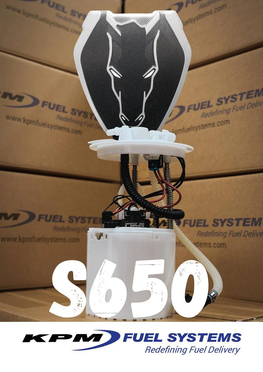

What are the benefits and advantages of upgrading to KPM Fuel Systems.
https://kpmfuelsystems.com/
  • World-leading 1500-2700 hp capacity: Direct replacement for OEM module.
  • Efficient and reliable: Maintains performance in both racing and daily driving.
  • Easy installation: Direct replacement with plug-and-play wiring and quick connect fittings.
  • PWM Fuel Module Controller: Electronically controls the amount of current supplied to the fuel pumps.
  • High-flow design: Features two to four high-performance fuel pumps.
  • Surge-free operation: World leading venturi systems ensure consistent fuel delivery.
  • Fuel compatible: Works with gasoline, ethanol, and methanol.
  • Optimizes power: Delivers cool, dense fuel for maximum performance.
  • Upgrade as you increase power: Modular Systems designed to upgrade as you need.
    S650 Mustang Upgraded Fuel Systems by KPM for your Supercharged Mustang mustang

The KPM Fuel Systems have been developed specifically for the S650 Mustangs to support the extra power if/when the tuning becomes available.
They can run the vehicle perfectly at un-tuned standard power and if/when the tuning is available at any increase in power from standard and up to 2700HP capabilty.
We have 3 level KPM Fuel Systems ready and availble-
KPM1500
KPM2200
KPM2700
