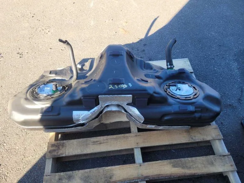

So how does this help with the issue?
I thought the fuel starvation occurred because of the shape of the tank, and the fuel pump being on only one side?
S650 Mustang Ford Performance Racing School / KPM800 Fuel system 1754762465511-n7
Here is the shape of the S650 fuel tank (sorry if that was your totaled car). As you can see, there is a steep "hump" in the middle. In high G force corners, the fuel when, say, half full, may end up all on one side of the tank, away from the pump.
Now, I know some solutions use two fuel pumps, but this looks like just one high volume pump supporting up to 800 horsepower?
What am I missing that makes this deliver fuel when coming out of a 1.2 G sustained turn and then getting gently up to full throttle again, but all the fuel is over on the side where the new KPM 800HP fuel pump is not?
This looks like a relatively inexpensive solution, but I would like to know how/why it works?
So there is some sort of line running from the non-fuel pump side to the fuel pump side.
KPM advertises a full "canister" at all times. Maybe that is enough fuel to keep the engine from starving during sustained high G force turns? Or maybe they improved the suction to pull fuel to the point that it keeps up with the exiting of fuel through the pump and out to the engine? The second part seems highly unlikely, but I would love to hear more about it, how it works, basics, what they changed, and the result, what it will and won't do. Maybe it simply increased the amount of fuel in the canister to the extent that on most race tracks this is no longer an issue?
If anybody knows, please chime in.
This type of fuel pump I believe actually holds some fuel in there "at the ready" like a holding tank. Anytime fuel passes by, it fills the holding tank. The fuel is actually pumped from the holding tank.
