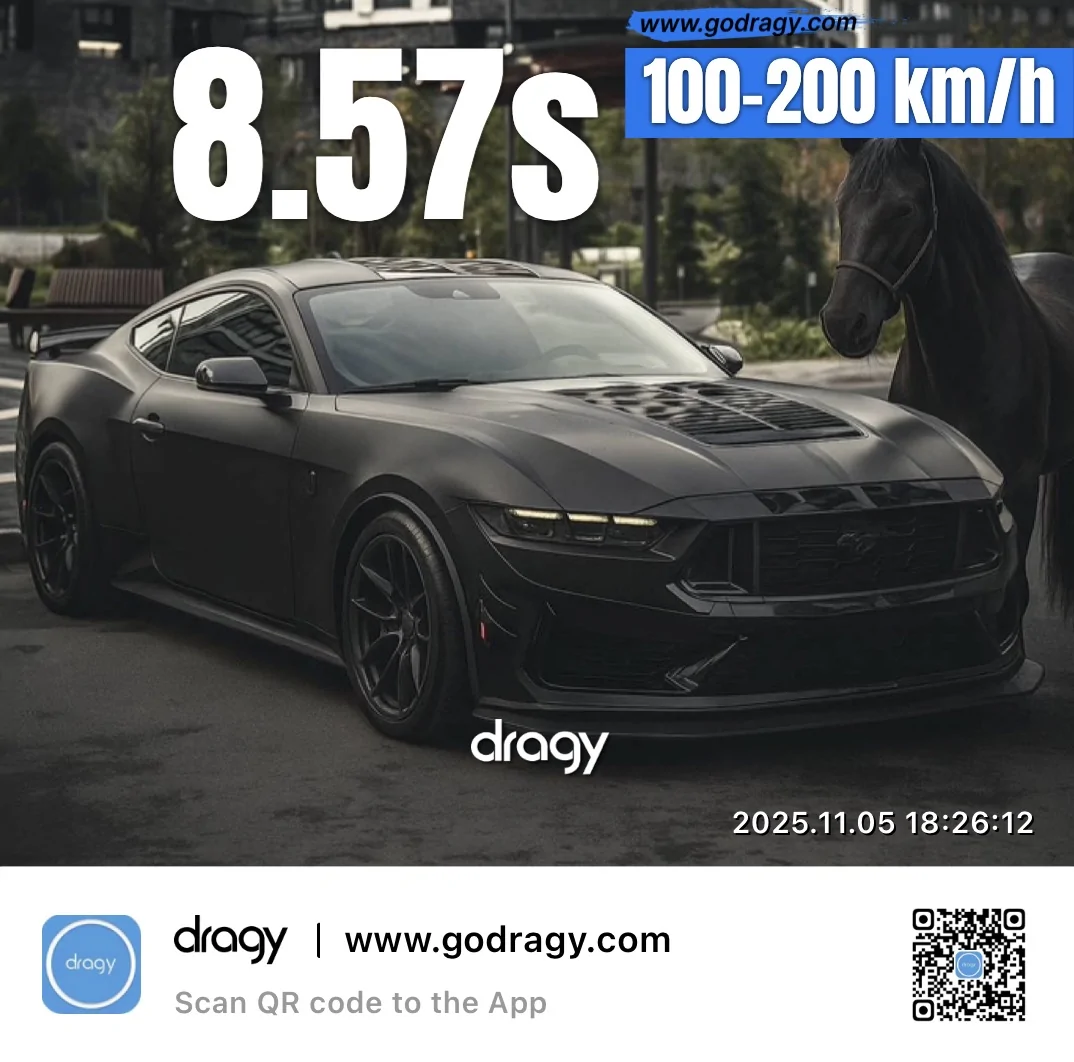

We make 100-200 km/h, not 60-130 miles/h
in stock weight and tune I have 10.1sec acceleration 100-200km/h
Shoemaker tune on 93 and 32* timing 8.5 sec acceleration 100-200 km/h
shoemaker tune in e85 and same 32* timing same 8.5 sec acceleration 100-200hm/h
before I had his tune e85 with timing up to 45* and car was slower then with 32*
I thought that on e85 I will gain 20-30whp and 0.5 sec acceleration on 100-200km/h and will be 8.0 for example (not 8.5)
so my question is - kindly let know how to raise HP and acceleration with e85, as now it has same numbers
also, as per my opinion, best result of acceleration I got on 93 octane tune with e15 (10 liters of ethanol added to the tank)

OK, so the tune netted you a very significant 1.6 second reduction in 100 kilometers per hour (kph) to 200 kph acceleration, but using E85 did not reduce the time any further.
Interesting.
I do not know where you are located, but it is November, it it may be that E85 is only going to provide you a difference in warmer weather, when 93 octane will require a reduction in timing.
You drove long enough for the computer to adjust to the new fuel (I do not know what Shoemaker recommends, but the change is not instantaneous)?

Thank You for clarifications, Sir, as here we don’t have a lot of proper information
yes, I heard that e85 has difference with 93 in hot weather,
This Dark Horse is in Moscow (temperature 40F), I mentioned USA, as tuners are from USA (Dark Horse - Shoemaker and Mach1 900whp - Lund)
I installed tune via VCM beta and made KAM reset and in 5 mins made 100-200 runs
1. so as far as I understand, N/A s650 + Steeda CAI + LTH with cats and resonator delete = 485whp is good result?
2. and acceleration time is the weight reduction question only?
