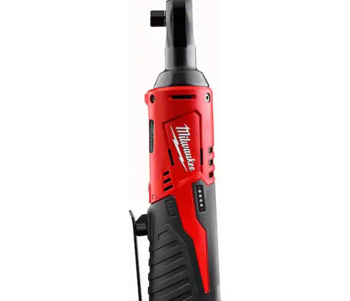

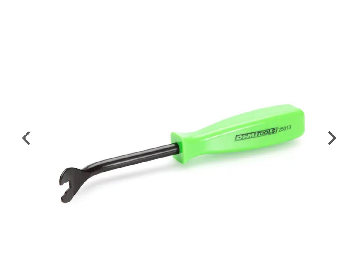

Get yourself tools like the below if you don’t already have them. Makes it much easier and faster. 2 min job to remove and replace that panel.

Yep already on it, I only had a 1/4 socket wrench when I found out about it after my car was jacked up. I should have put it back down and went to store, live and learn
