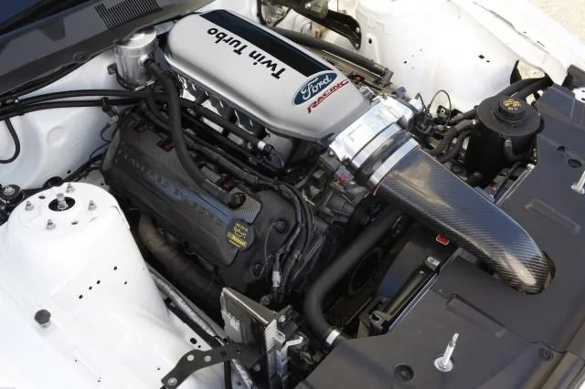

With the update to the exhaust manifolds which removes the cat as part of the manifold, this provides Ford (and us) the ability to twin turbo this engine without replacing the exhaust manifolds. What are the odds they did this, along with the dual intake, with the plan to produce a Twin Turbo version of the S650?
