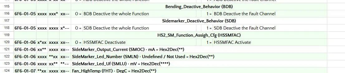

Moving through the Forscan spreadsheets... I found this. I think you have to program it on both LDCMA and LDCMB. I have no idea if this setting is specific to the headlights, or just the side markers, but maybe worth a shot.
I tried those a few months ago. Didn't work for me.
